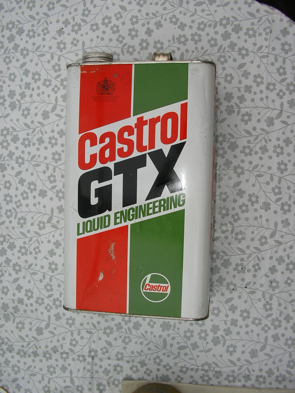

The original 1970s GTX was actually formulatd to 15W50 but never said this on the side of the cans. This was one reason that the late John Hudson favoured it as an all-year round lubricant. It could be used in the forks, gearbox, primary and engine.
By the turn of the Century GTX 15W/50 had evolved into 15W/40 and later 20W/40 versions with bucket loads of additives. So no good for bedding-in new engines or adding to the primary cases.
Looking on the modern auction sites and people are asking fortunes for empty, original GTX cans. I wonder what an empty Duckhams tin of 20W/50 is worth now?

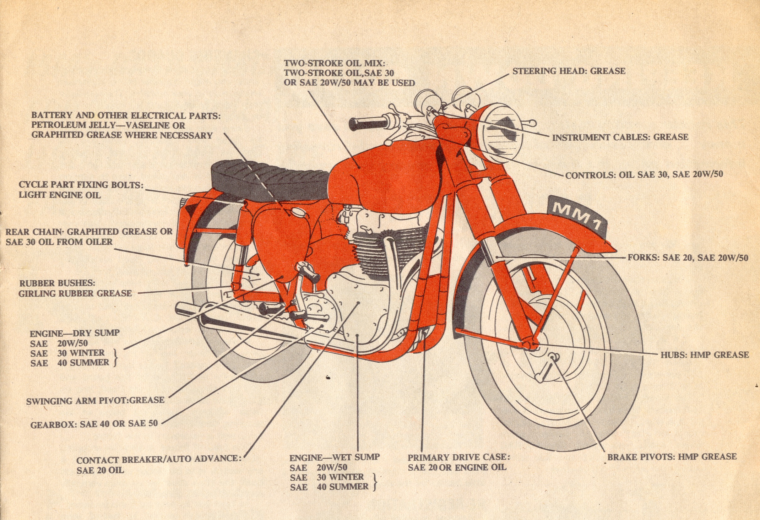

Thats good Phil,  Now if you would just add  the whitworth spanner sizes all round , both sides in A3  size    Job done !!.  I will buy  a couple for the workshop .    I would think you could sell  a few more too.
