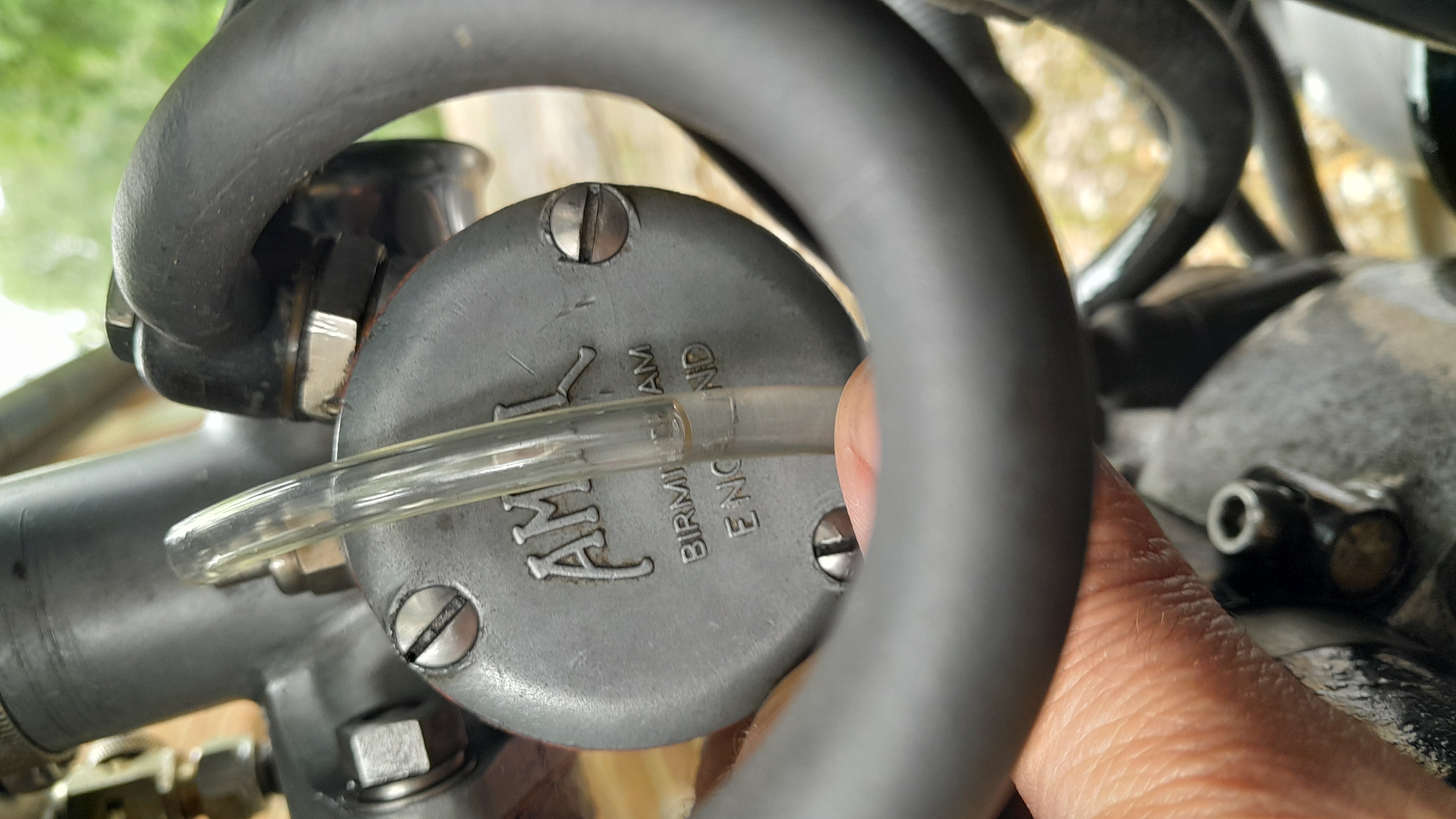

Right, I surprisingly had some time today, so I took a bit of clear tube to attach to the pilot jet.
A bit of wiggling saw the fuel level rise up to... not where it's supposed to be. I took an old float chamber cover with 'level dot' and held it next to the one that I've put on. Seems the level should be flush with the bottom of the 'ma' letters (the photograph is angled, the carb is not).
As the bit of extra copper strip on the float isn't really easy to make thinner, I took the file to the Viton tipped brass float needle instead. I've always suspected it was longer than the original plastic Monobloc one anyway. Before filing, I did check if I had a spare though!
The fuel level is now pretty much near (but definitely not over) where it should be. Starting is harder now, but the flat spot has gone. It feels less fast in acceleration now, but I know that a flat spot will let the picking up after that feel like massive power. Evening things out will make it feel less spectacular.
I guess next start, I'll try tickling a bit les and don't let it overflow. See if that makes starting better. Now time for a cooldown so I can get the plug out and set the points and timing.
