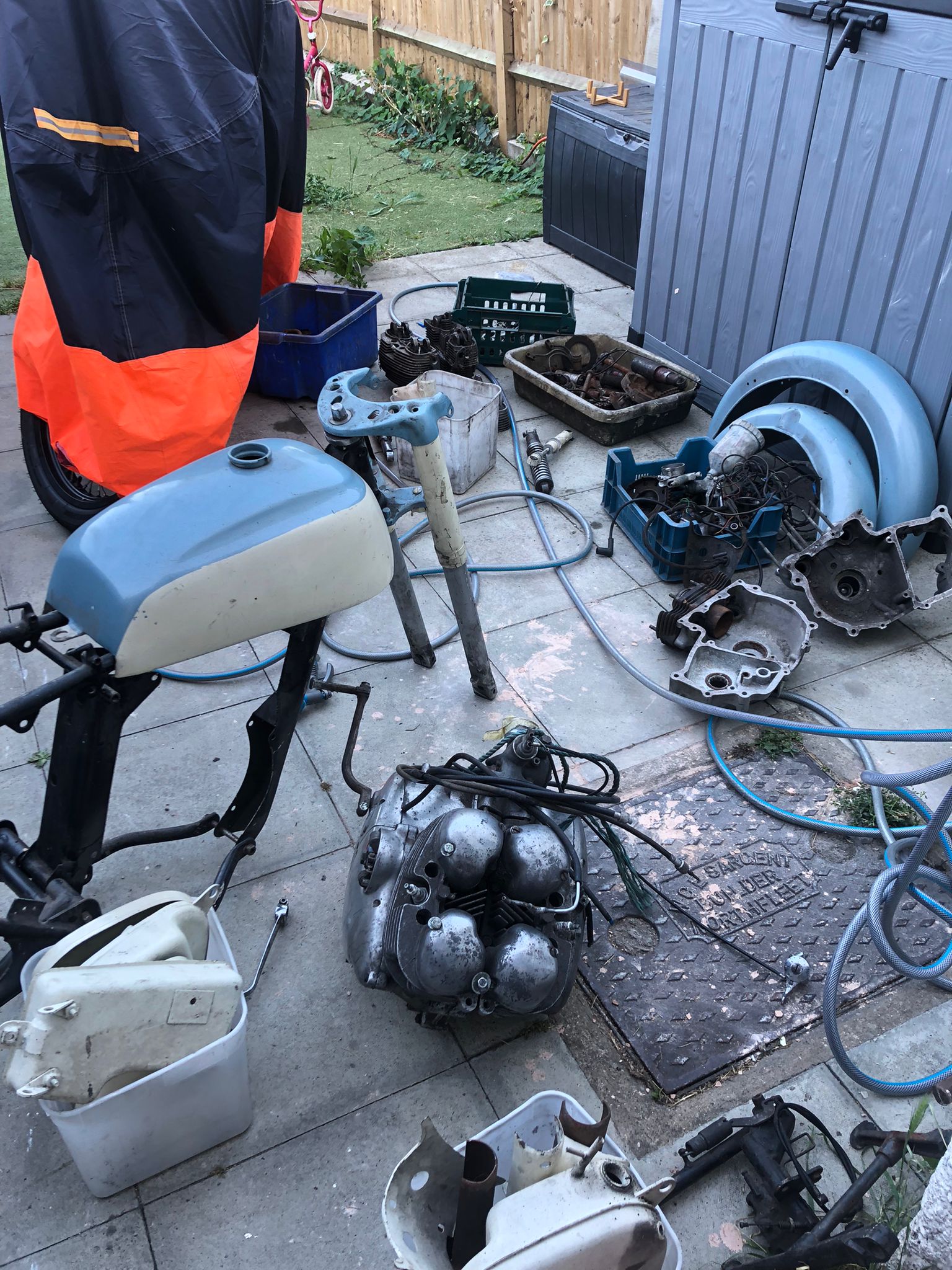

So. i wanted an old British motorcycle , I have been looking on and off for the past couple of years , two weeks ago a did a bid on a old Norton thinking " no chance i will ever win ", guess what , i am here now . The machine its split in two ,engine and frame, plus some other random bits that i am still sorting trough. The bad news is i have no V5 and no plate number, it has been sitting on a garage for quite some time but previous owner says it was working before it was taken apart .

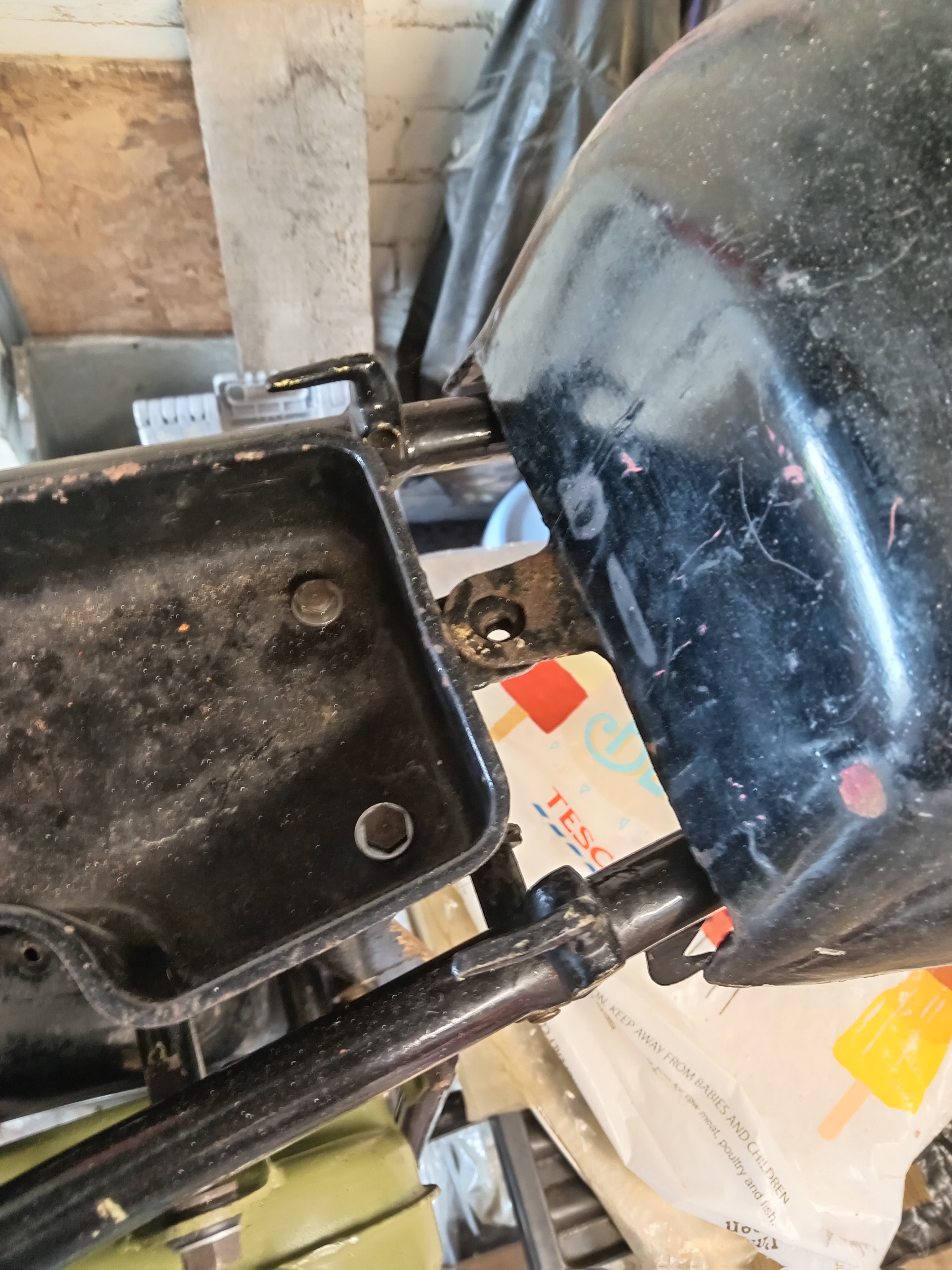

I have been looking and buying some bits that i find on bay , Recently found a headlight case and battery tray.

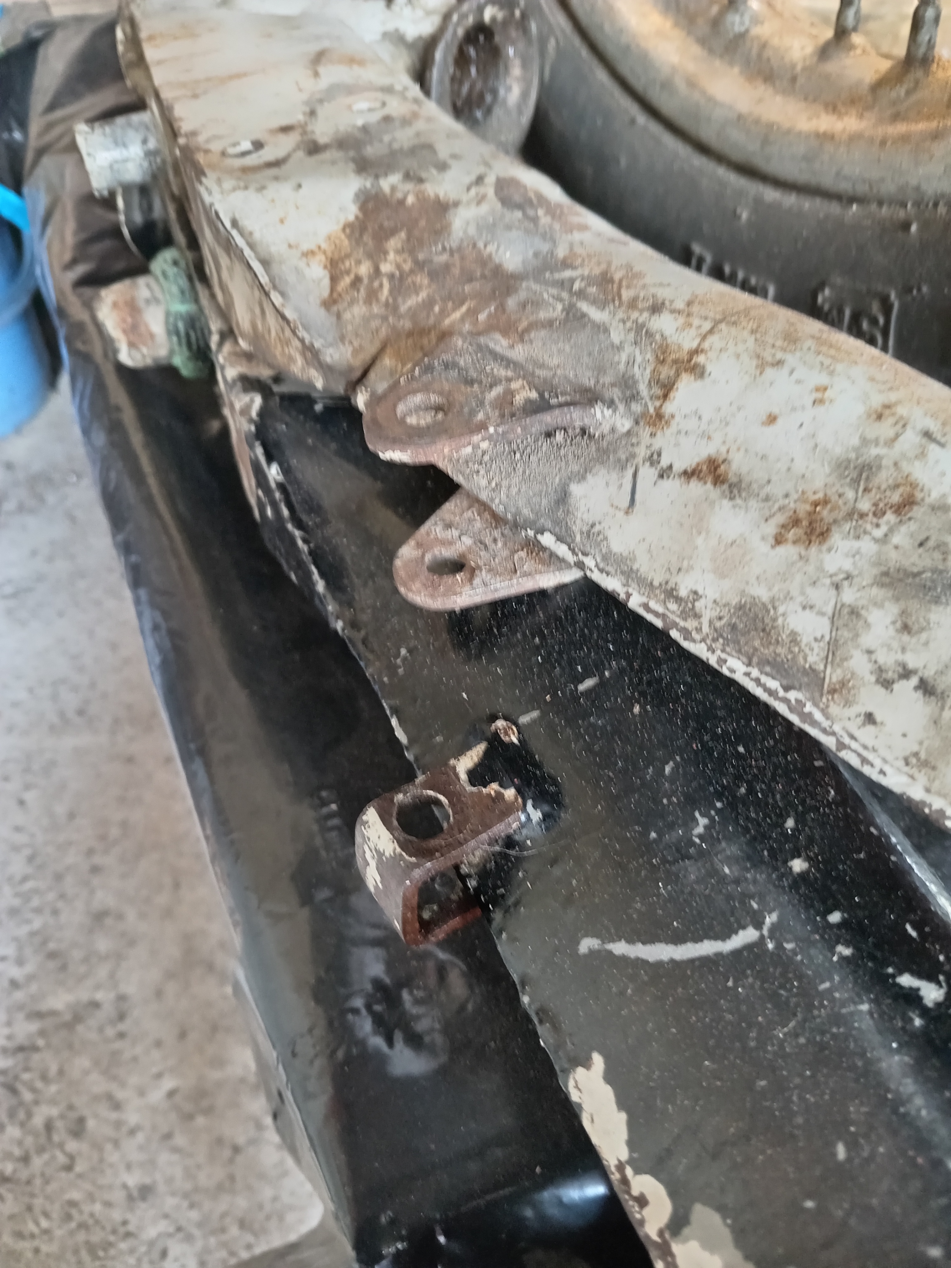

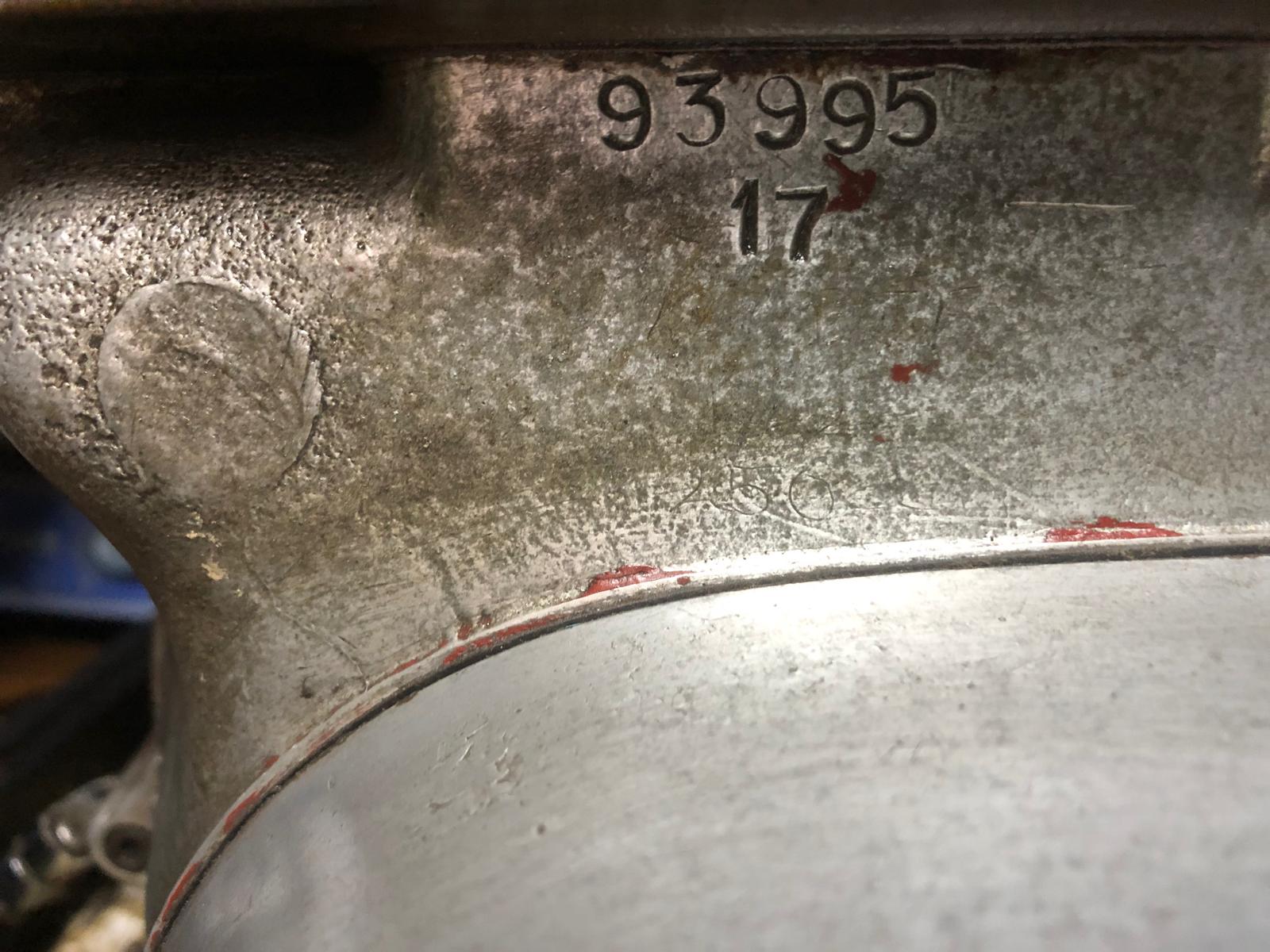

Adding pictures, the parts book states its probably from the 60's

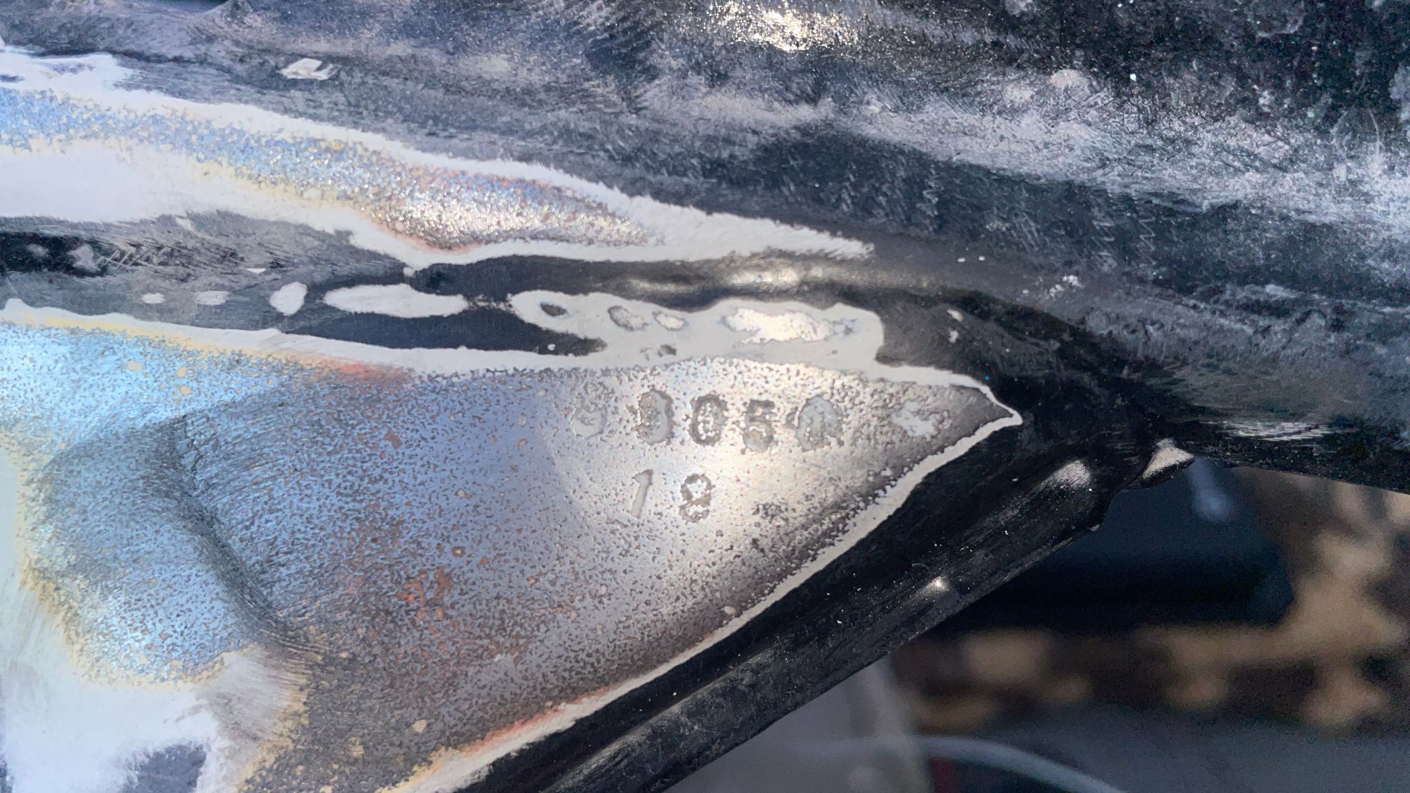

Frame 9095919 but the markings are bit worn im not sure what to make of some of the numbers.

Bit of work here. Engine number is a mid 1961 Jubilee. Your parts list is a bit early. Try to get Norton parts list PS215 for 61/62 Jubilee and Navigator. It's very good and shows 250/350/std/de-luxe differences.
Your frame number indicates a standard model. But the lower two digits might be 19. So a standard Navigator frame side.
The front down member on Navigator frame has two plates welded for Navigator head steady. On Jubilee, shorter engine, front down member has a bridge piece welded for head steady.
The tool tray you have was only fitted to de-luxe models and was also rear tank mount.
You look to have most of a standard Jubilee.

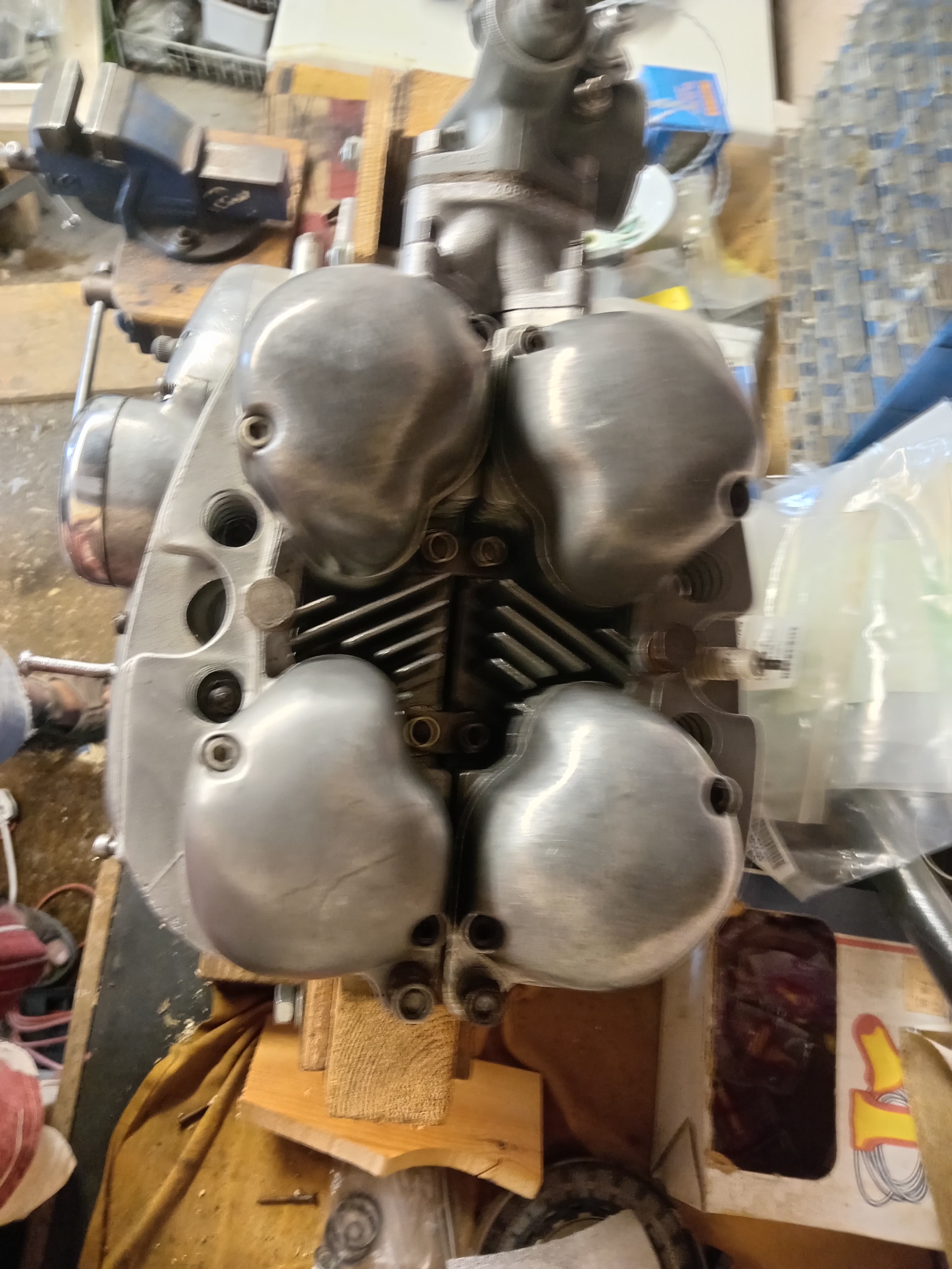

Them rocker cover fasteners of yours made me wince. Photo of top of earlier Jubilee engine. Needs to be like this.

So i have a standard 61-62 jubilee , with a navigator frame ? i assume they are sort of similar but the navigator coming with a 350 engine?
The rocker cover fasteners came with it i noticed that straight away, criminal.
