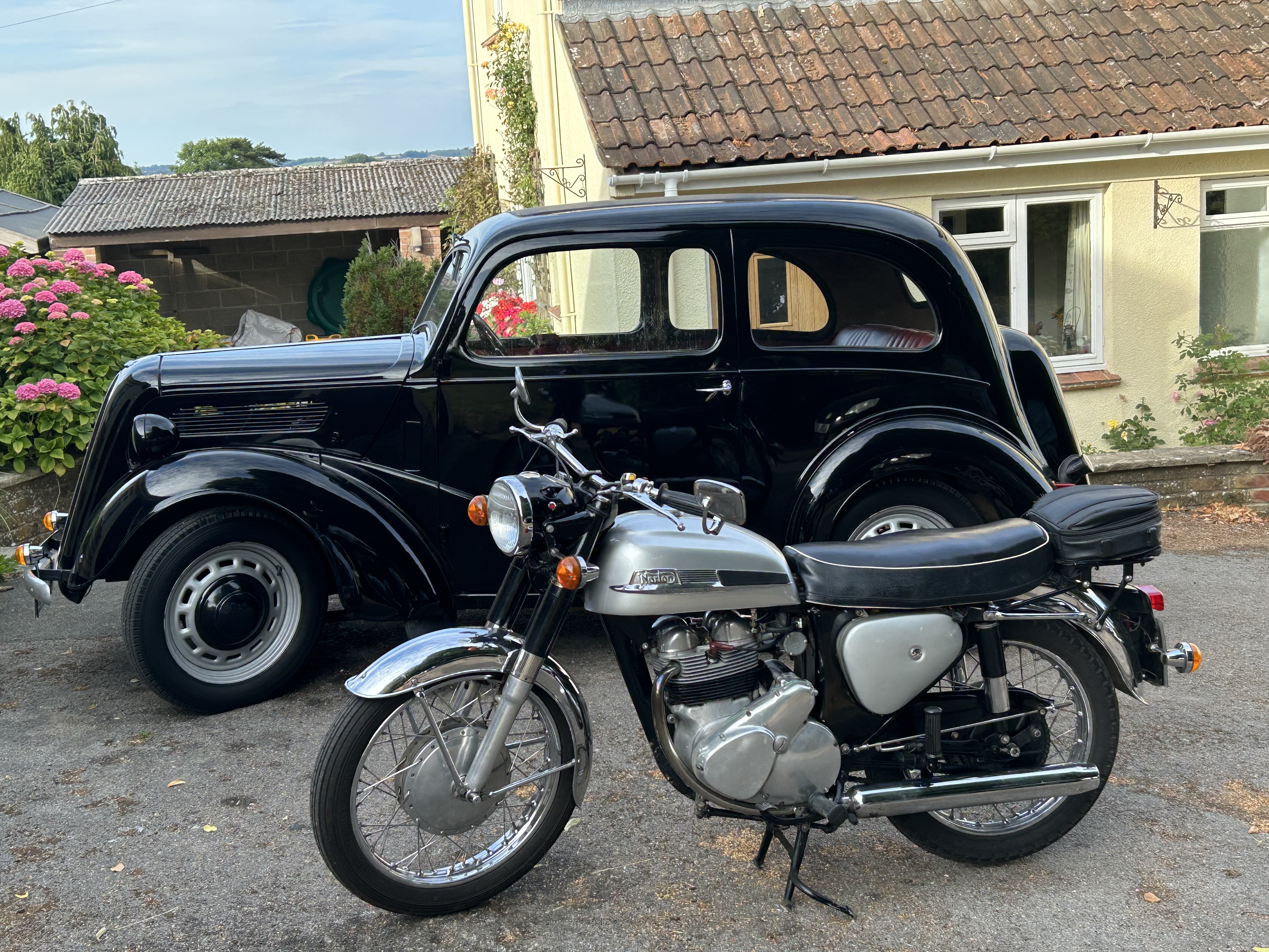

To lift the mood I've attached a picture of the Electra after this evening's run - side by side with my dear old 1955 Ford Popular. The perfect combination of classics!

Your Electra looks great - I like the little bag on the rack.
Thanks Ian, I haven't done…
Thanks Ian, I haven't done anything cosmetically since I got the Electra because whilst not perfect it was as you see it, including the clever little tool bag which happily doesn't rest on the rear mud guard which can cause them to fracture.

Your Electra and even older Ford Pop look fabulous.
