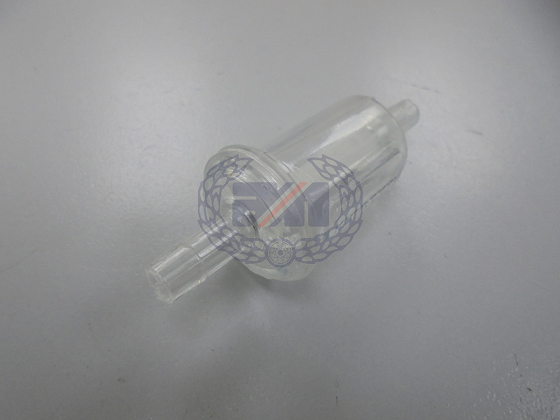

The cheap plastic transparent filters works for me. You can see amount of debris. But there are metal filters too, some with transparent middle.

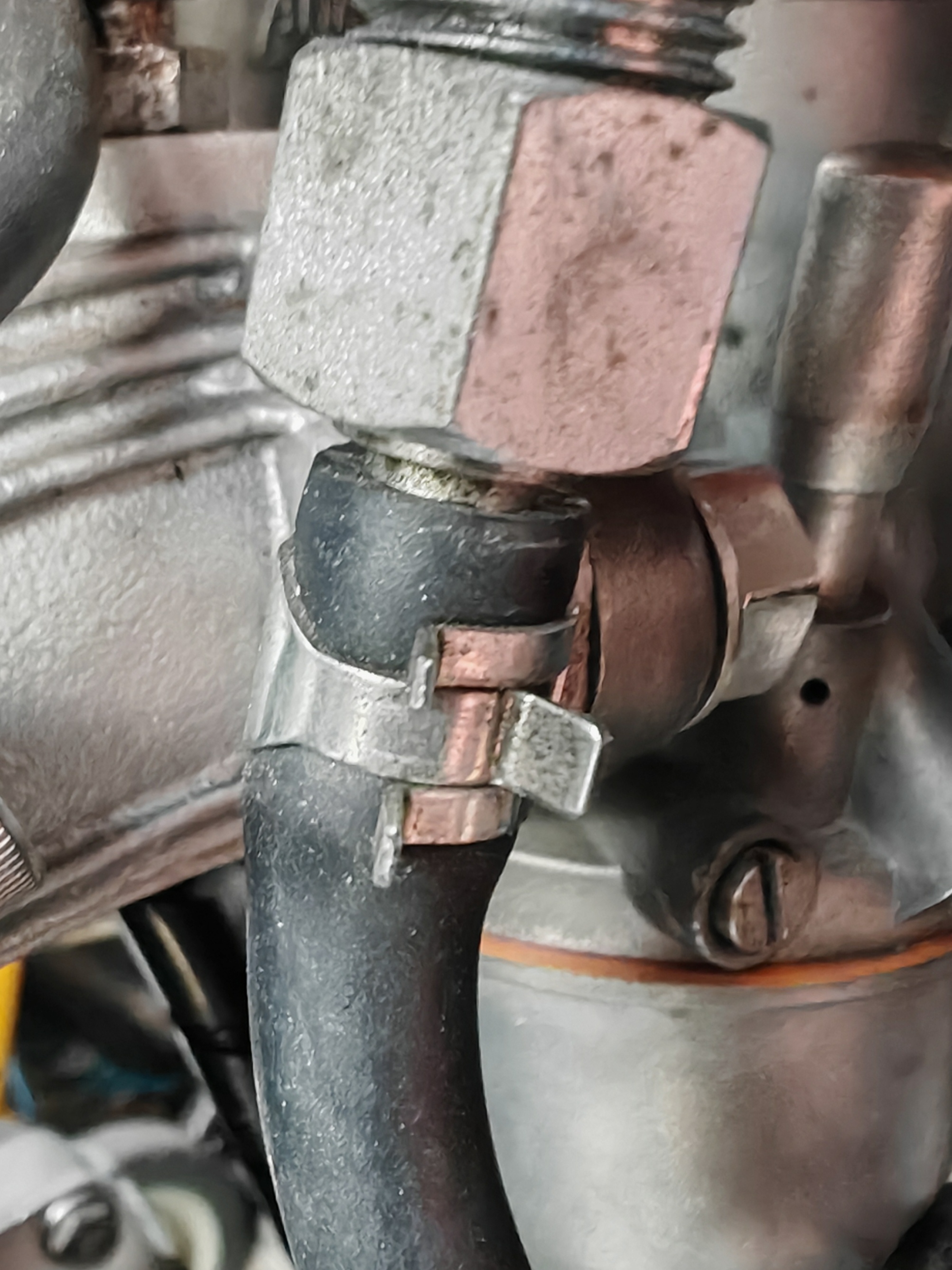

Hose clips

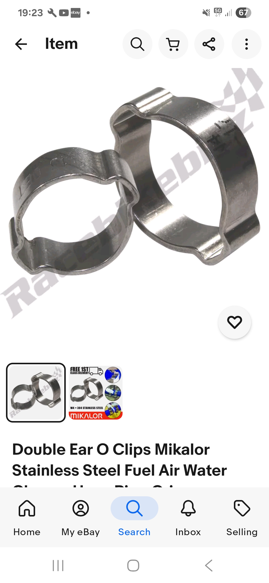

I use these type of clips they are cheap and easy to tighten with pliers, just get the right size.

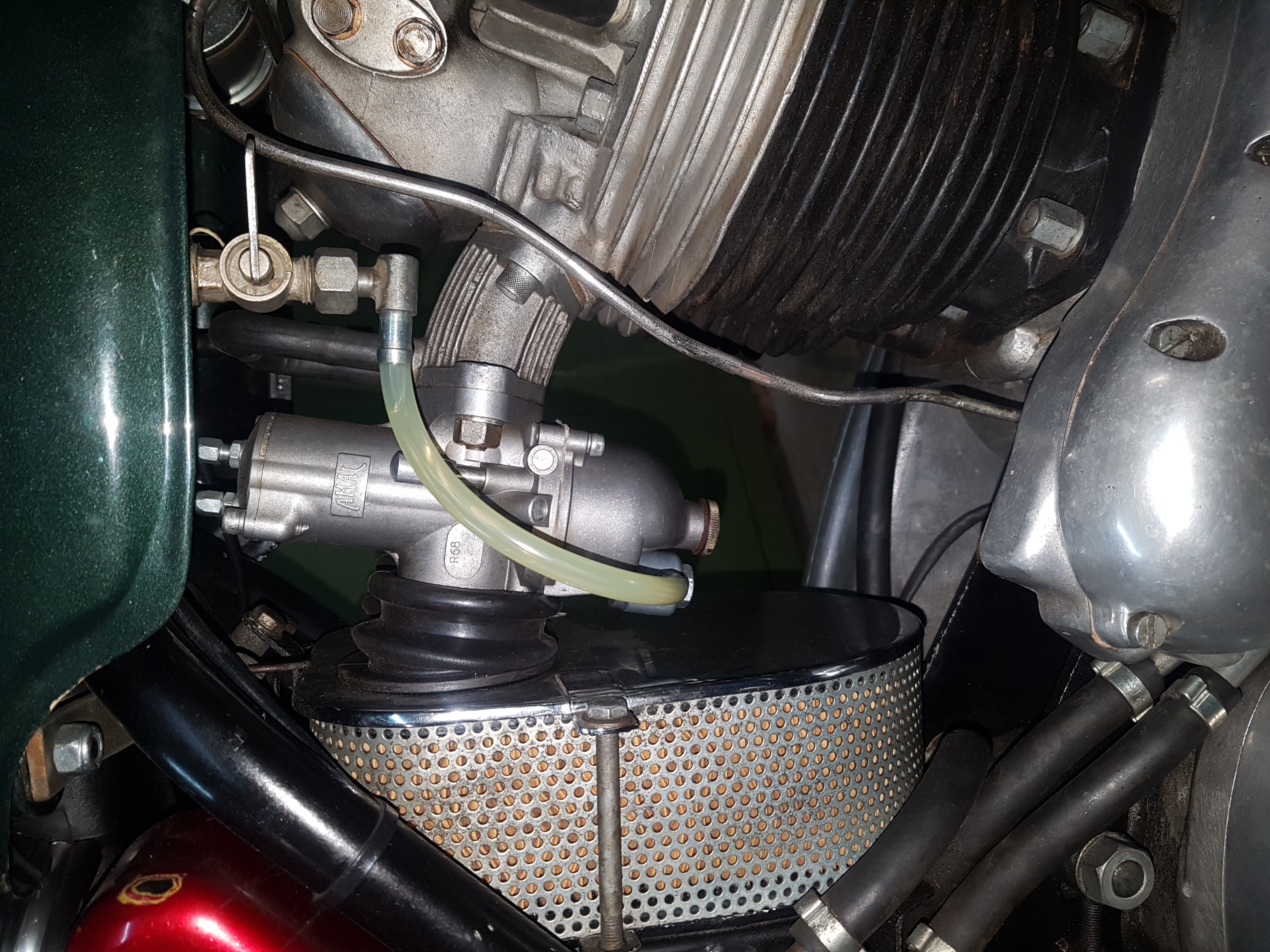

I've used this:
which is very flexible and doesn't seem to be damaged by modern fuels.
