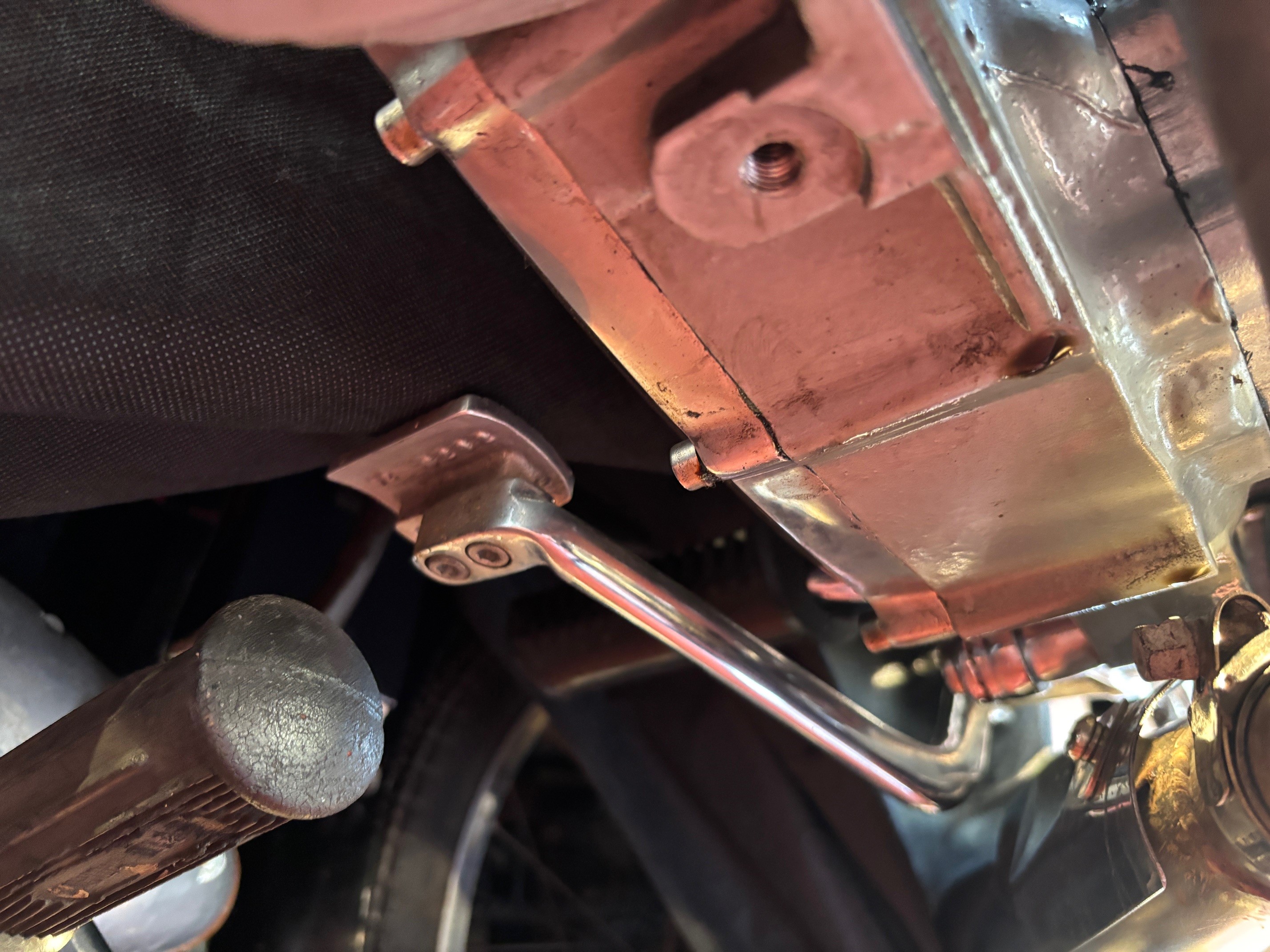

Just bought a low mileage classic. Went through Richard N's workshop a few years back but not used much since. Ive put 200 miles on it yesterday but there is a death rattle about 4,000 rpm and when coming to a halt
Im investigating and found what looks like an EMPTY drain plug hole in the primary case....not mentioned in ant of the books I have as a drain hole
Should there be a plug here..I assume so and my death rattle I guess is the primary caes devoid of oil
Any comments please?? BUGGER !!
All described in this photo
Yes I see the drain and fill…
Yes I see the drain and fill hole as shown in the book BUT what is this hole??
a stick poked in goes in an inch and there is evidence of oil in the tread
It's a mounting for optional…
It's a mounting for optional engine bars or fairing bracket on the Interpol 2.
oh right that explains it …
oh right that explains it . Just seemed odd.
In a way good but in another way bad ...my bike still has a "death rattle" and no idea what is wrong...sounds sort of like primary chain as on overrun and when throttle "static" at about 4,000 rpm
Thought it might be no oil in primary and missing drain plug.
I will investigate the primary drive though. ANY ideas welcome
