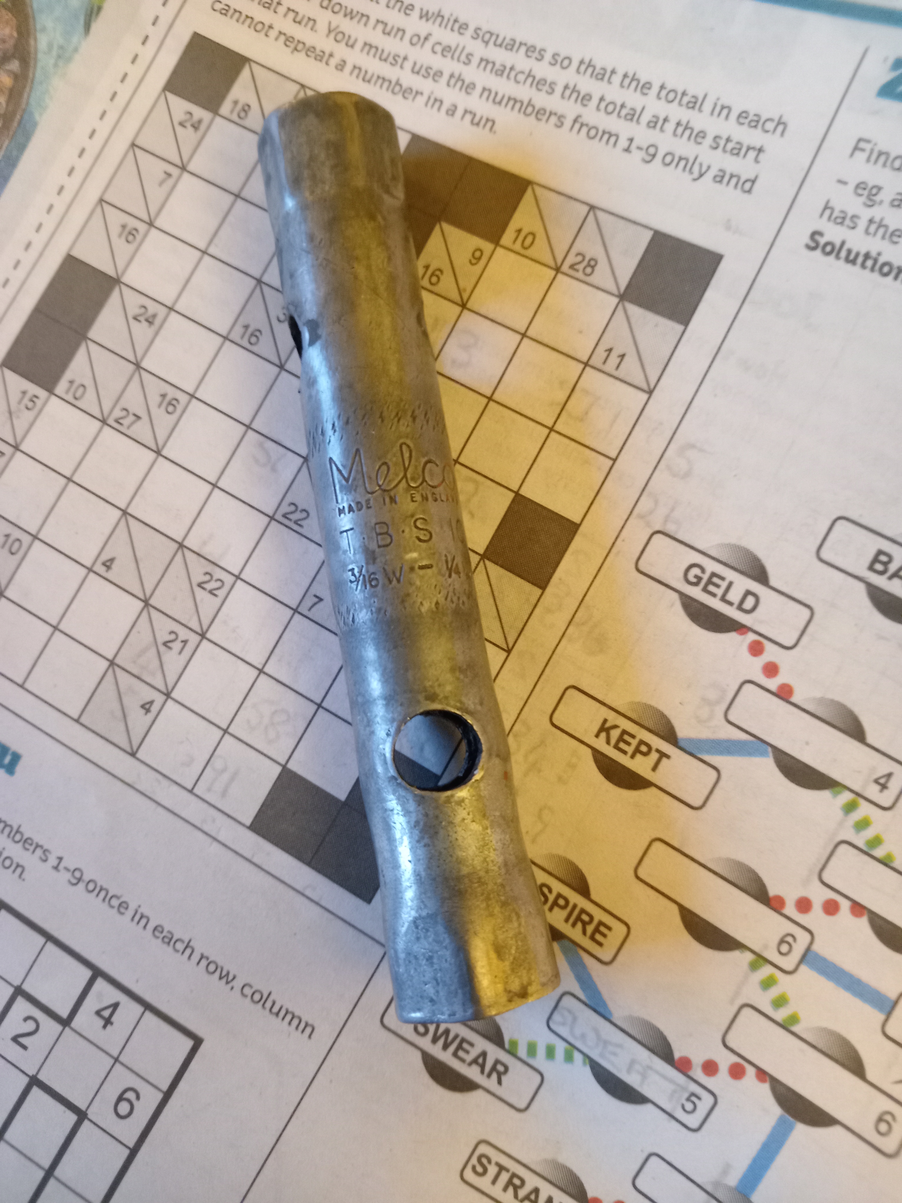

I use a box spanner, short, with 1/4W at one end, 3/16W at the other. Useful to carry in toolkit.

The trouble with box spanners, and this means ALL such, is they are soft, soon wear and therefore the torque you put through them is VERY variable. Parts that are less important and awkward need to respond to a box-yes.
Of course if you save a box for the head bolts, there is always the temptation to 'use it else where'
