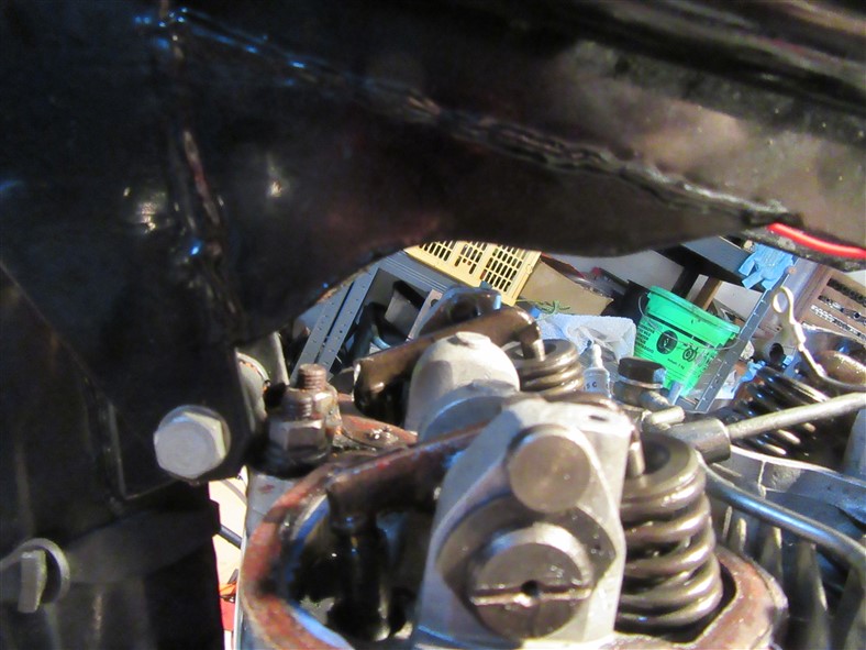

I thought I'd just check the tappet clearances on my Electra. I've read about the struggle people have had wriggling the tappet covers past the steering head reinforcing plates. Imagine my surprise when I discovered that a previous owner had made beautiful curved cutaways in both - the covers slipped out very easily.

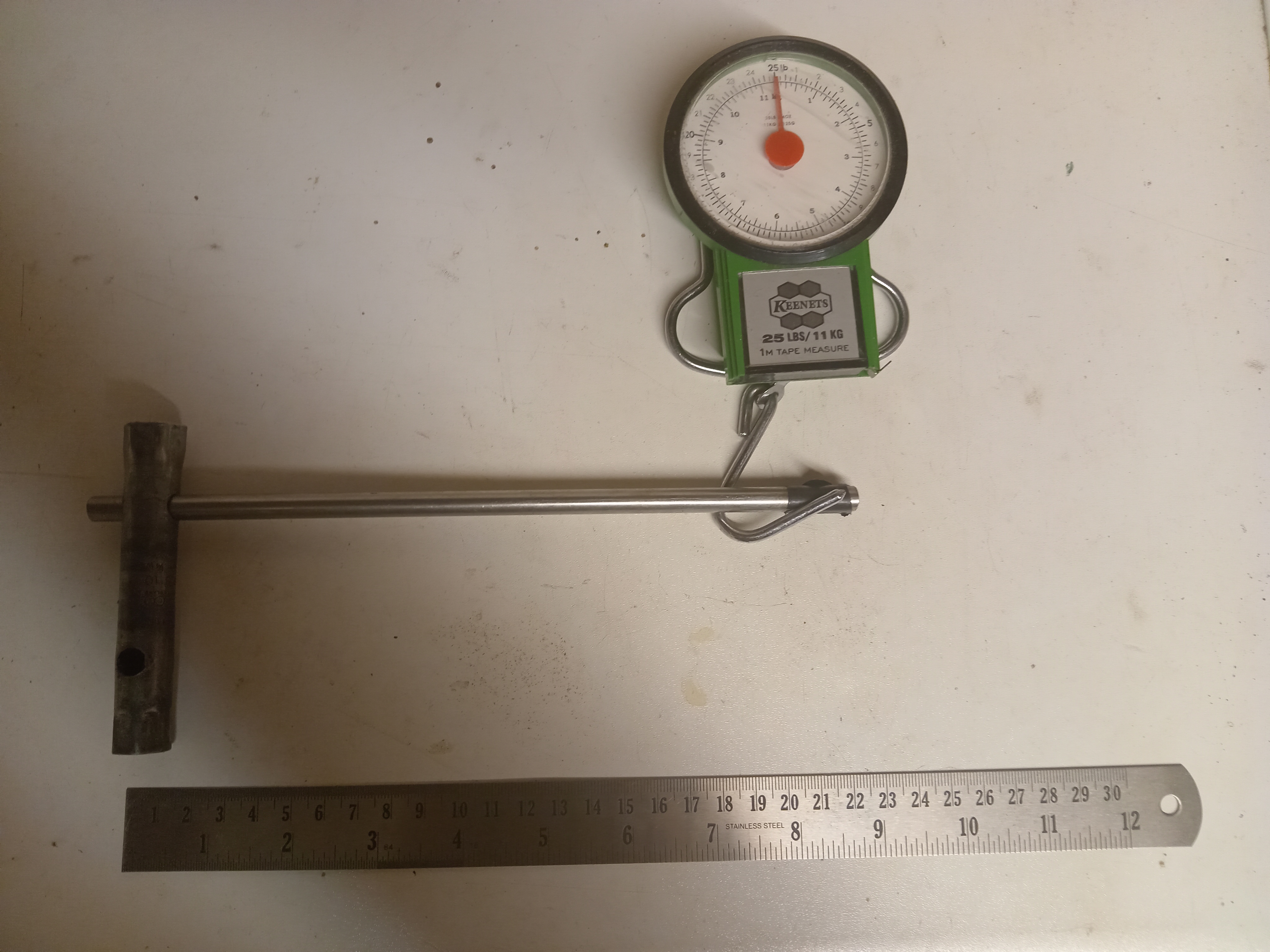

I use a luggage scale, a short tube spanner, and a stainless steel bar with black tape on the end to stop spring hook sliding off the end.
Bit of maths needed, but full scale pull on this device, at 90 degrees to an 8 inch arm, gives 15ft lbs near enough.
Interesting photos....
... the back looks like mine but the front has those arcs cut out.

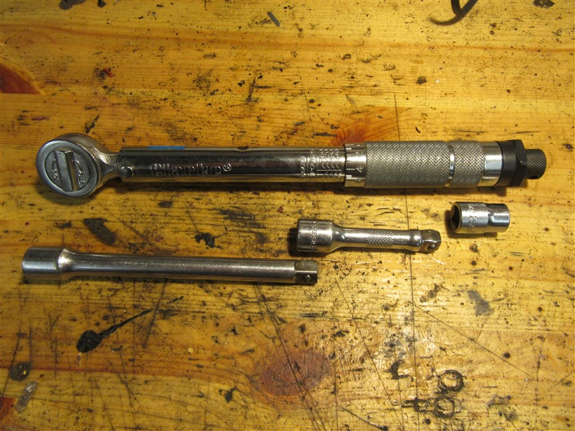

A quick trial....
... tells me I can use a 5/16" BSF 3/8" drive socket (King Dick), a short "wobbly" extension on that and a longer non-wobbly one. This combination reaches all the nuts and is long enough to attach the torque wrench to the top unencumbered by frame tubes etc.

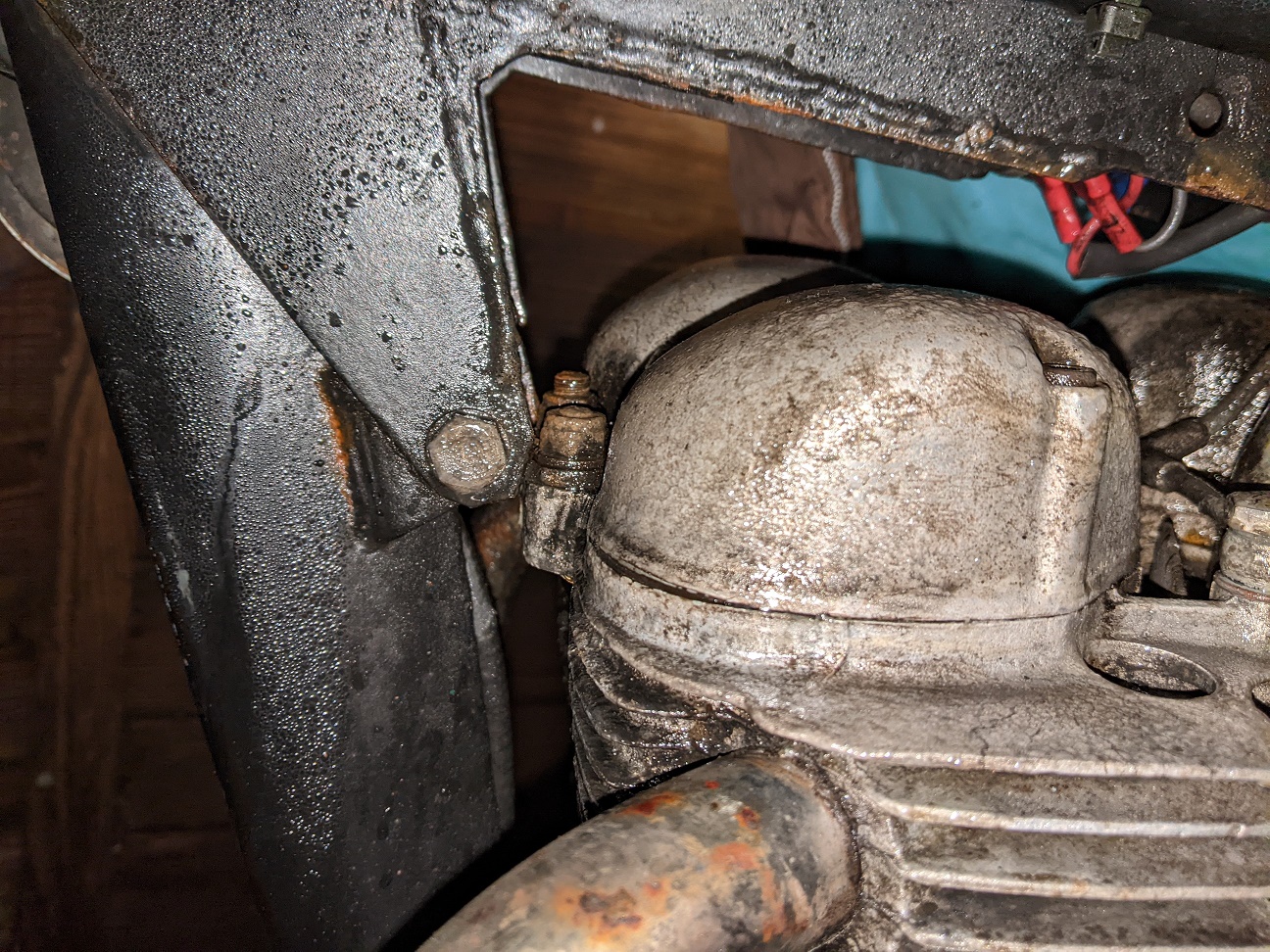

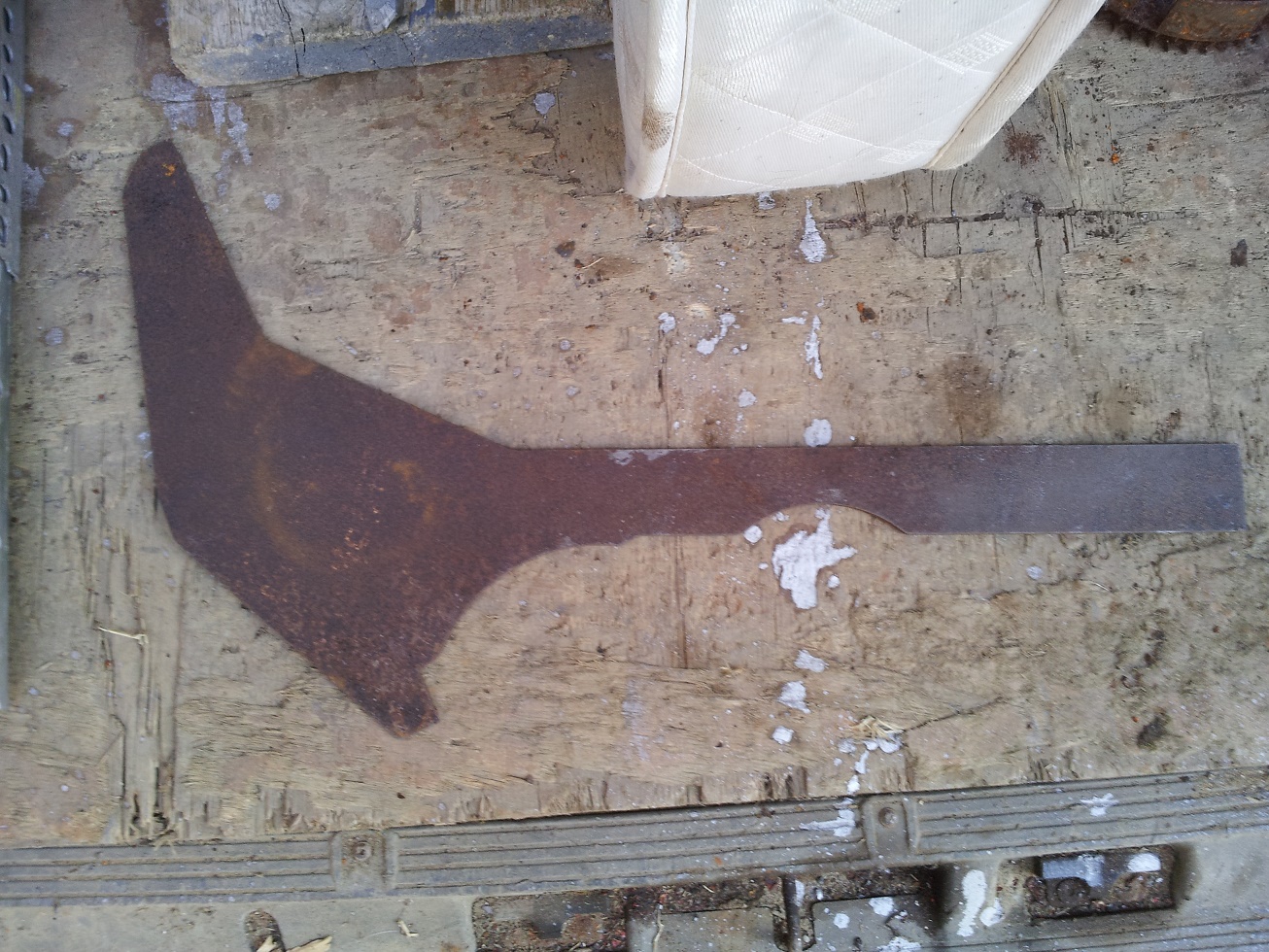

Spoiler Alert....Electra Rocker Box removal.
Not all Electras had cut-outs to help remove the Exhaust Rocker Covers. Very early ones DID NOT have them. There were cut-outs, however, over the Inlet covers.

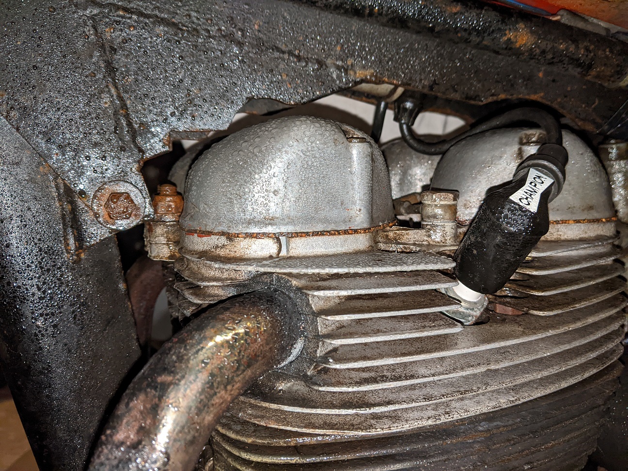

Mine were crudely modified by a previous owner sometime before 1980, when she came into my life. And my friend Chris (or a previous owner) cut out the whole panel on his - (see photos).
The neatly curved ones shown above look like the ones Terry Brock/Ray Sage were selling in the 1980's/90's. Also Bob Nicholas (RIP) made a batch that he was selling on eBay.
Pictures are:
1) My Electra - No 1289
2) Chris D's Electra - No 1016
3) A real support bracket - from my Parts Bin
4) A Pattern part, made by Bob Nicks (RIP)
Took the photos of the two bikes in my shed this morning.
Am staggered by the condensation (& rust) I found.
Our delightful cold & wet wunters in the UK......
Have coated it all with WD40 now. (Bit late!!)

All original Electra strengthening plates had cut outs to allow rocker box removal. But to my knowledge Norton never explained how to remove the rocker covers. So here goes.
Front LH exhaust rocker.
1. Screws out.
2. Twist cover 90 degrees anti clockwise and roll out over the rocker post.
3. If step 2. Does not allow removal. The valve is in the open position and the rocker raised. Turn engine on kick-start, and the rocker cap can be removed when valve closes.
Rear LH inlet rocker.
As above but in step 2. The cover must be twisted clockwise.
For the RH the step 2 rotations are reversed.
Can't think why Norton never published these simple instructions, leading to the myth of struggling owners with bastard files creating more clearance for rocker cover removal.
