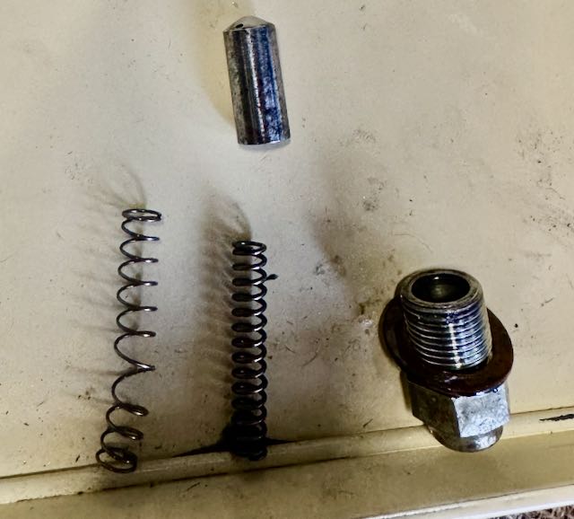

That seems to have worked....
I think I've found the culprit!
The old cam plate plunger spring on the left - new one on the right. Thought I'd change the spring and test that first before tearing into the gearbox, only costs a fill of gearbox oil.
The bike held on to first uphill until the indecent amount of 5000 rpm was reached. Trying different on and off throttle combinations and she feels a lot more solid. Gear change and neutral finding a lot more positive too. Shout out to Peter Shand for the suggestion as a job to do 'while I was in there'.
You can see the old spring on the left was not up to the job and had been stretched at some point.
All for the sake of a 90p spring...
As with all these things on an old bike I'll keep my fingers crossed and see how it goes.
Definitely the wrong spring…
Definitely the wrong spring had been fitted. Reminds me of a tale from our club sec, He once came across a g/box not selecting properly, he found the pawl spring was made from a coat hanger!
conclusion
Mick,
thanks for the photo and update.
Good to learn the conclusion of your fault.
Also it's of general interest and possibly helpful to others on this forum.
Coathanger?
Crumbs - I knew they were good as car aerials - but there's no spring in one!
Given the obviously bodged plunger spring and the fact that the mainspring wasn't on the pawl points to what Peter described as: "previous owners have had very variable skills, sometimes leading to allsorts of horrors lurking within."
Oh well - we'll keep an eye on the box - but I've learnt plenty in the process!
