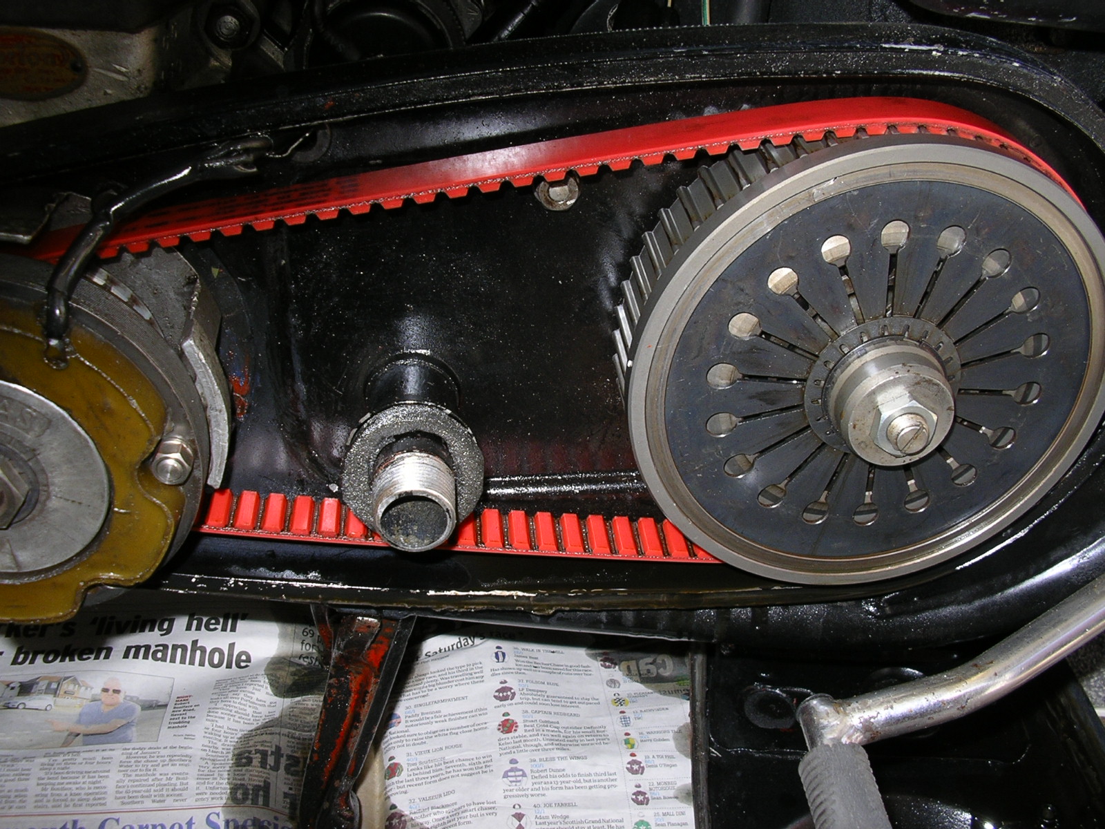

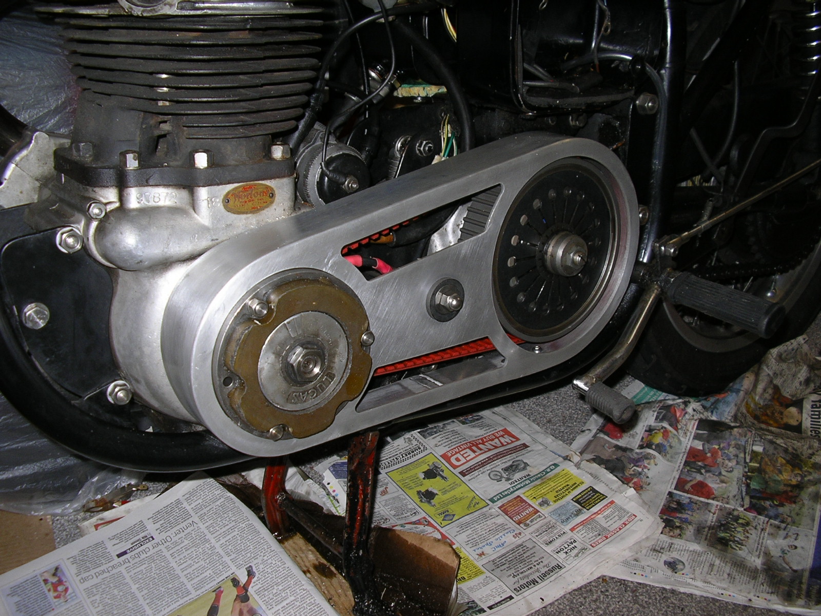

Attached photos show my RGM primary drive conversion to belt drive. One photo shows it fitted inside the original tin cases and the second inside a tasty RGM alloy cover. Both have run quite happily for over 10,000 miles despite having all kinds of rubbish thrown at them.
I went for the open alloy cover, not just for the looks, but also because a good airflow through the drive helps to cool the pulleys and limit the amount of expansion due to heat from the engine. This has worked for me despite having to run the belt with just 30mm of play in it as a result of having a fixed position gearbox.
The standard Commando primary covers plus a belt-drive conversion need at least 40mm of play in the belt or it will probably lose teeth or break. Adding some form of cooling such as mesh inspection covers or even drilled holes in the covers will help.

That RGM belt is of a different material and profile to the Hemmings one I have, admittedly a few years old now, Mine is black rubber with round tooth profile.
Free play in the drive belt is best set when the bike is hot (go for a 10 mile ride). Because the alloy pulley wheels expand this might well equate to 40mm when cold. And +1 about cooling.
