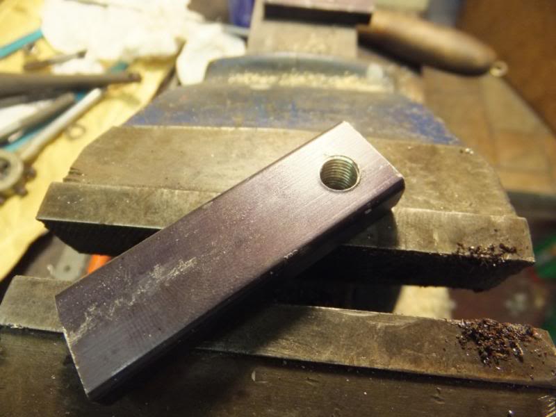

I had the same problem wit…
I had the same problem with a Matchless G80S I had. I ended up making "nuts" out of 3/8" thick alloy.....
