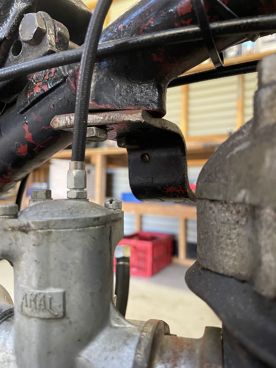

The carb has been swapped for a Concentric but in order to make that fit, the right half of the rear petrol tank platform has been cut off. I'll be trying source one of those, too.

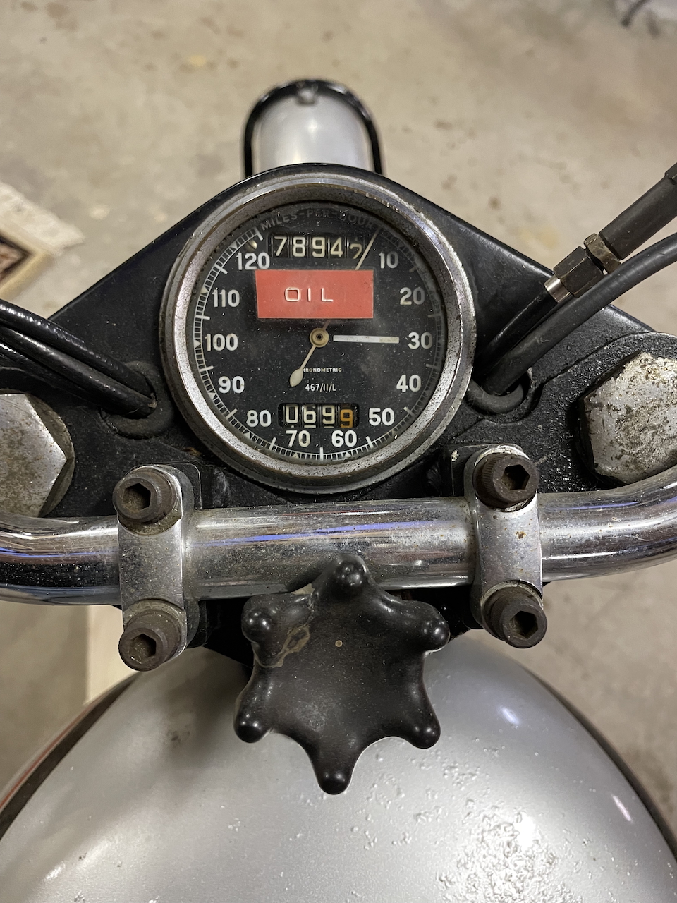

The bike has a steering damper knob which does not look like the ones I'm familiar with: does anyone know if it's genuine Norton for that period?

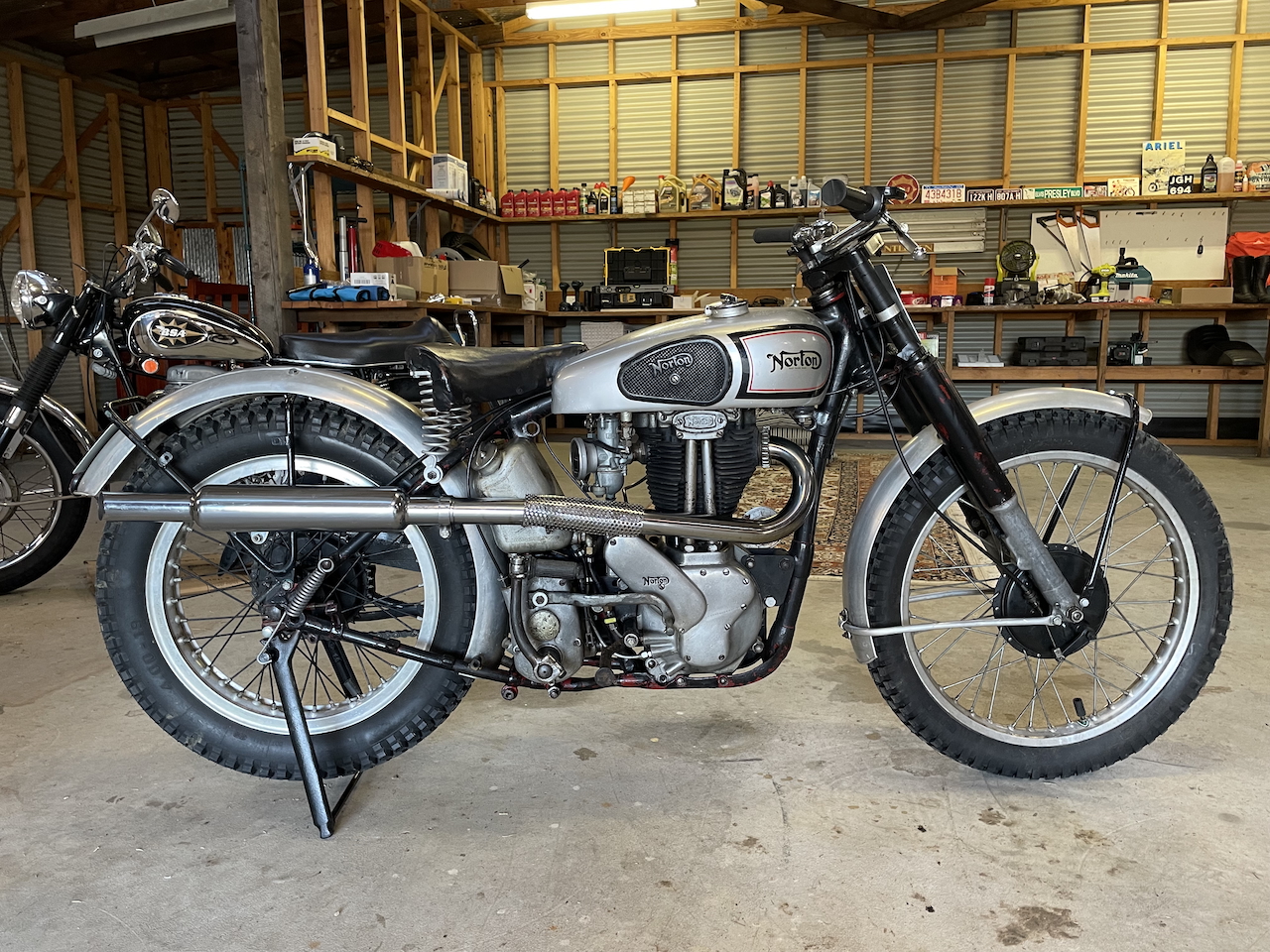

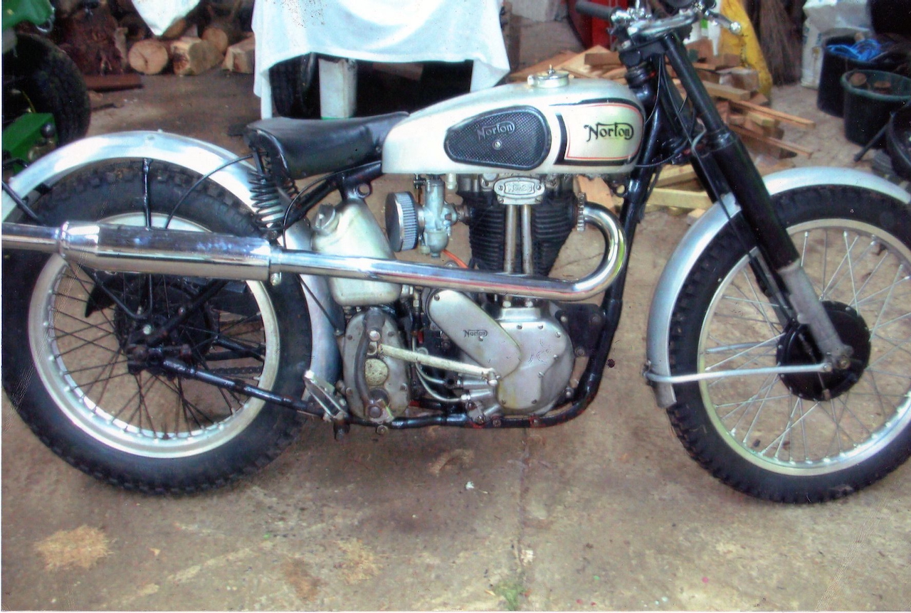

I'll attach a couple of photos showing the brochure image, advert, and the bike as it is now.

I've uploaded a photo showing the cutdown petrol tank platform bracket, too. Worst case I'll have to get one fabricated: at least the one I have would be suitable as a pattern.
