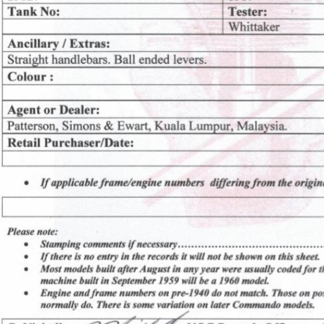

Official records say My Slimline Dominator was despatched from factory with straight handlebars and ball end levers.

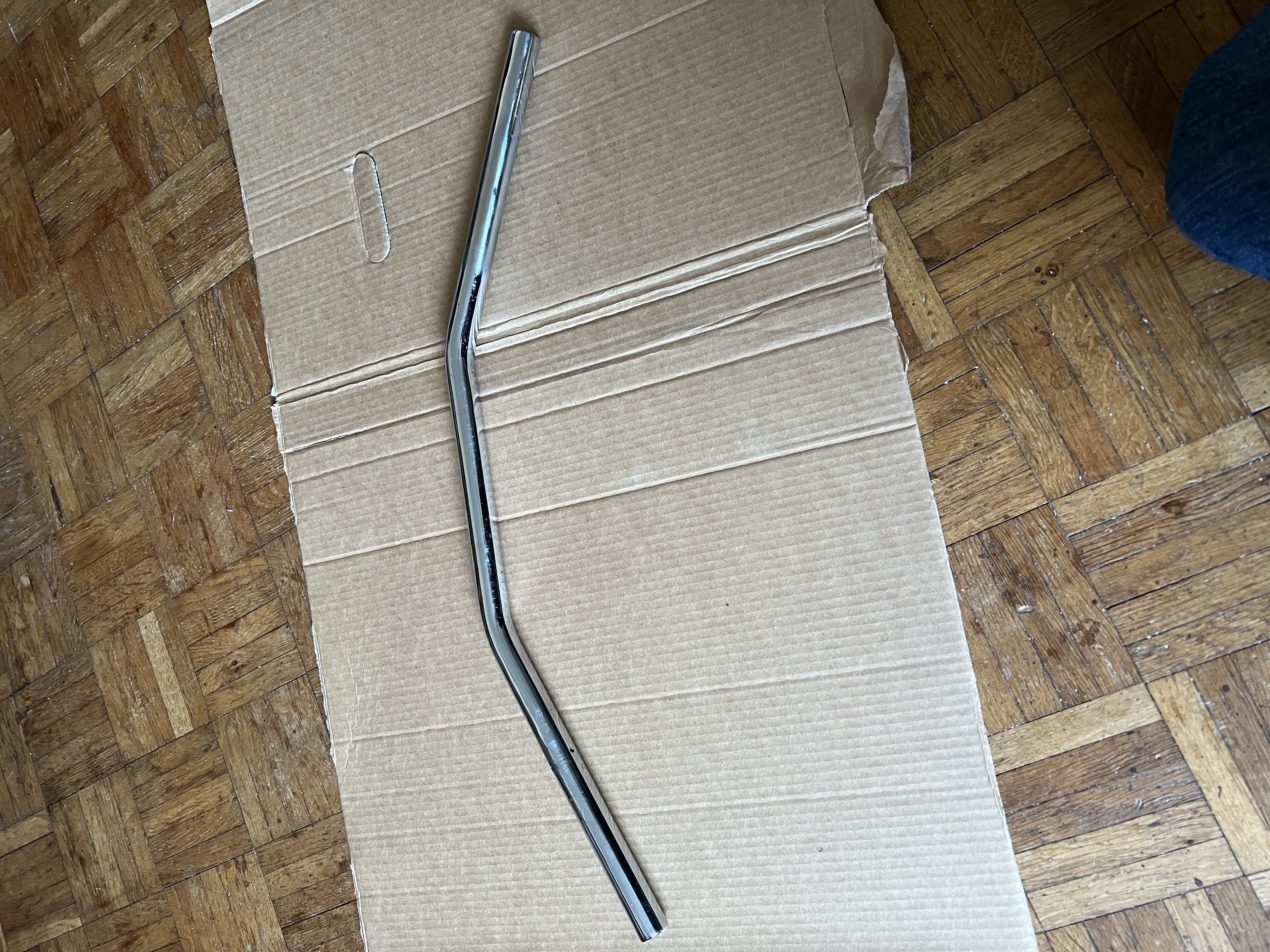

Can you share me some pictures of your handlebars? is it factory original or changed as option? what is the rise of the handle fitted to your bike? Thanks

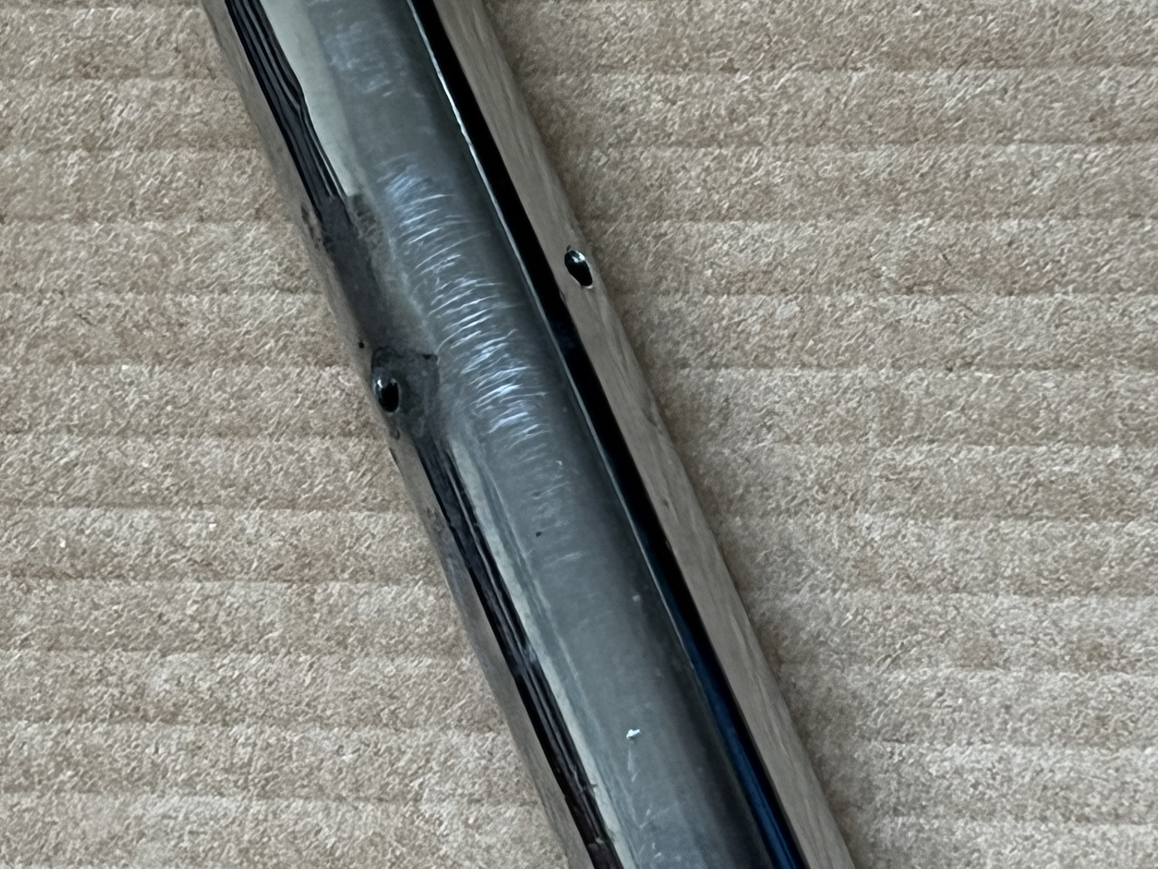

You can usually tell orriginal bars because they will have the drilled and tapped holes for the horn/dip switch. When pattern /aftermarket bars are fitted owners often changed the switch to the clamp on ones. However I think  i used my orriginal bars on another make of bike (!! ) and drilled and tapped some new  bars for my 99. I think the rise is about 2" and you are probably better off looking at old road test photos  to  judge the shape you need if orriginality is your aim.Avoid alloy or stainless steel as they are likely to snap off in a minor spill  wheras  good old plated steel bars just bend a little and get you home.
I will have to find some random  child to show me how to  post a photo.  If you google Norton Dominator 99 and  click on pictures you will get a good selection.  I should have mastered this photo stuff years ago ,so will try, don't hold your breath !!.   Look in NOC shop page 9 ,part no 19405  .
All the UK SS and Atlas Models had the straight type of handlebars unless there was a request for others.  The US market had some different types but they don't complement fast riding.  Good luck, Howard

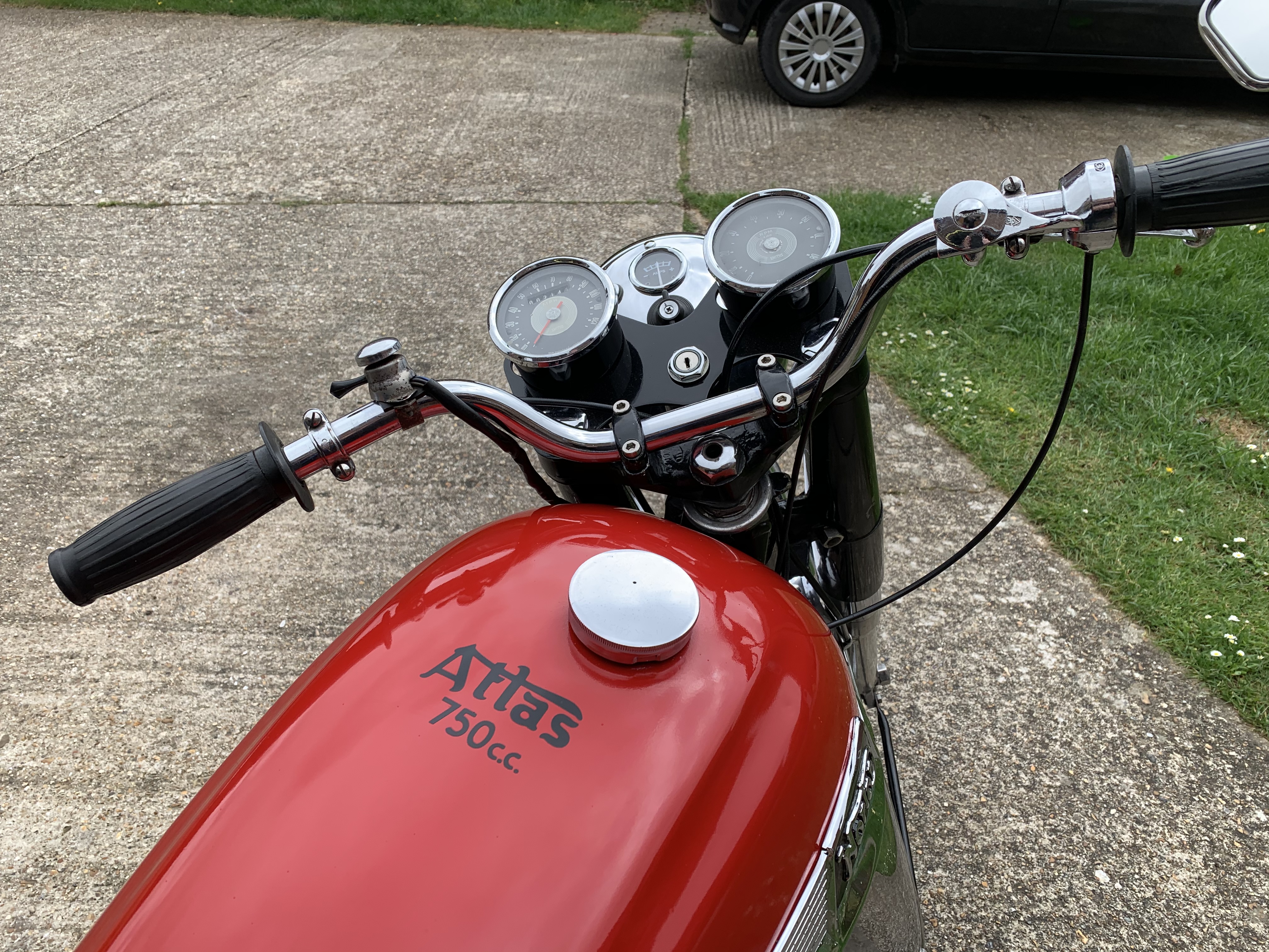

If it’s any help these are what handlebars I have on my ‘68 Atlas, not particularly sporty but certainly gives a comfortable riding position. Due to the age of the bike I’m thinking might be same as early Commando, cheers Simon
