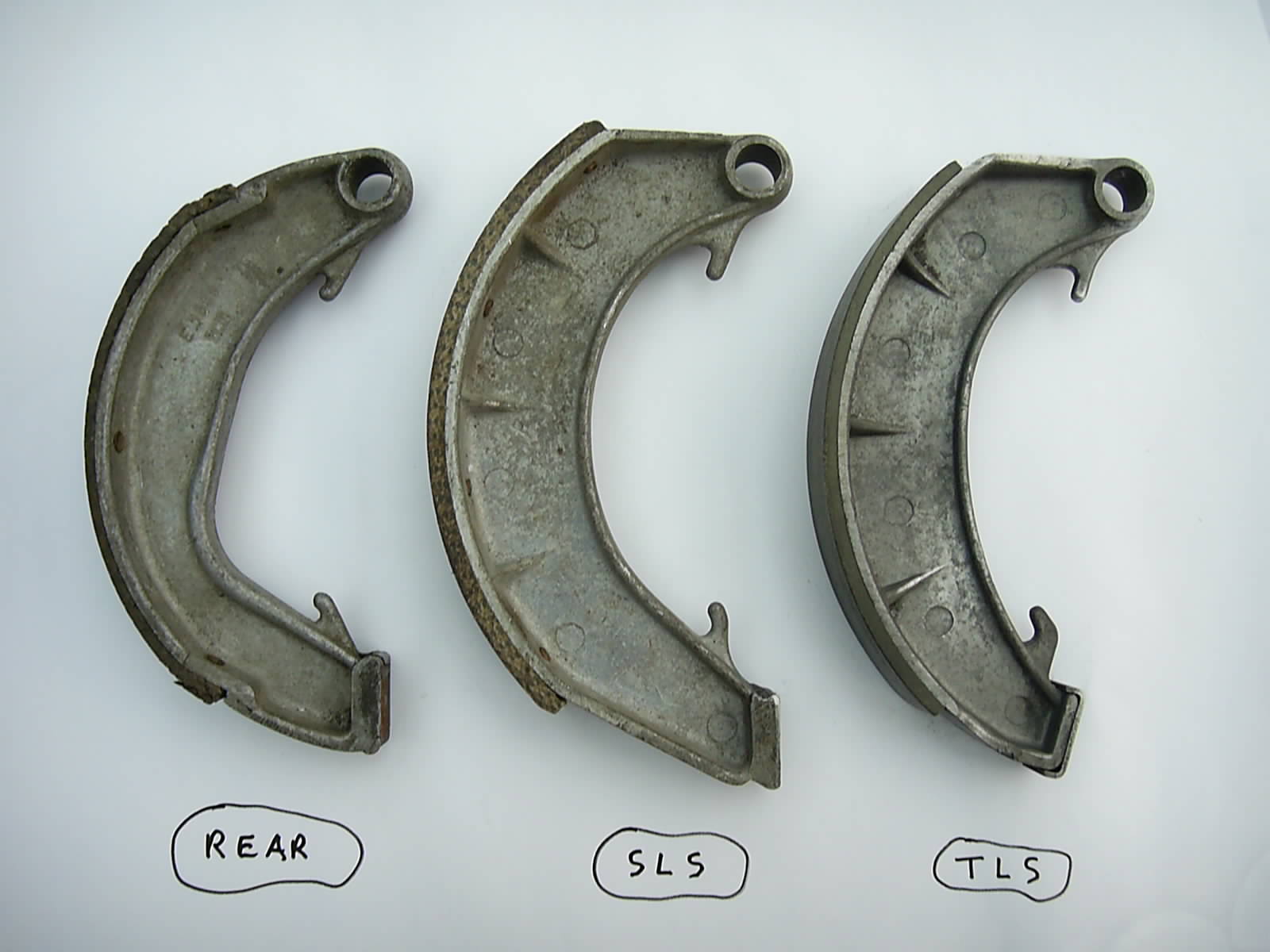

I have managed to amass a collection of brake shoes  7" sls   8" sls  and   8" TLS .  I can even tell which is which at a glance   (thats a bit sad !).  I am curious as to why some new shoes come with steel slippers and some do not .  In the past I have made my own crude  ones , but  now am  a bit reluctant to trust  bits of scrap metal  to do an important job. I am also concerned about wear to the cam faces. which  were never  meant to last   60 years.   In years long gone I would have dropped the wheel into Joe Dunphy's shop  for his expert attention  ,now we have to be our own expert.
Hi Phil, all the shoes pictured appear to have slippers ,whether this is for resistance to wear or to adjust reach  is really the question ,are they always fitted?.
Added slippers often depended upon who supplied the replacement shoes. Especially in the 60s & 70s when rivets usually held everything together.
Aluminium alloy makes for a good bearing material, running steel against steel risks galling, same as Concentric carbs with slide and body made from the same zinc alloy resulting in rapid wear. A good smear of grease benefits both combinations so I never worry about what material is on the end of a brake shoe but do grease on a regular basis.
