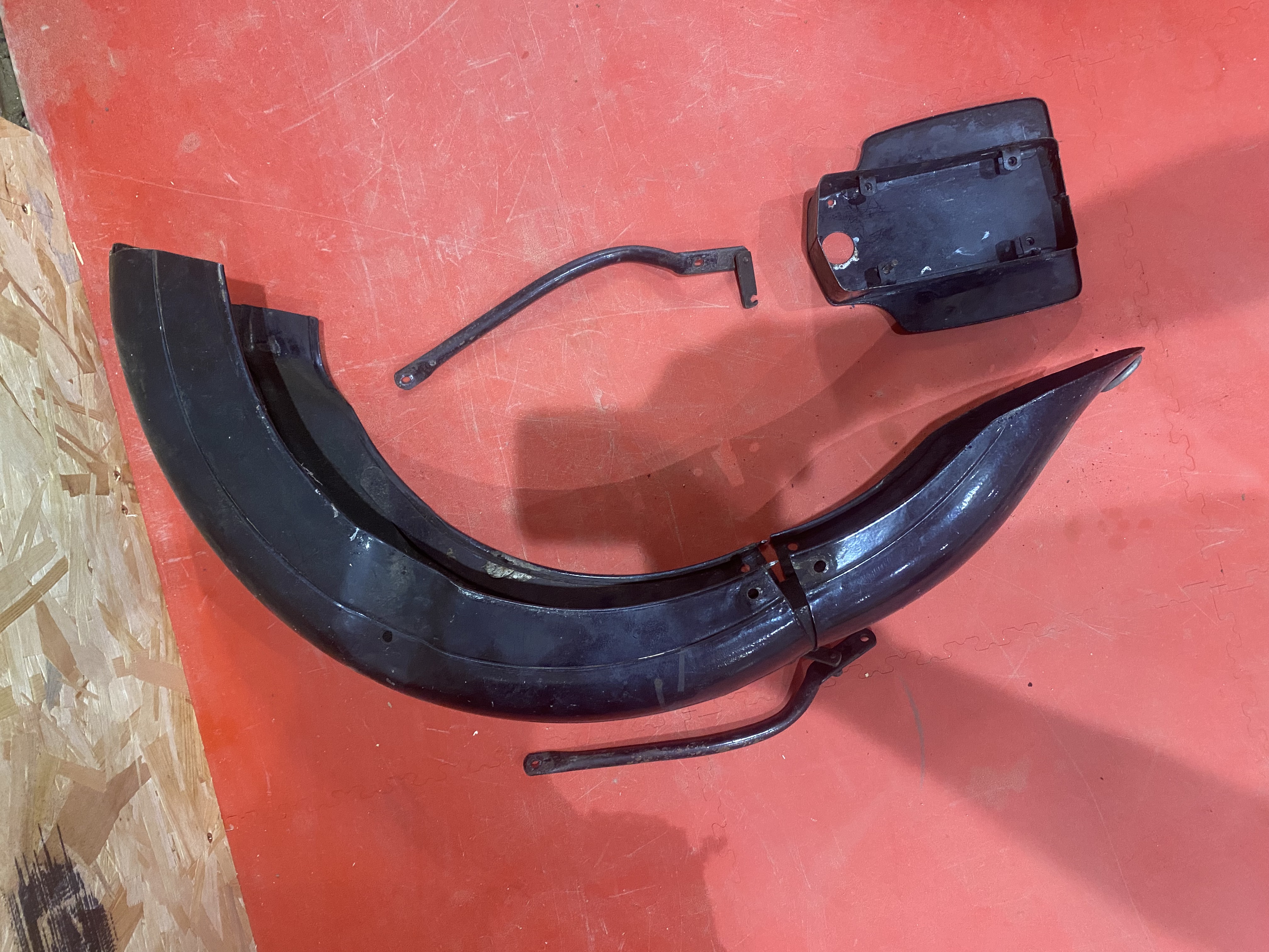

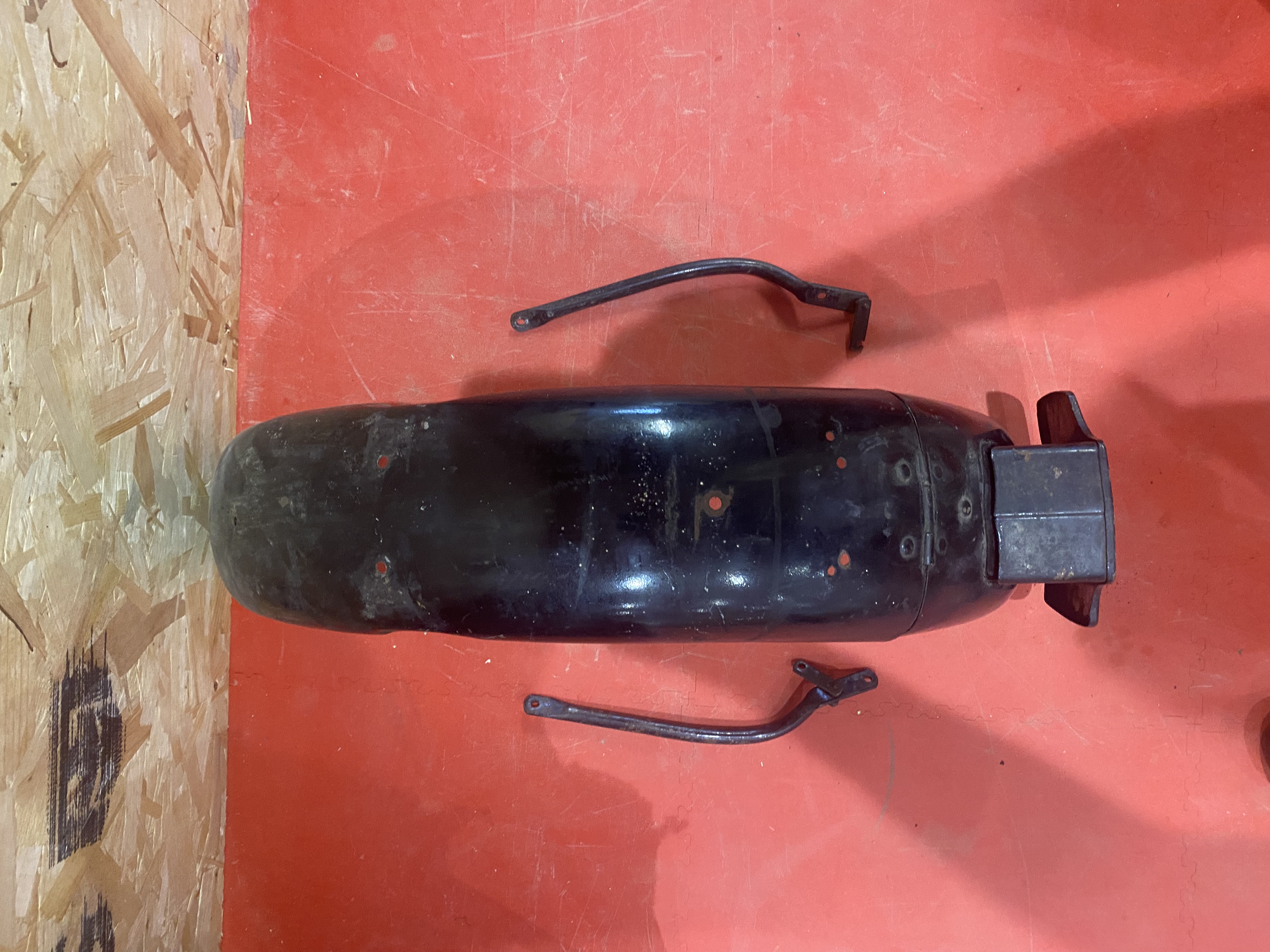

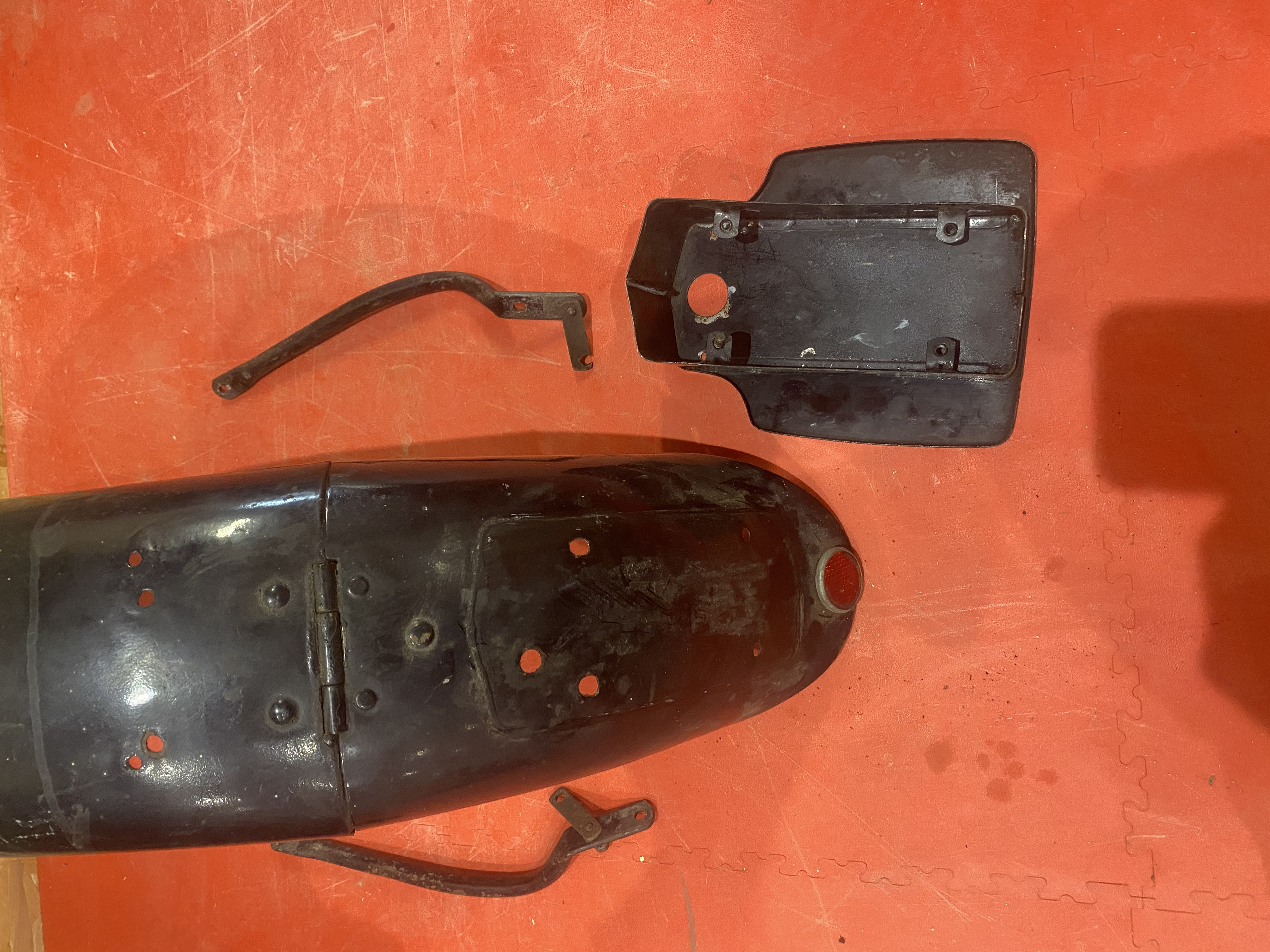

Please could someone identify what year this rear mudguard and back light / number plate mount is, I don't think its 1954 as I have some 1954 Dominator mudguards and other parts I'm also looking to sell. Thanks.
The guard appears to be 54-55 swinging arm Model 7/ES2 [I believe the 56 does not have the recesses where the guard attaches to the shock absorber] , the numberplate bracket appears to be covered in on the sides so therefore 1955 as the 54 was open at the sides,
