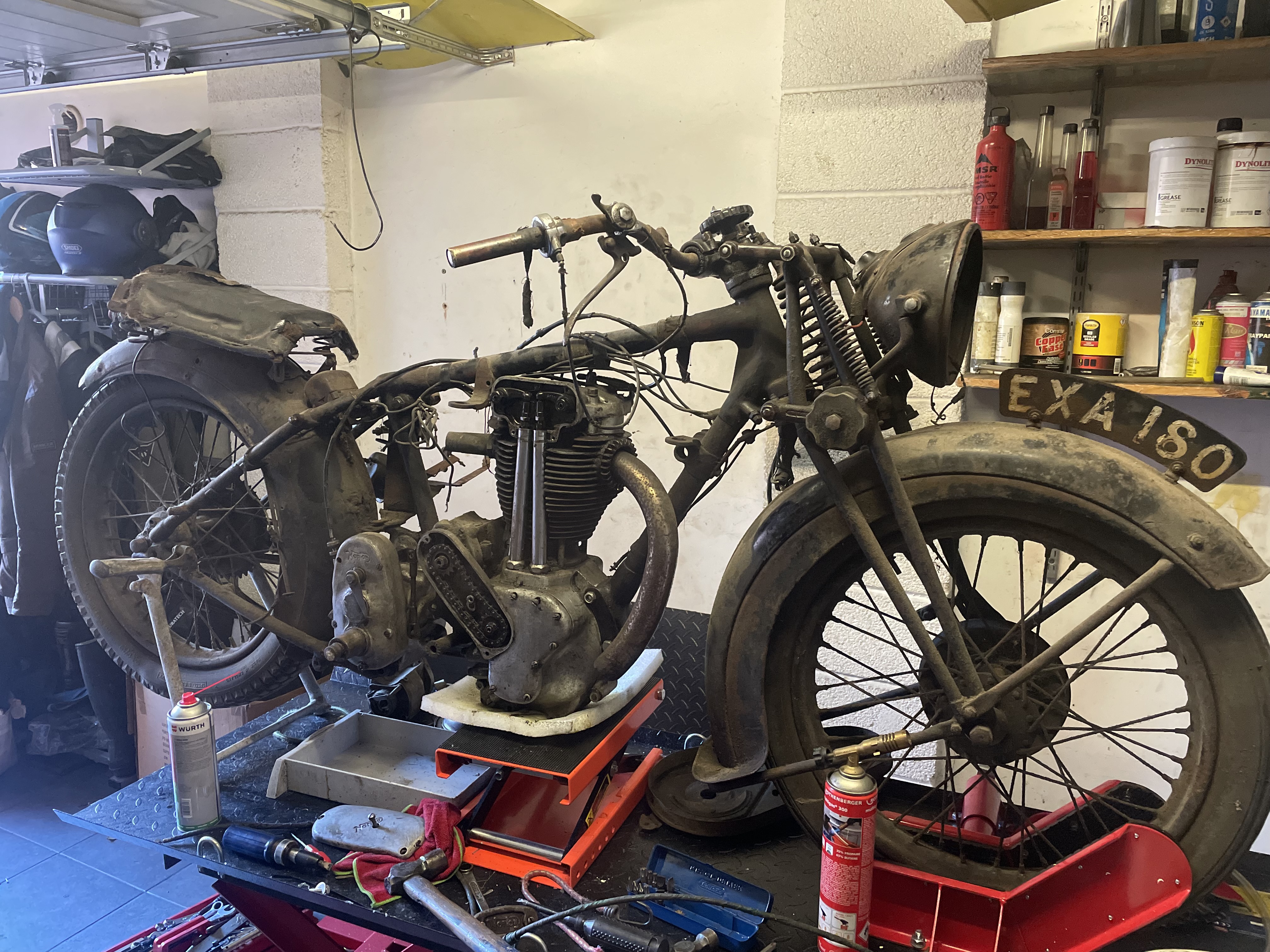

Starting to reassemble my 38 model 18 with a 47 engine.

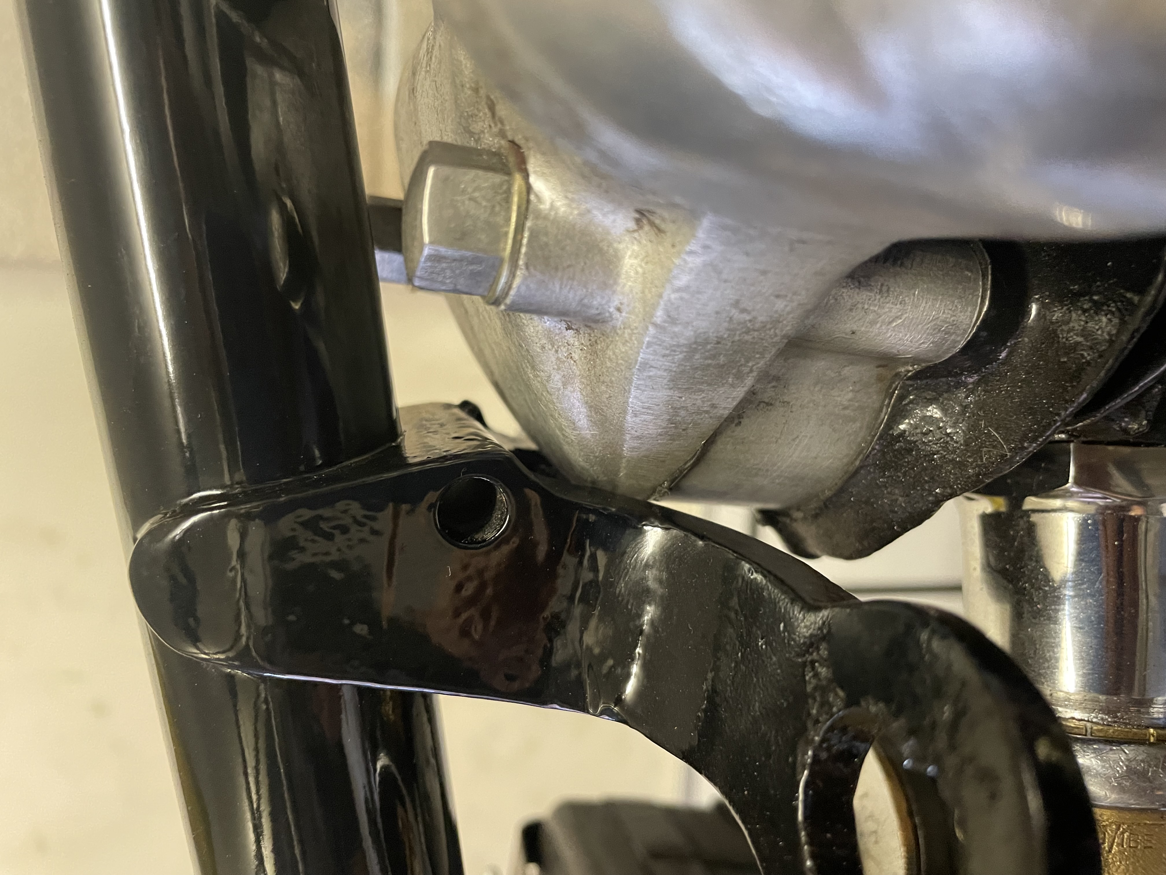

Looking at my nice model 18 completed there is a quarter an inch gap between the rear fuel tank mount and the top of the rocker box.

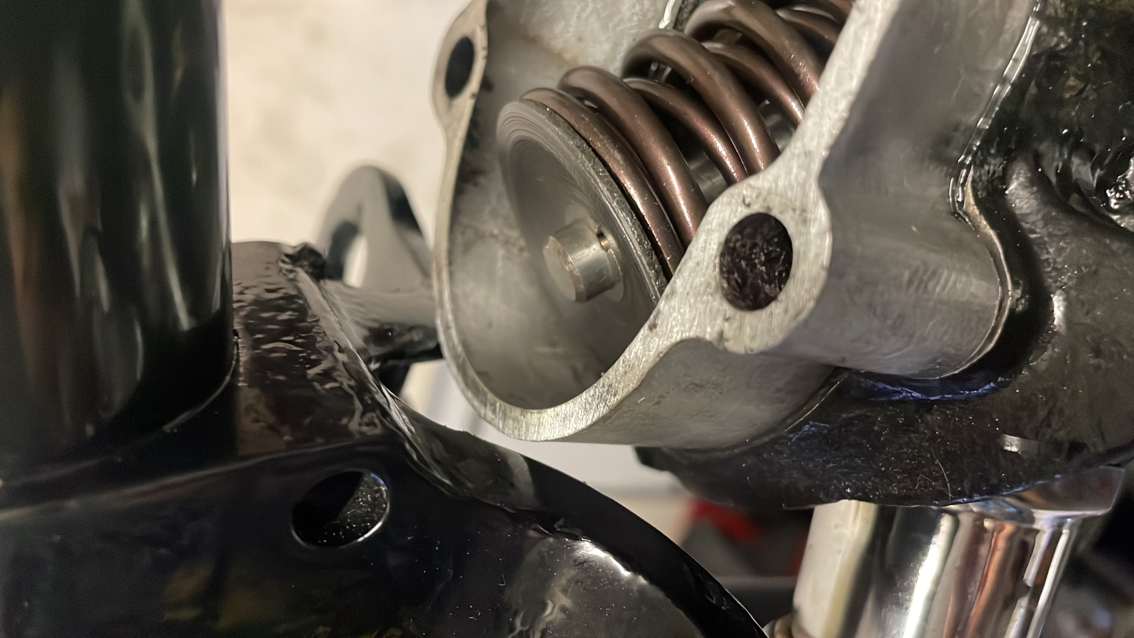

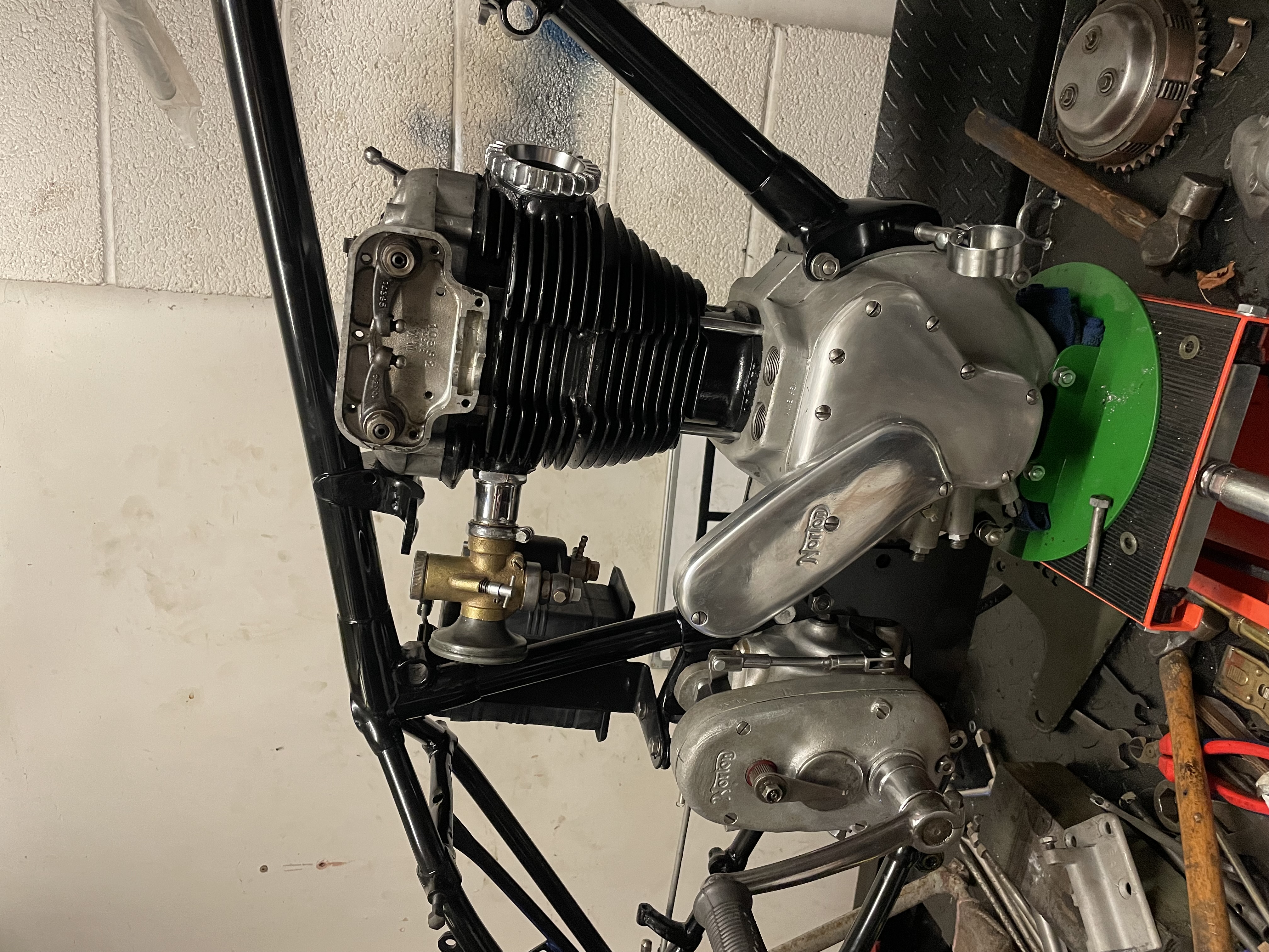

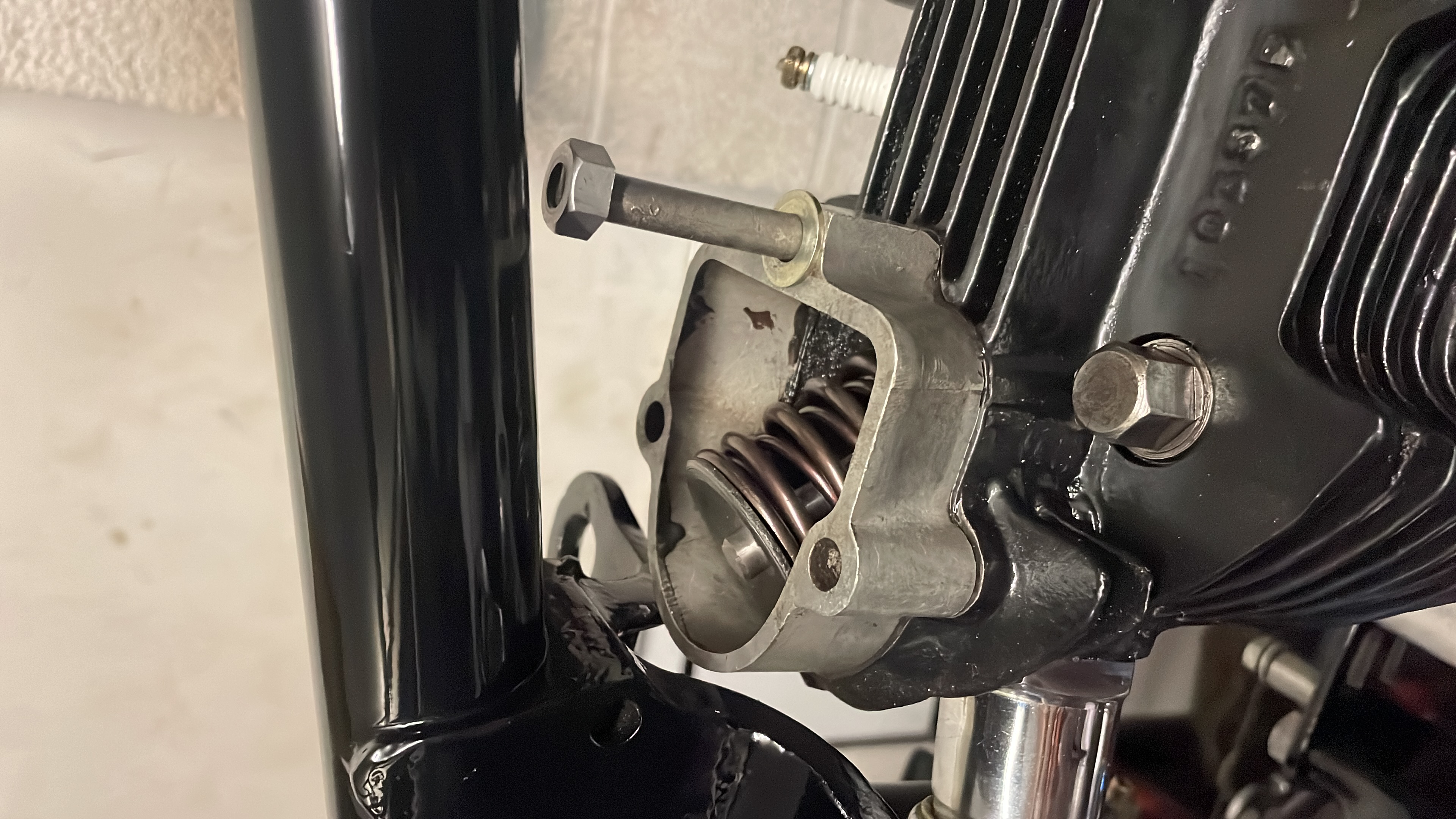

on my project bike there is absolutely no gap so I've had to drop the engine to get the rocker box off, which I did take off and put the engine back up onto the mount again. There is just no room the bolts are correct diameter and everything is fine at the bottom. It's just that there is no way to remove the rocker box if I did put it on as it is touching.
when I've got the project bike, it was all mounted apart from the rear engine plate plates which were hanging off so I'm wondering if it was mounted properly,
I've had the frame repaired and the gearbox mount tube  re-tubed with the engine cases so it aligns correctly via Jake Robbins Engineering
What are your thoughts?
