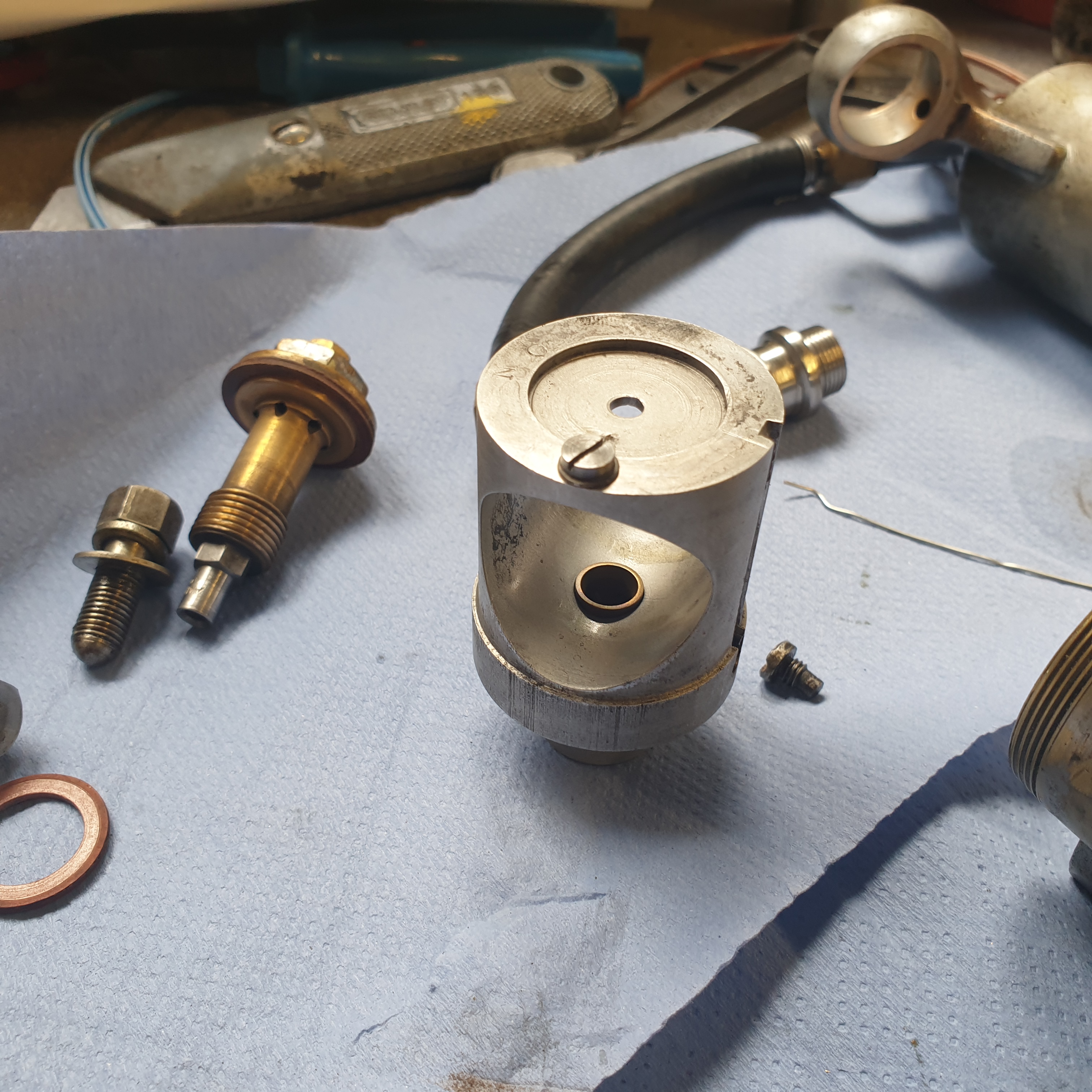

The TT carb runs great when out on the fast roads, but through towns I find the lack of tick over and tricky starting an issue. I just wanted something simple. But you can be sure I won't be parting with the TT crab and may at some point in the future see if I can modify it to give a tickover.
