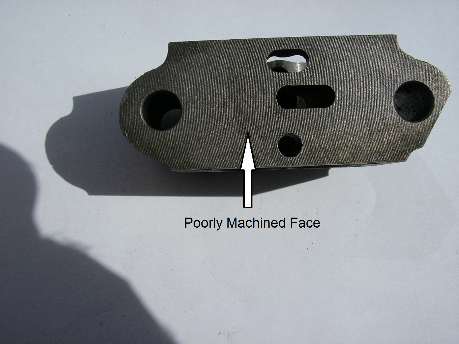

Disappearing Black Gold
If you cannot go at least 2 weeks without your bike's oil tank draining most of its contents then it is time to look for the cause(s). Generally with Commando engines the problem is down to a worn oil pump. The 6-start gearing means that it is turning twice as fast as its design speed so therefore is wearing out at least twice as fast. If you have to got to 50,000 miles of use in a Commando, then you have got to the point where a refurbishment or replacement is due. Get a replacement from Andover N. Their offering has been redesigned to eliminate all the flaws of the AMC rubbish and for the money could save an expensive engine failure. Next check the timing cover oil seal. Like all similar seals within a Norton engine/gearbox age and usage will take their toll. Replace it with a good quality dealer supplied item. Always fit a gasket between the respective oil pump and crankcase faces. Again heat and ageing can distort either or both. The gasket will help sort this. Below is the mating face of a Commando oil pump. This is the finish from new.
![Pump](/sites/default/files/inline-images/Poorly%20Machined%20Mating%20Face_0.jpg)

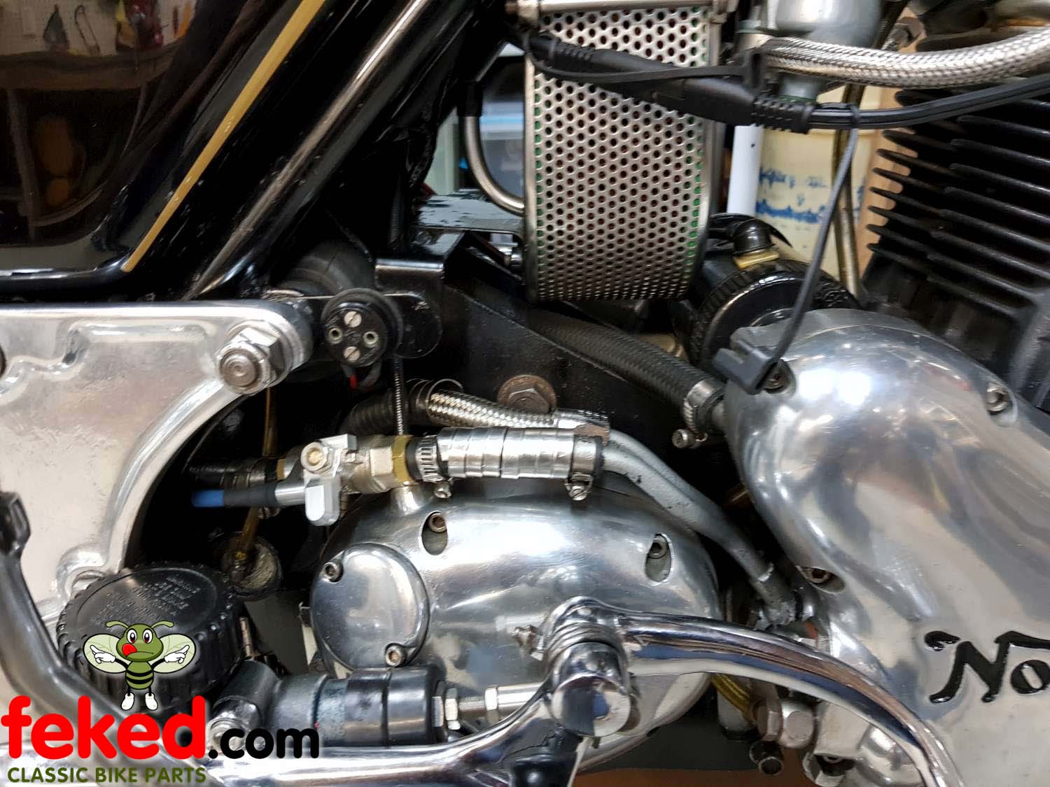

Tap with switch
A quick search found this https://www.feked.com/anti-wet-sump-oil-pipe-tap-with-switch-magneto-or-coil-ignition-systems.html
I think there is other suppliers and don't know quality of this one.
