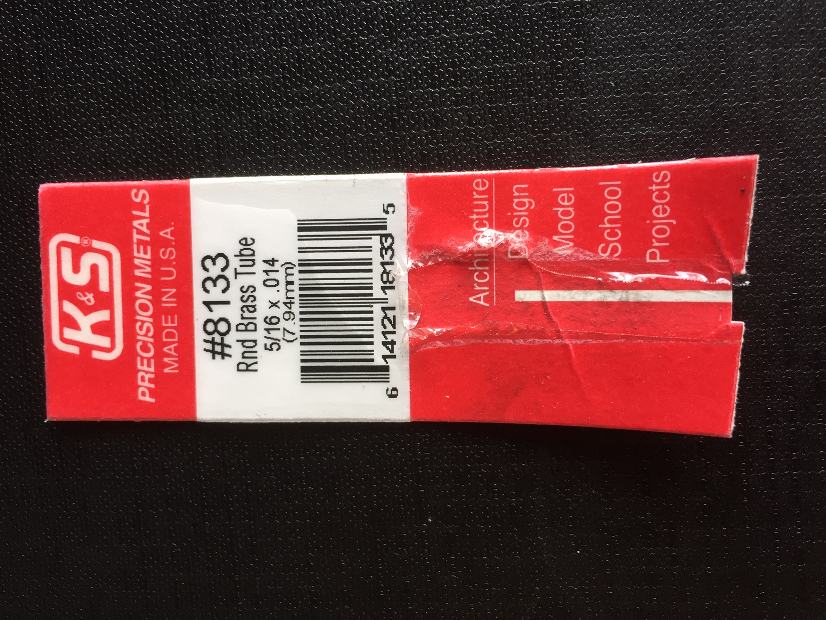

Well after a busy Easter I have finally got round to solving the Navigator's electrical problems. A careful check through the charging system proved that the original, ancient and very battered Wipac 6v alternator had finally died and the modern rectifier / regulator had failed (perhaps as a result) so I bit the bullet and bought a modern Lucas rectifier / regulator and a two wire RM21 and fitted both which has solved the problem. As Alan points out the original Wipac rotor is slightly undersize giving a circa 12 thou gap but the ammeter is showing a healthy charge rate so it isn't an issue. As for the studs being undersized for the holes they are so I sourced a length of thin copper tube from my local model aircraft shop for £1.25 and cut three spacers which fitted perfectly so no need for stepped studs! With the higher output of what is now a late 60s 12v system I am going to experiment with higher wattage headlight bulbs (60/55W H4 Halogen pre focus?) so perhaps I will actually be able to see at night which will be a revelation! Thanks for the advise - it really helped sort this quickly. Nick

Hey Nick, cut me 3 sleeves off your length of tube and I'll gladly pay for the tube and postage!!.

Hi Robert, sadly I've used…
Hi Robert, sadly I've used all the remaining brass tube (not copper as I stated) tube on another job but it is readily available either from Hobby Hangar in Yeovil (01935 422400) or perhaps quicker if you don't live near from ebay for a couple of pounds. I searched using K&S Copper tube #8133 5/16 x .014 and quickly found some for £4.25 from a dealer near Drifield in Yorkshire called flying-tigercat / Cottage-Craft-RMCE. I have attached a photo of the packaging which luckily I hadn't thrown out! Good luck - I found it was a perfect fit over the studs on my Navigator and into the holes on the Lucas stator and centralised it over the rotor without any more fettling. I hope that solves your problem! Nick
