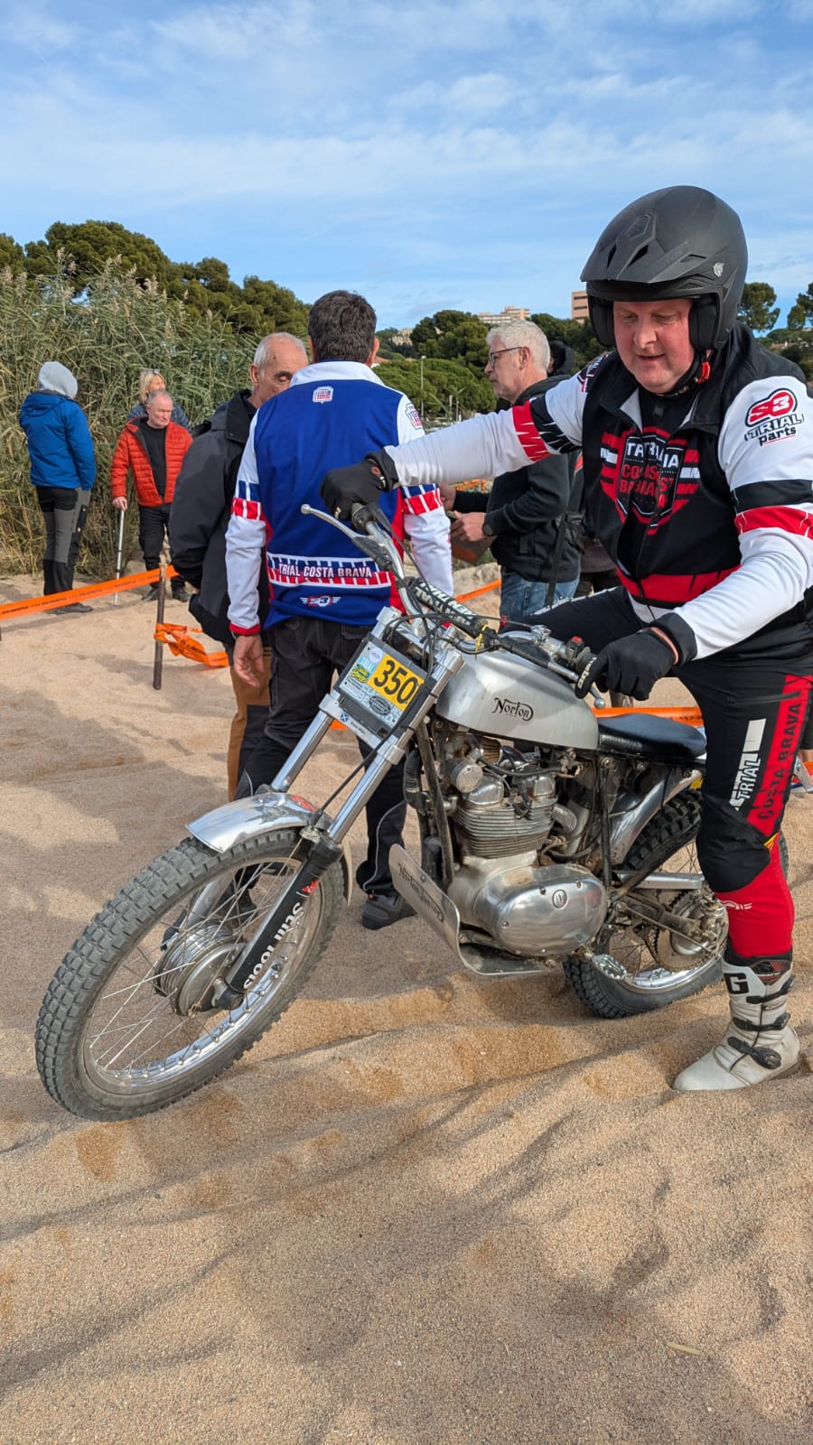

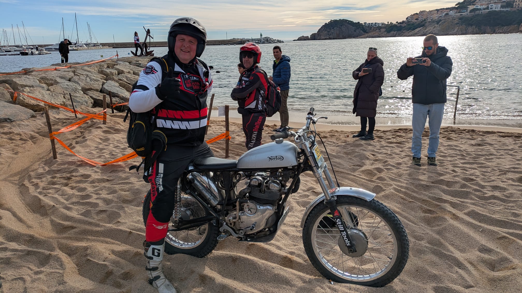

Friends of mine recently ran into this fine Navigator participating in a trial event at the Costa Brava, Spain. Rider is Kevin White? Notice the cylinder head rotated 180 degrees.

Seems to be the same bike Ian
The article you refer to mentions Kevin Smith as the rider, (creators son), and there are so many bespoke items (sump shield, points cover...) that match I'd say it's the same machine. Nice long intake for higher torque and clear of the water. Though I do like the idea it was done to clear the exhaust away from the down tubes. Nice thing...

Looking closely at the barrels it has got seven fins so it is a Navigator engine.....or a heavily modified Electra engine without the electric starter or primary side.
Having the carburettor up…
Having the carburettor up there makes the tickler more accessible without bending over.

The Forks look a bit like standard Jubilee/AMC forks...
...as do the hubs.
...but I have no idea what the frame is.

Yes it regularly competes at the pre 65 Scottish, a friend (whose granddaughter is British junior trials champion! and his sons both ride) met him at the Scottish a couple of years ago, there's a lot of nice work gone into that - the forks are special, I wonder if they are REH. I think the head was reversed to reduce the exhaust weight.

... for the article Andy. Those forks look like typical MP or other modern ones which most pre-65 trials riders use these days. Definitely not jubilee / Francis Barnett though.

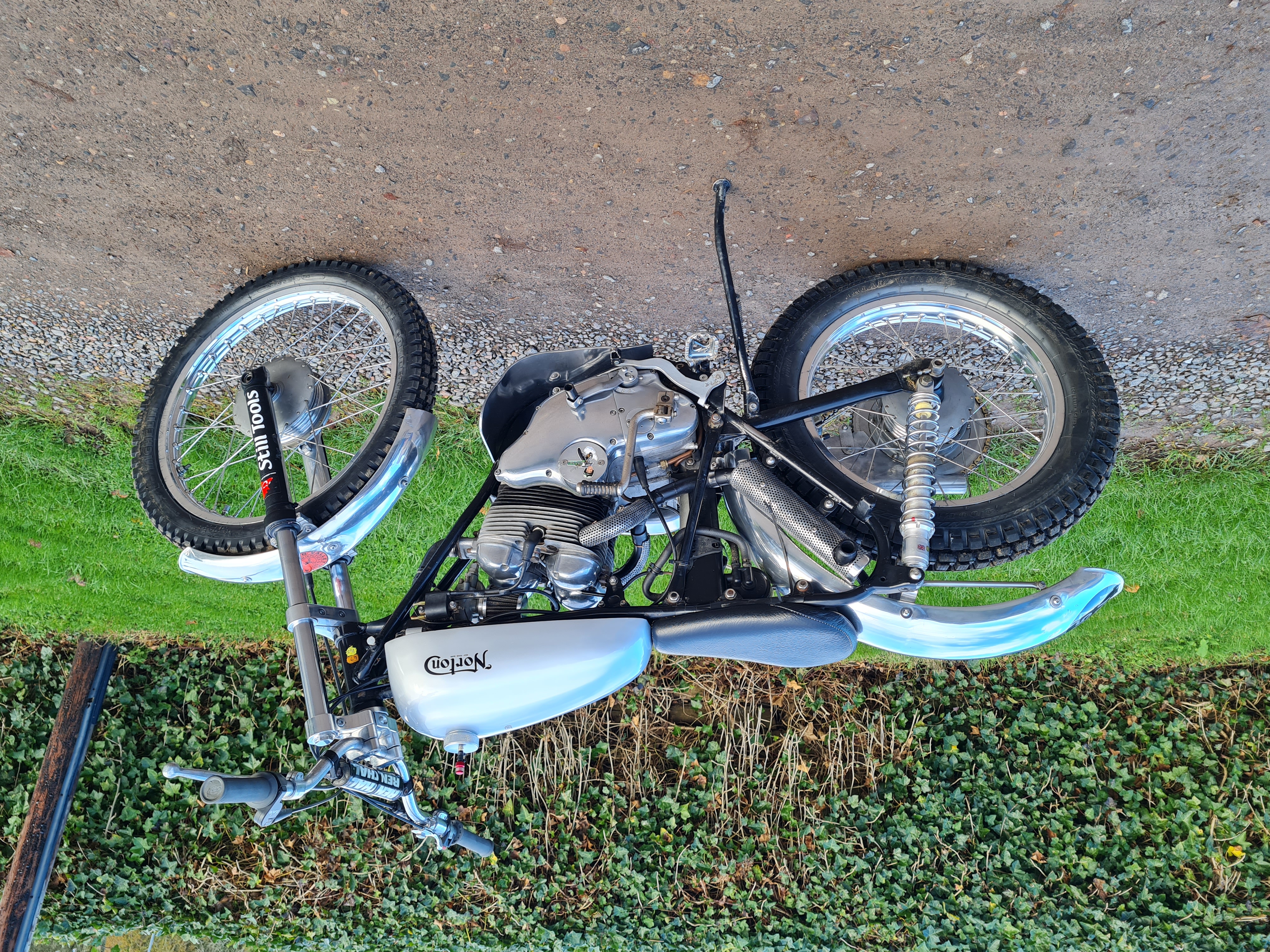

I'm responsible for the Navigator trials bike seen in this forum, ridden by my son Kevin White in numerous trials for the past few years, I'll give some details for clarification,
the engine is standard navigator 350cc, apart from reversed heads, electrix world ignition, and oil filter.
Forks are REH, as used on many pre65 machines.
Wheels and brakes are Jubilee with linings from Villiers Services.
Frame is mainly modified Navigator with Greeves front down tubes.
Despite it's weight, the bike works well in Kevins capable hands.

... why he reversed the head? That inlet tract looks very convoluted. I think there was a Jubilee in the pre-65 Scottish either this year or last, wonder if it was the same bike / rider? Yes, a quick look at the 2024 results show a Kevin White finishing on 76 points. I assume the same bike. In fact I posted here about it a couple of years ago and was told it was in fact a Navigator.
