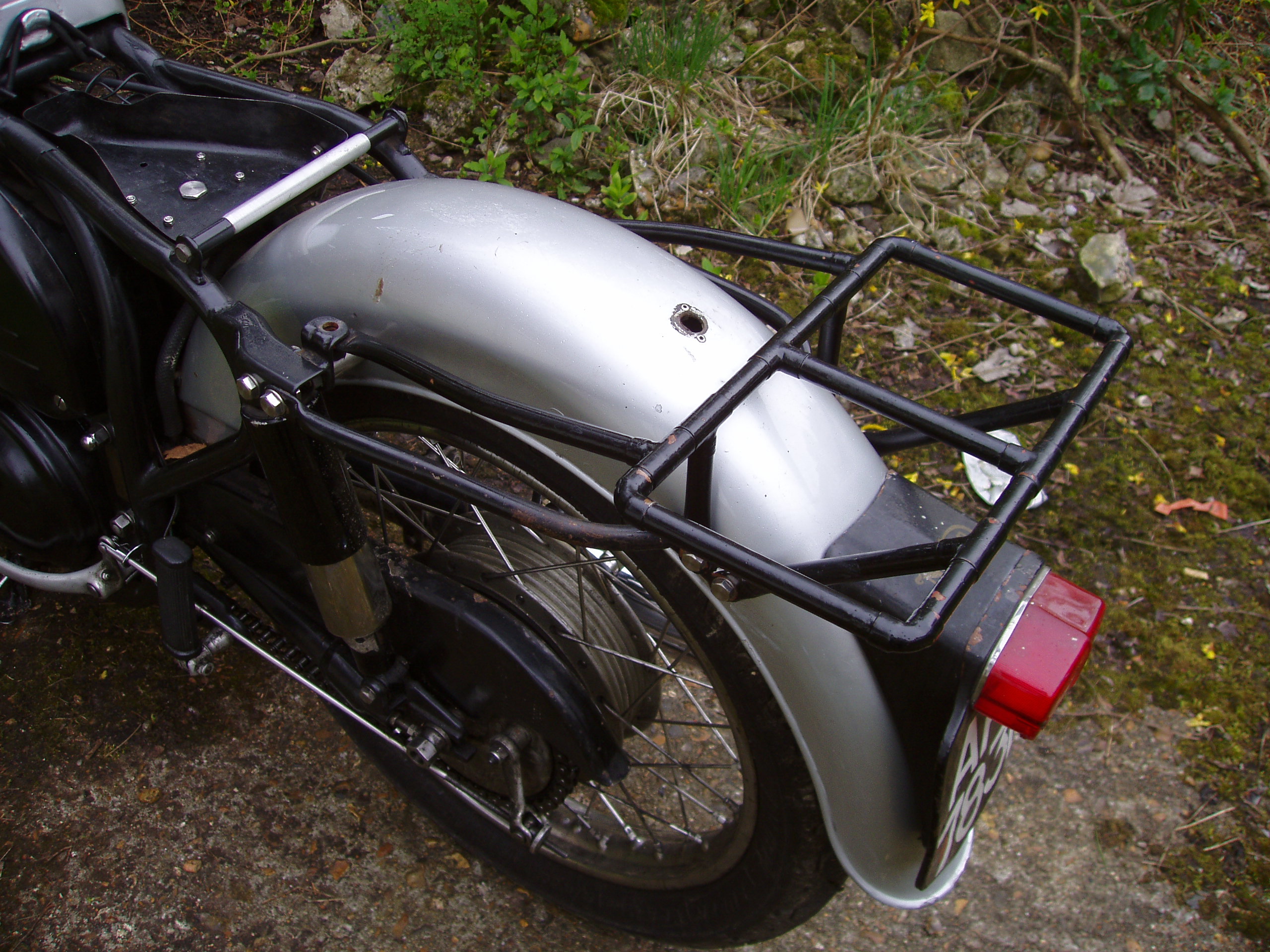

This shows the rear of my…
This shows the rear of my 1963. This has a pair of upstanding angle lugs inside and above the rear suspension supports. They are drilled to take the two pegs which project down from below the seat. The seat doesn't rest on the cross tube. Did they change between 61 and 63?
(The carrier is from 15mm copper central heating tubing, with end feed solder fittings. The two forward projecting arms are also drilled, and the set pegs hold it from moving backwards and forwards. 1/2" lengths of garden hose act as spacers on the tips of the pointed pegs.)

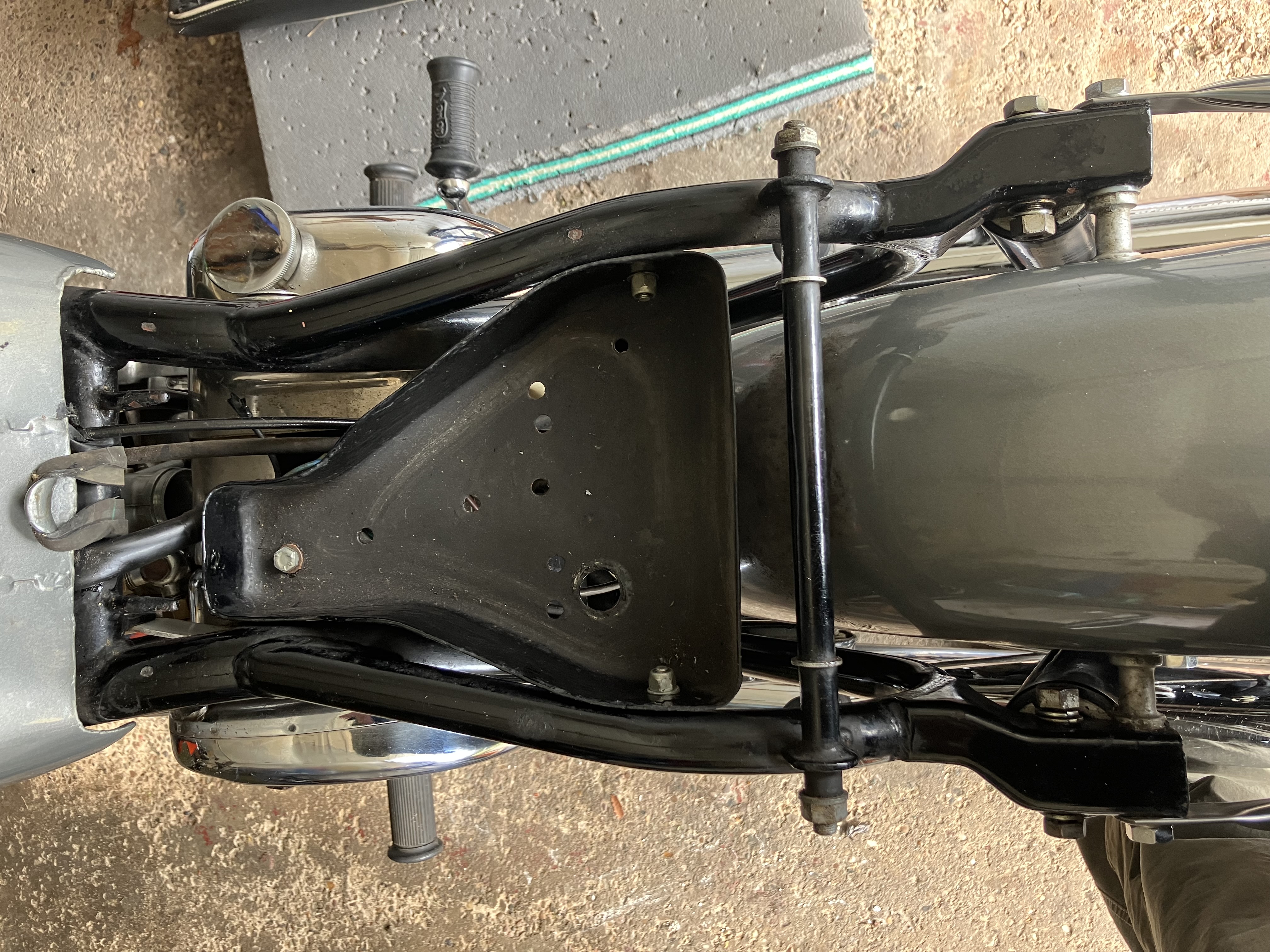

Hello Sean,
I don't know if these help, but mine's a 1960 99 Slimline Dominator, and I think these photo's may show what you're looking for?
On mine, the long bolt doesn't attach to anything on it's way across the rear of the frame, I'm thinking that it just adds strengthening support for the rear of the frame. If you want measurements, then let me know which lengths you need, I've got the tank and seat off at the moment.
