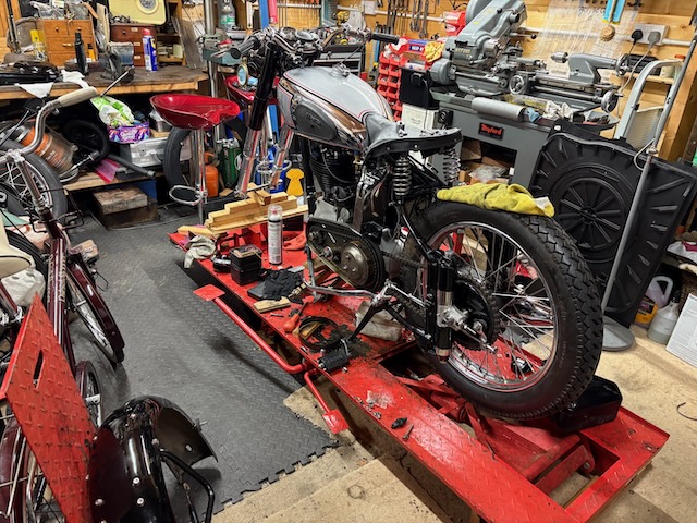

Here is a photo of my clutch…
Here is a photo of my clutch. Am I also correct in thinking the cush drive is in the clutch as ther isnt one on the crank?
Best regards,
Steve.
That's a Norton clutch....
.... and yes, the shock absorber is in the clutch centre.

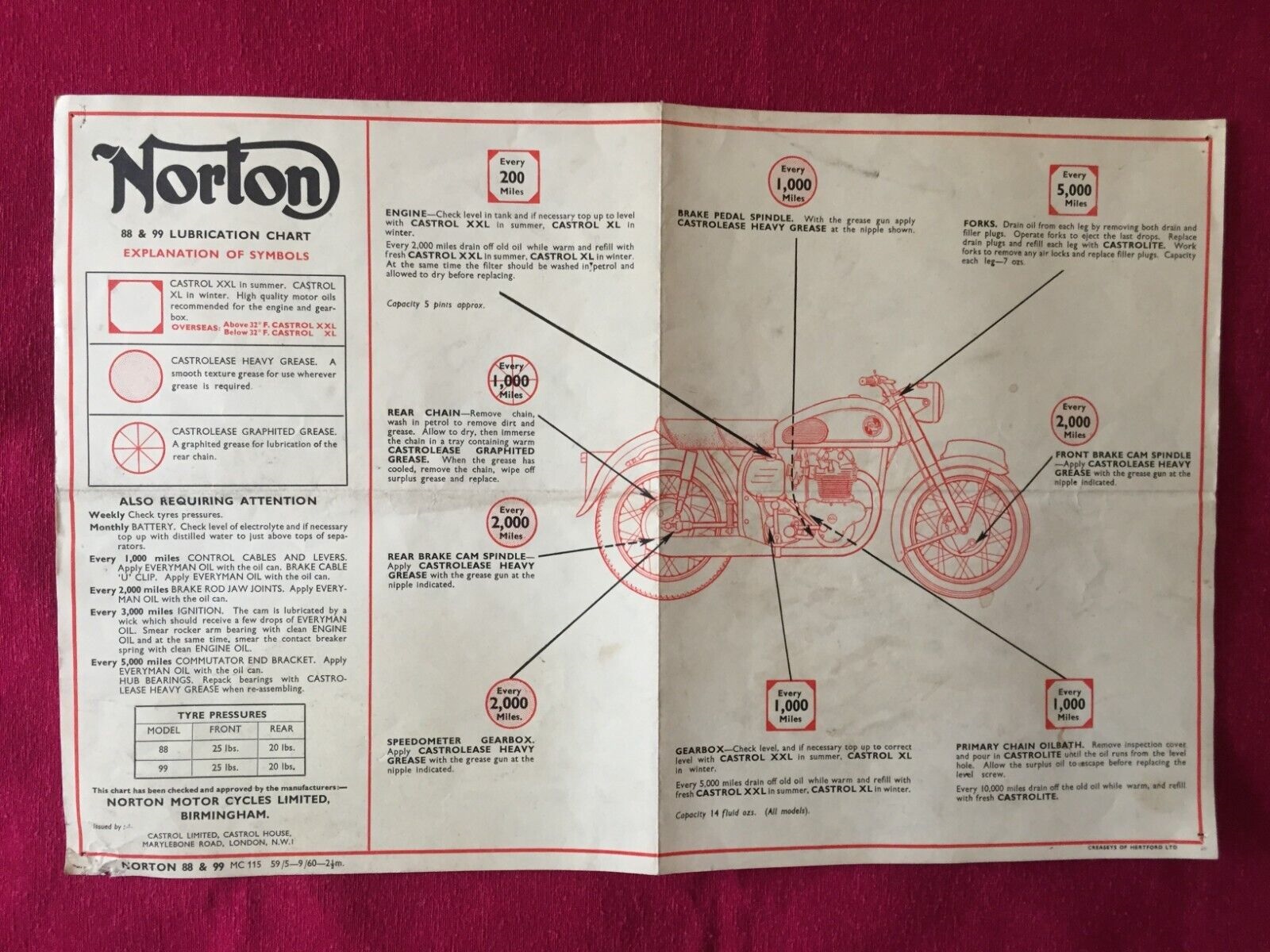

20 / 50 OILS
When 20/50 and similar multigrade oils became readily available in the late 1960s, Castrol promoted GTX as a 'one type suits all' product. They even produced diagrams showing that it was suitable for use in the engine, gearbox, forks and primary cases. It probably did not have the refinement of a dedicated EP80 or 90 oil for the gearbox but did save having lots of half opened tins of varying grades lying around the garage.
John Hudson used to swear by it and he rode tens of thousands of miles each year.
As seen below is quite a useful chart.
