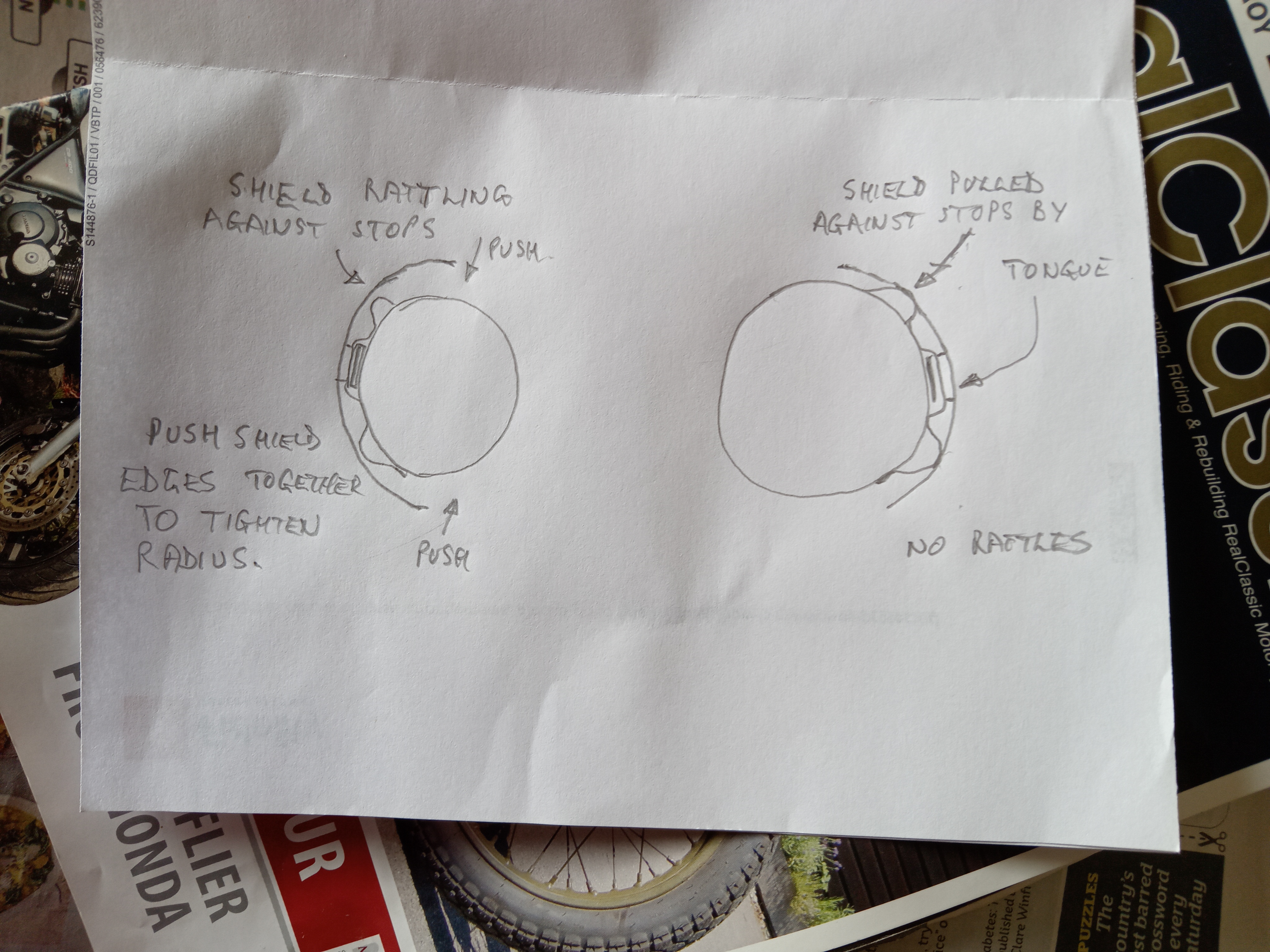

How it should fix
The attached sketch shows how the designers made things sit quietly.
The shield must have a small enough radius to ensure the central tongue pulls the shield onto the two stops on the silencer.
Same at the forward position.
Otherwise the rattles you observe.
Sadly the spot welds on the shield tongues are not so strong. A fall can break the welds or distort the shields.
The bolted tongue on James' shield is typical.
Easy to reduce the radius of the shields.
