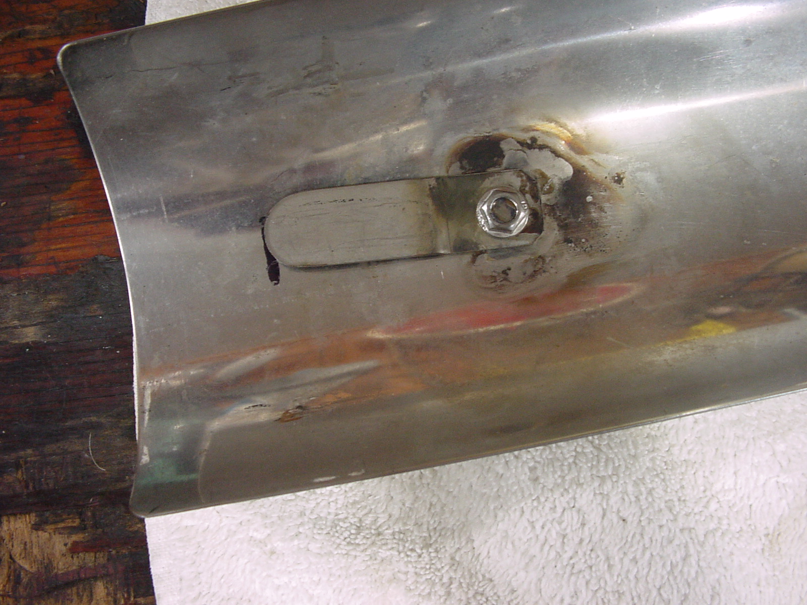

Noise ! CURED
well blow me down...it was the RH silencer heat shield . It was done up tight but the tongues at the back were a bit open. Ill pack it with some foil

Following on from above I purchased some 8mm wood burning stove door rope. This comes with a high temp glue...I cut 4 lengths and glued then to the heat shields (2 each side) internally so they could not be seen when assembled.
I used tape to ensure they were held in place whilst the glue dried then popped them on the bike for a final "cure"
So far so good. If it works I'll not post more but if it all caught fire and blew out the back I'll report!
Not sure how fixed the…

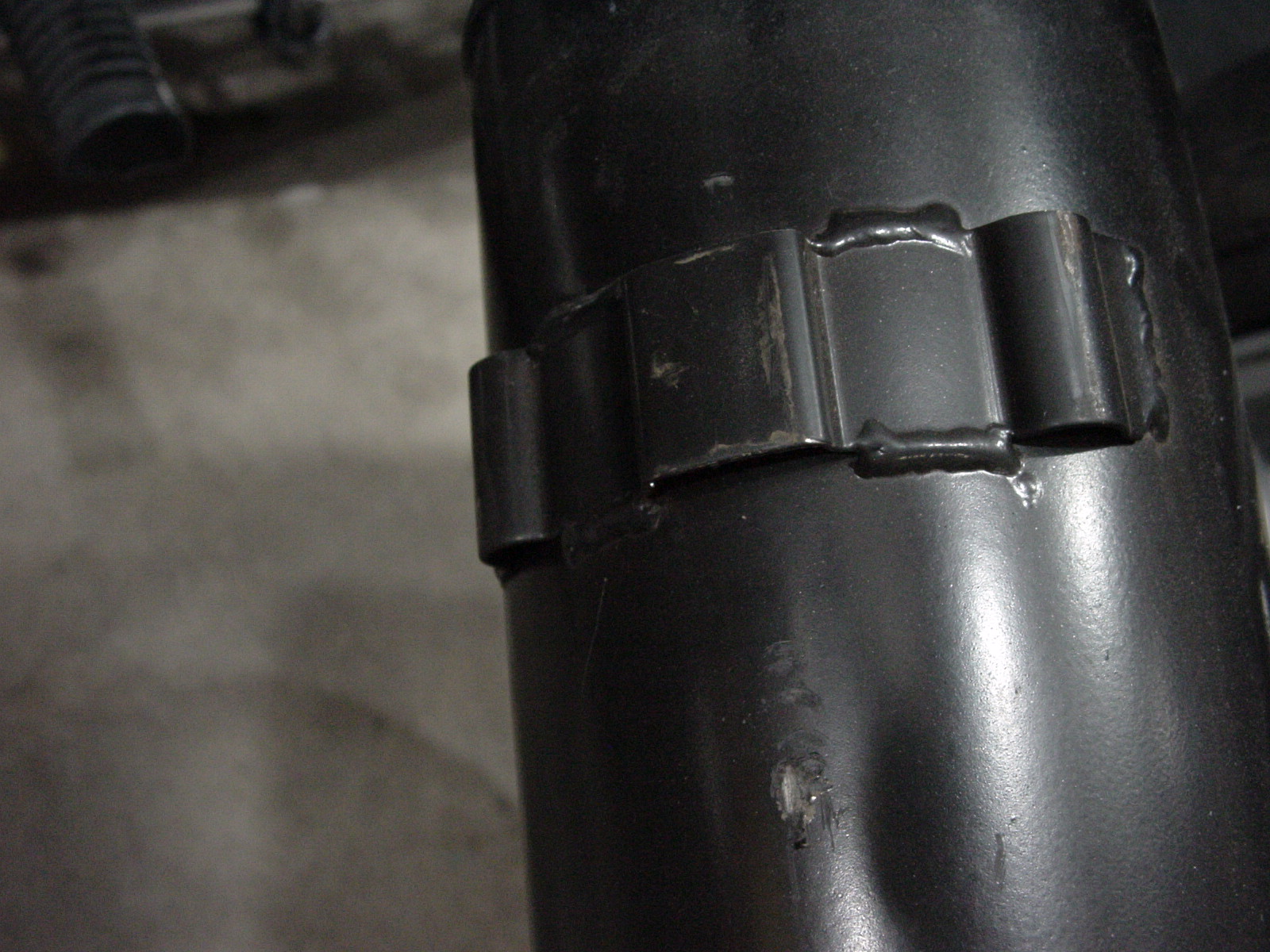

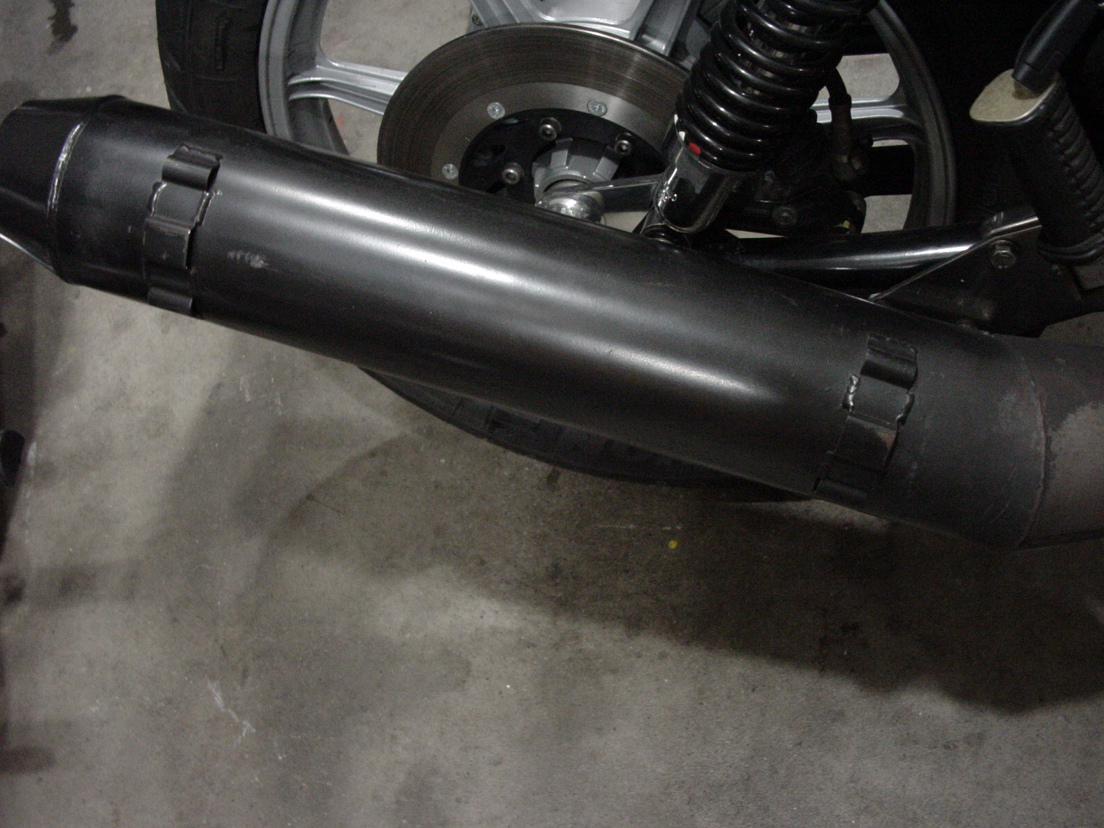

Not sure how you fixed the rattling heat shields, the mounting is pretty flimsy, forcing material into the gaps would just bend the tab.
Arthur,
Not that hole. See attached.
