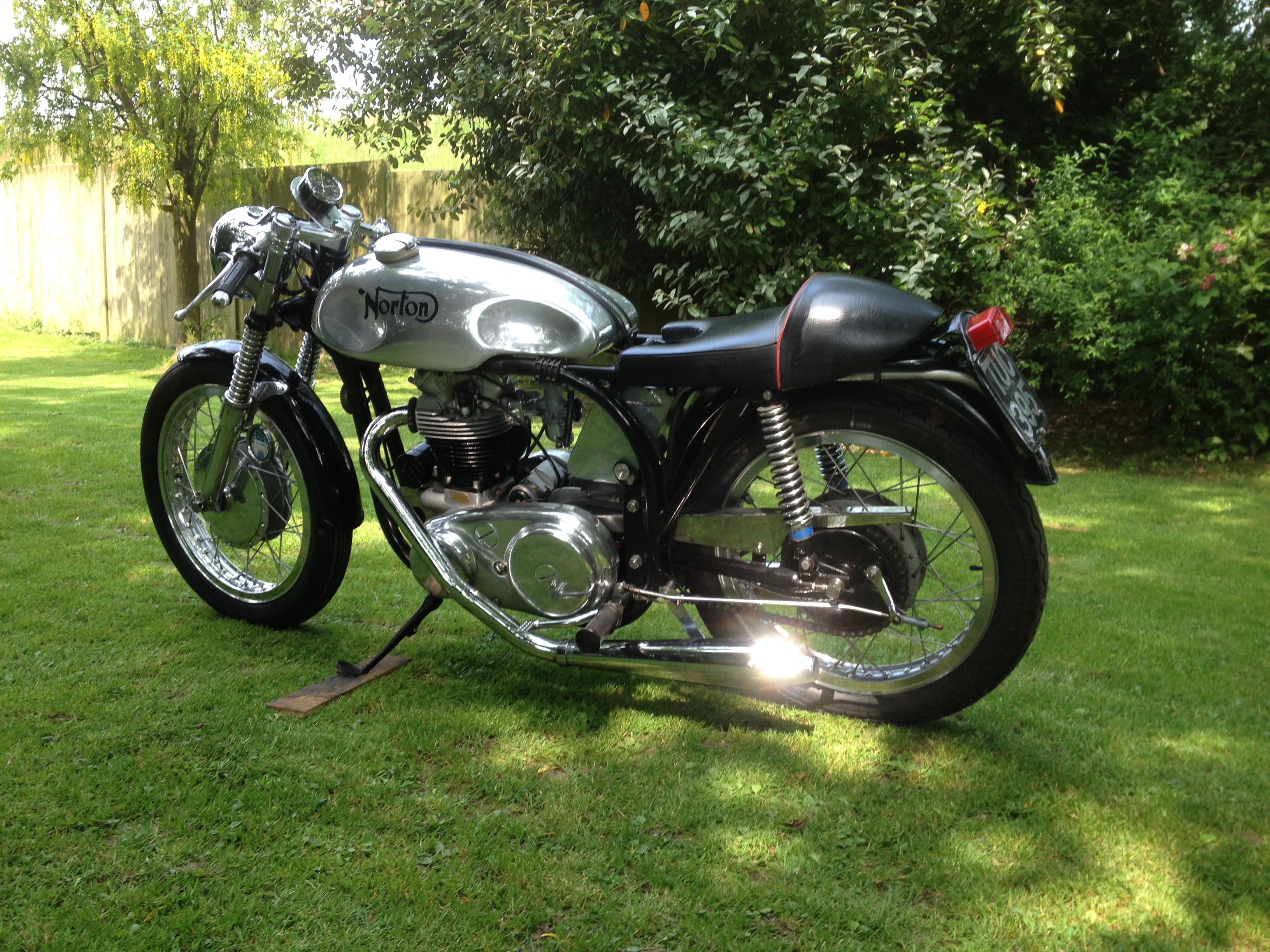

Is it possible to fit an aluminium alloy chain case to a heavy twin? Either to a Model 7 or an 88.
I'm thinking a chain case from an AMC twin or Commando? Or might there be something else? For what I have in mind either an alternator chain case or not.

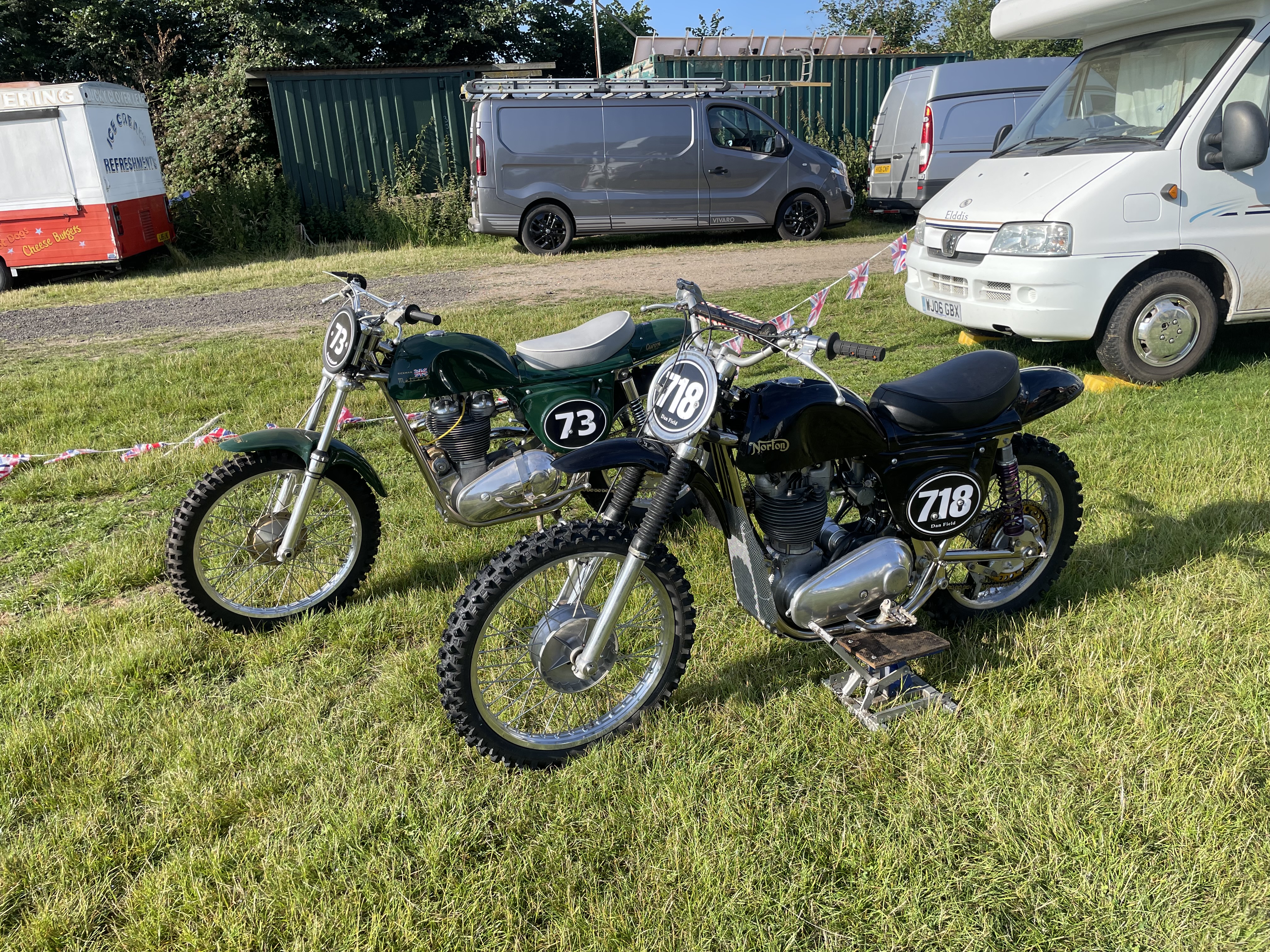

A NOC member came to the SNOC event at the Hayes village fair last year with a Dominator 99 to which he had adapted a Commando chain-case. I wrote about it in an article for Roadholder. The Atlas engine that was used in the P11, N15CS series of bikes had a different drive side crankcase to accept the alloy AMC chain-case.

I have 1956 model 99 which I fitted a commando chaincase.
In my situation the pillars supporting the commando alternator have been cut back to allow the dynamo crank and drive sprocket to function. No other mods to the chaincase were required.
I have left the engine in its vertical position but it has meant moving it back slightly in the frame necessitating larger front engine plates and an extended head steady.
The crankcase was drilled and tapped to except fixings that matched the position of those in the commando chaincase.
