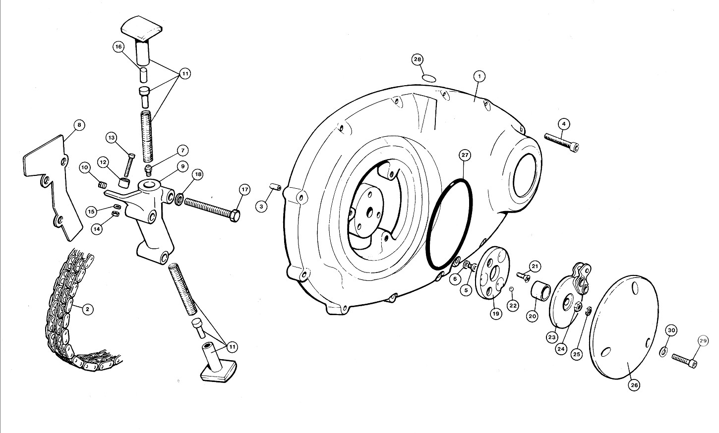

RN notes talk about priming the tensioner...how is this done??
I can remove the tensioner and strip it ....I attach the drawing from Andover Norton...is the lower tensioner layout right??...it is different from the upper
I'm rather pissed off not to find anything !
