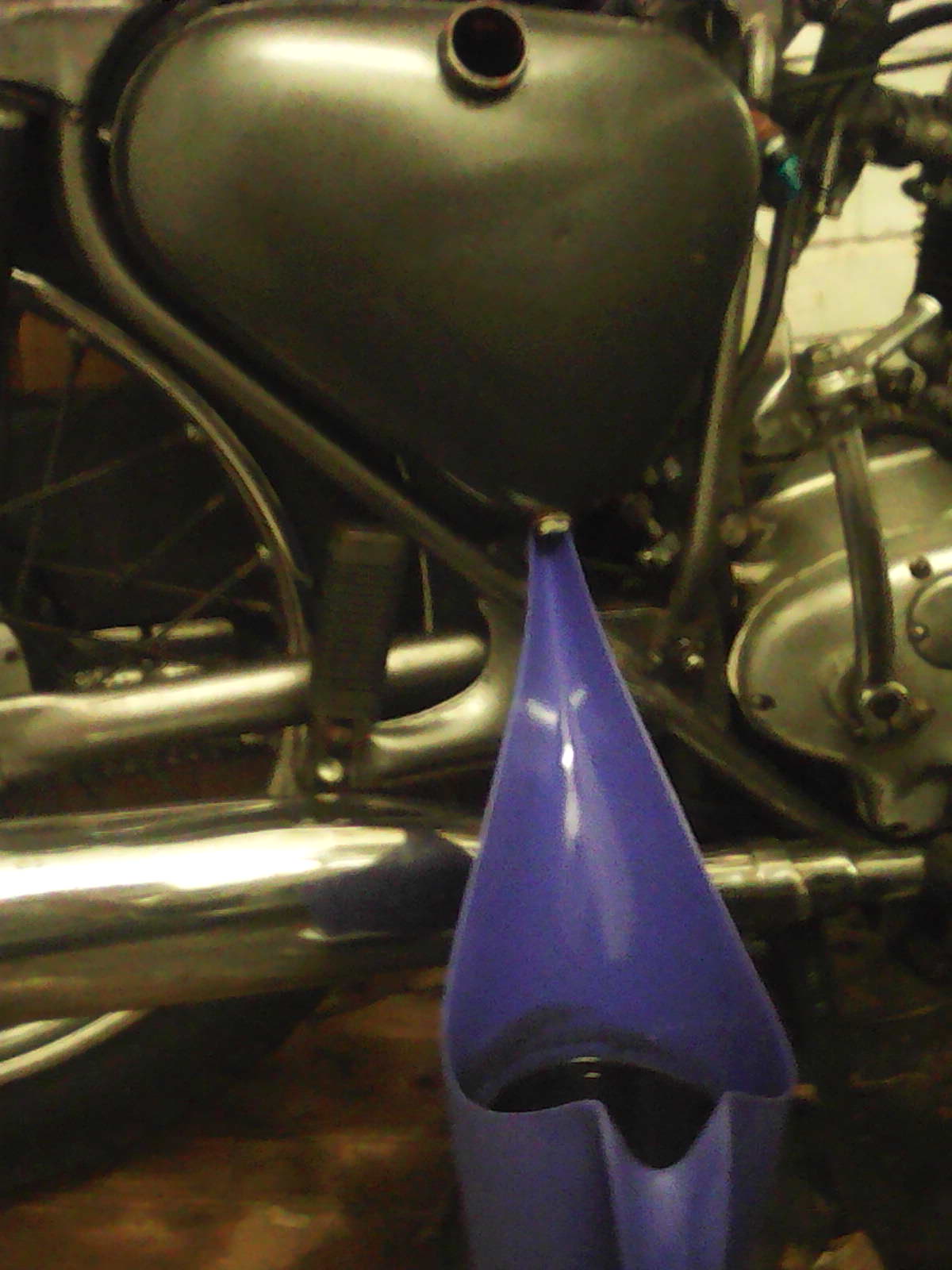

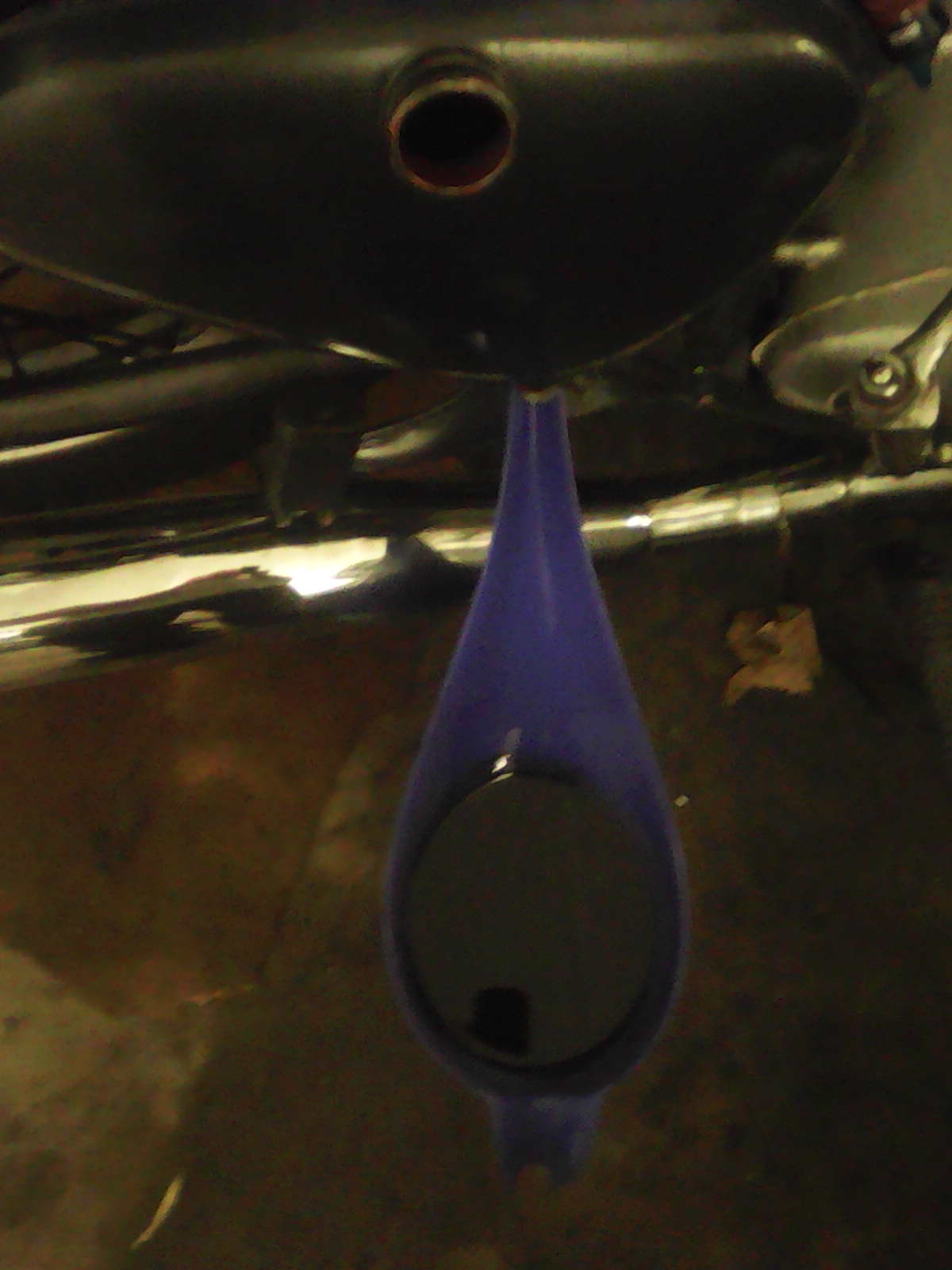

Keep it simple drive dry sump motorcycles regularly and often.If not then the time between start ups will determine how much oil has drained into the sump.If the bike is reluctant to start after a couple of kicks maybe there is too much oil in the sump. If I know I am going to lay the bike up for a long time I drain the oil in the tank into a watering can and just pour it back next trip. Also helps keep an eye on oil condition. Simple.
