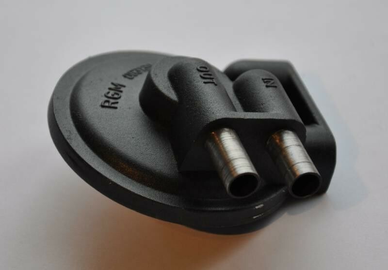

The 063139 Oil Filter Head is a common choice amongst Norton Twin owners. Most of the versions I have come across have RGM written on them.
The 2 mounting bolts or studs are between 20 to 25mm long and have metric threads. Those on my filter heads are 8mm x 1.25mm.

oil filtersMakes me wonder if RGM has changed their threads. For almost 30 years I have used 5/16-24tpi bolts on OEM norton, norvil and  RGM and never had to run a tap into them. I even use them on my oil filter brackets for slimlines. What is the thread on the factory norton bolt?
I'm sure that original Commando is 5/16" UNF as Dave says....The filter may be metric threaded, but I've not found any small fasteners to the Napoleonic standard on Commandos.
I would have said 5/16 UNC seeing as the threads are tapped into aluminium.
All of these units I have worked on or installed I have soldered a piece of wire around the ends of each pipe to form a barb to help the flexible hose stay on and stop leaks.
One other thing to be aware of, I had one case of the internal paint flaking off and nearly blocking off the internal gallery!  Not saying it was an RGM unit because I can't remember, but I make a point to scrapping all the paint off the insides now.
My filter head from NOC shop is definitely threaded M8 x 1.25; I do not know about RGM ones.

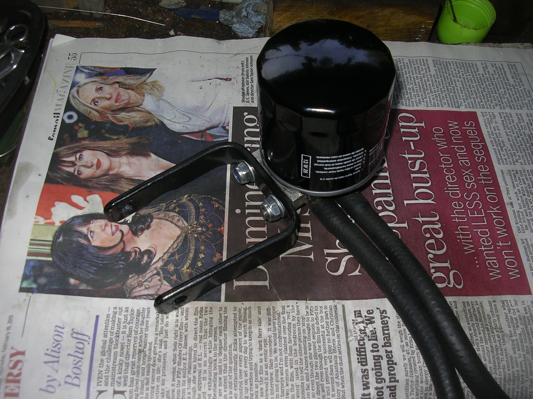

I could not use the mounting bracket supplied by NOC shop as I could not figure out how to attach it to the frame of my Jubilee. In the end I made a flat plate and attached the plate to the side stand stop bracket. The height of the filter is critical in this position because if it is too low it is hit by the centre stand when the stand is raised. I might have been able to use the NOC supplied bracket by attaching it to the mudguard bracket but space is vey tight in there.
Dennis
