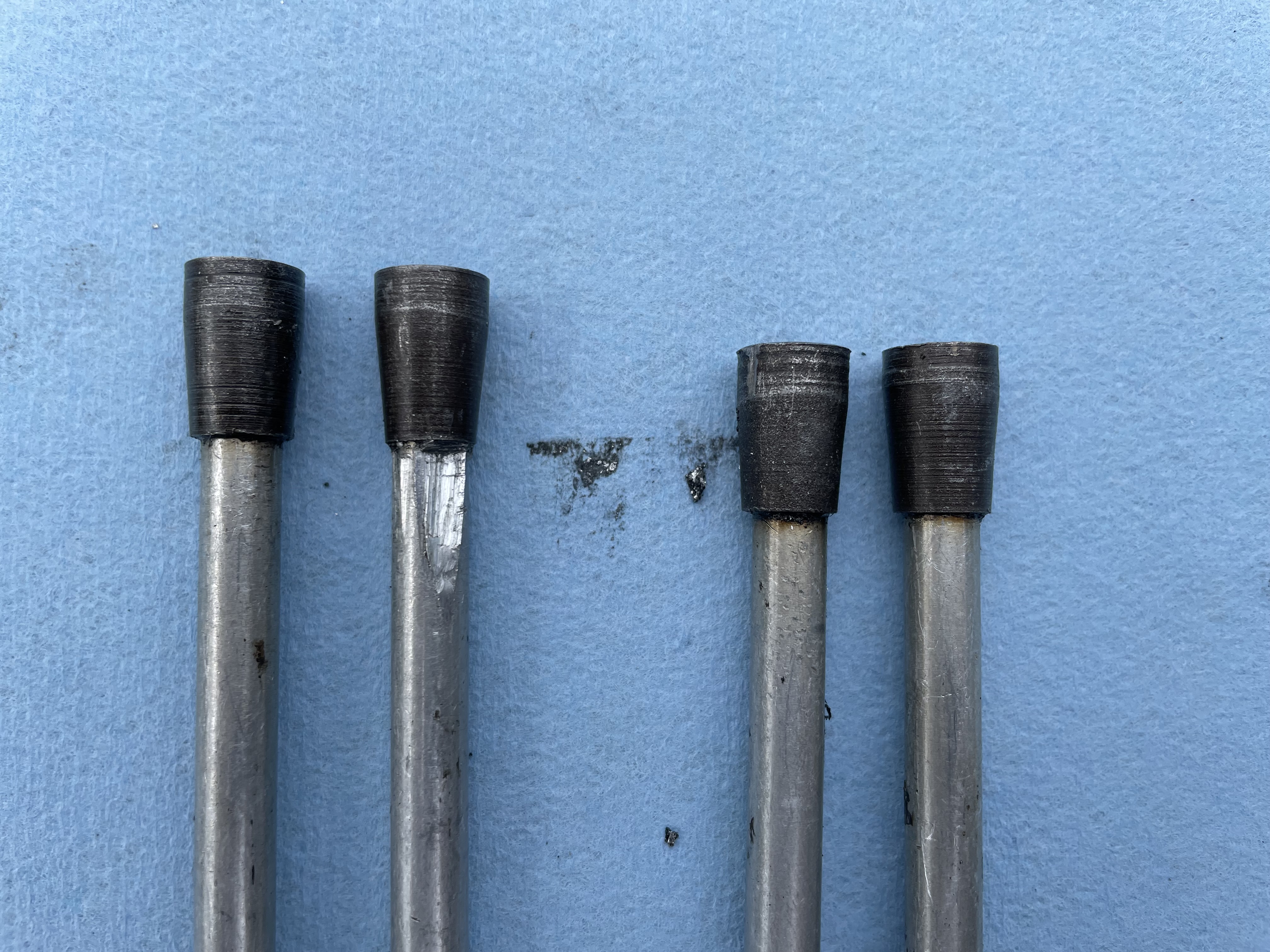

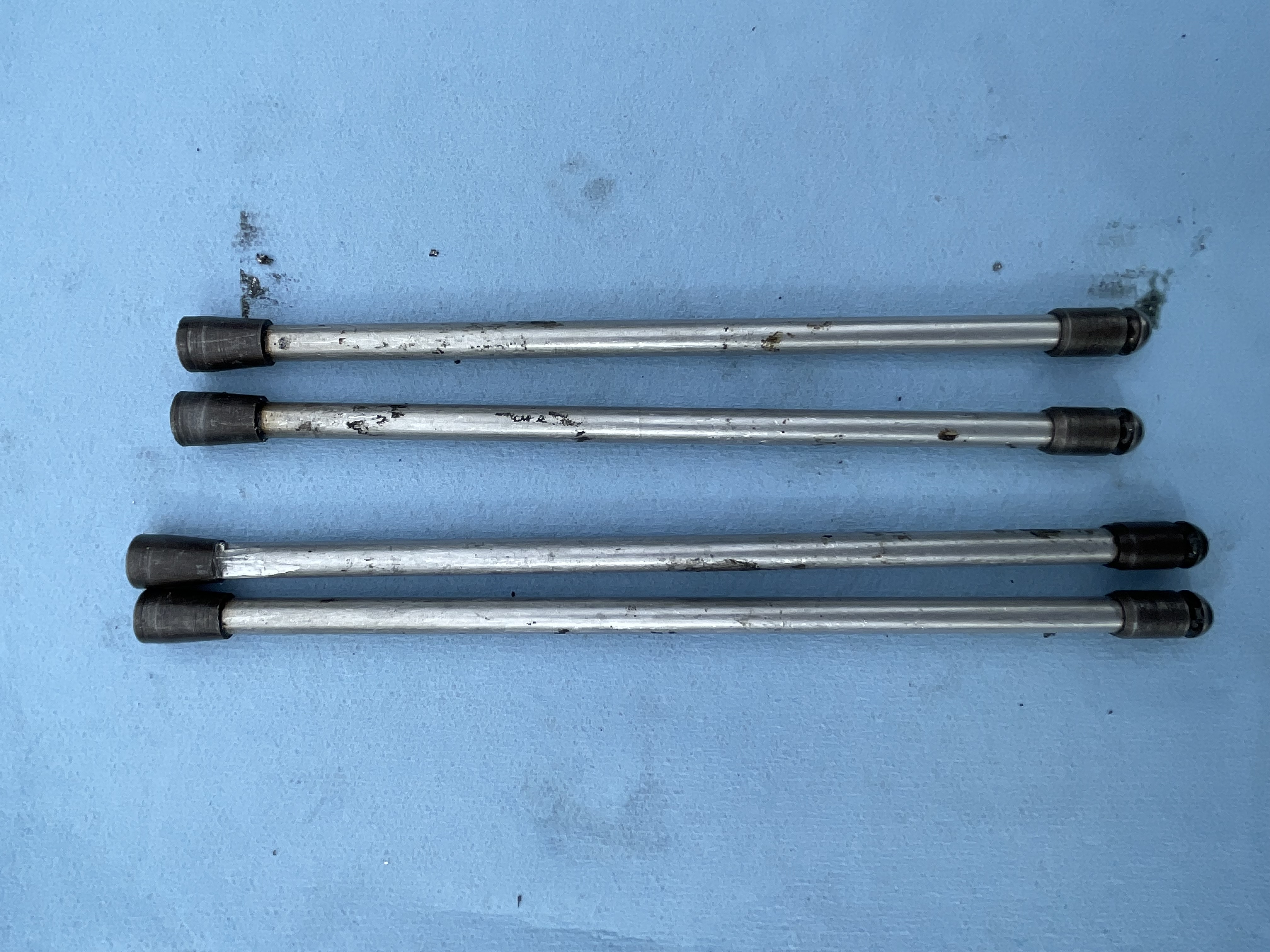

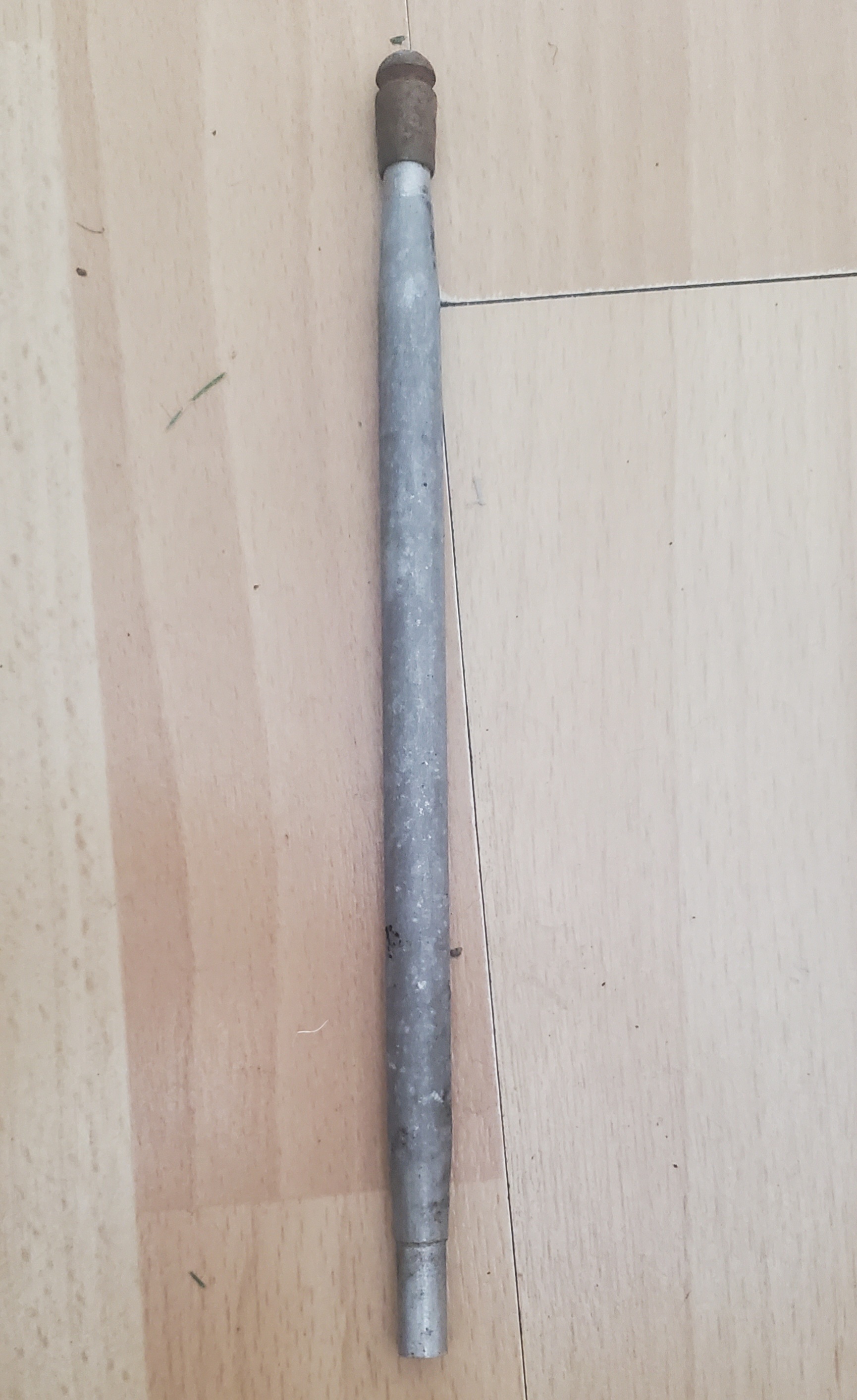

In a previous post Phillip Hannam and others pointed out that 650ss pushrods were too small for the 99 barrel. So it has proved. See photo 1 below. Aluminium swarf everywhere on the pushrods and cups.
So obviously a set of appropriate pushrods will be needed but can I use the earlier springs and slim pushrods? I've already gone to a single carb so this won't be a rocket any time soon so will this be ok?

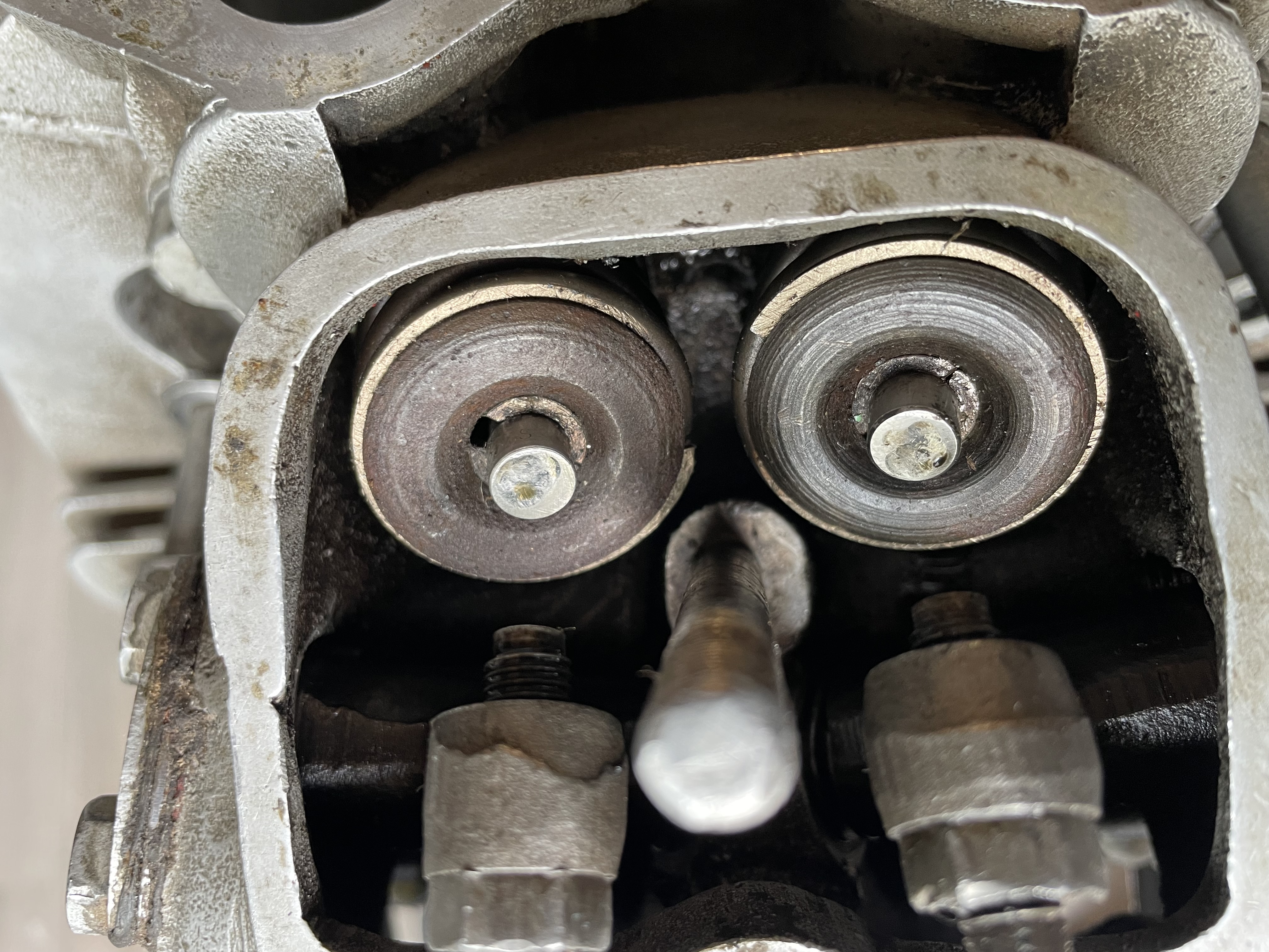

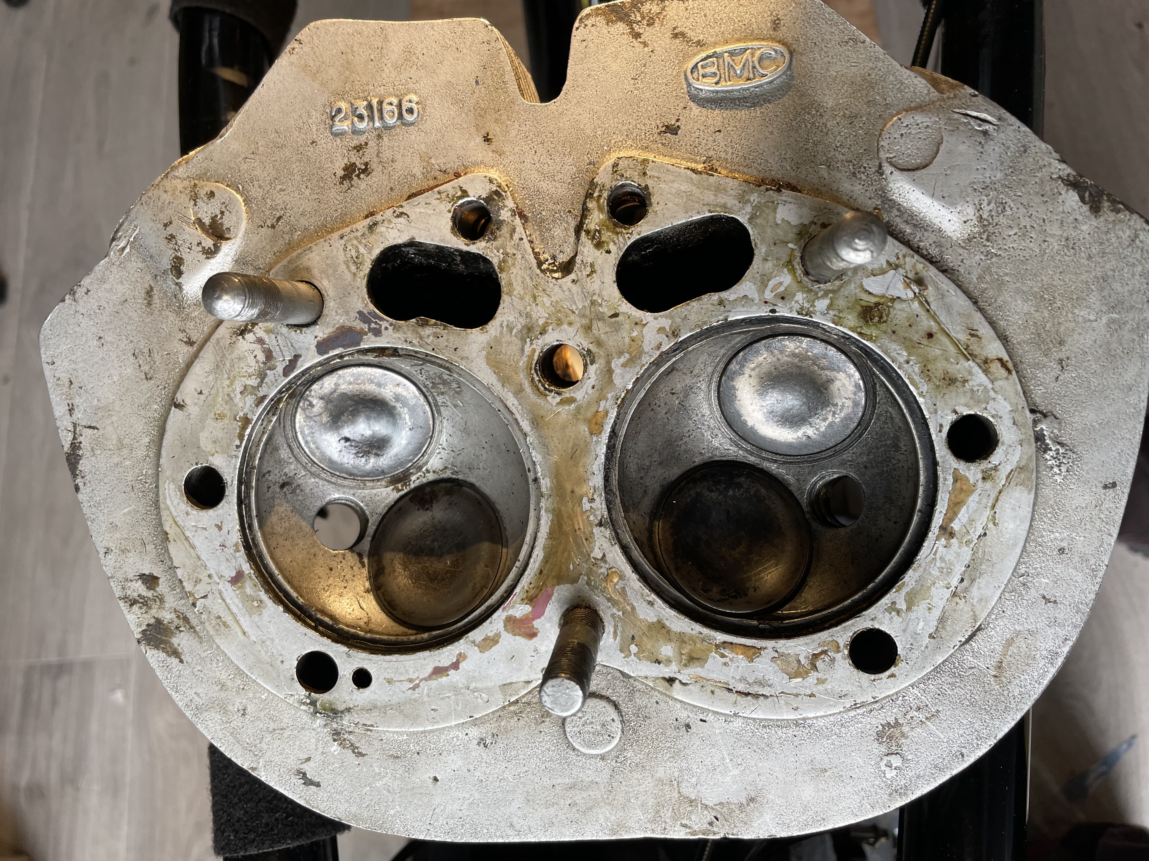

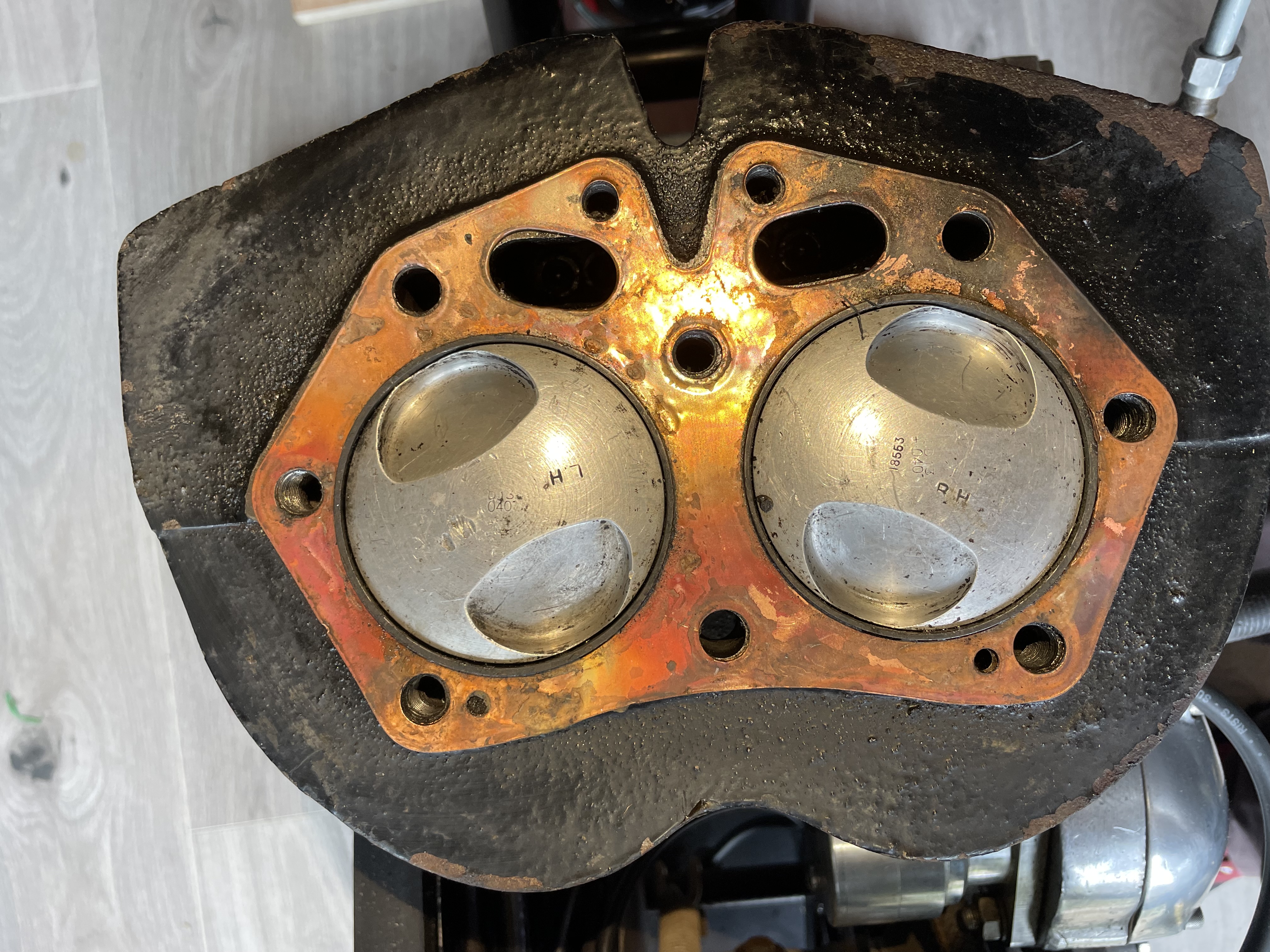

Ive included some photos of the head and the valves. Are the valve stems serviceable or are new ones needed?
Also photos of the pistons at tdc. The barrel is in great condition and I don't think the engine has ever run since this work was done which isn't surprising considering the pushrods to be honest. The gasket was copper outer with a hard inner material which seems strange. What is the best replacement? Any and all advice, comments or observations received with thanks. I don't have the funds to buy a new 650 barrel as yet but this might be an option one day. I will stick and adapt what I have for now. Thanks
The fact that the damage is so close to the end of the rod suggests the ball on the rocker was not sitting in the cup at the top of the rod.  So the rod came up alongside the rocker, and damaged its side. If the problem is the big diameter push rods, there will be scars on the side of one or more.  Did it hit the side of the tunnel, and that pushed it sideways? You won't be the first person to re-use the gasket! The engine is pretty robust.  I suspect the alloy pushrod are the weakest link and won't have done serious damage, but you'll need to inspect it I had an escaped pushrod many years ago.  Nothing else was damaged. Valve stems look perfectly normal.  They all look like that after a while. Also - my alloy pushrods are barrel shaped with tapered ends to fit the end caps.  Yours appear to be parallel.  Hopefully an expert will explain why.  But they aren't as fat as some rods.
The gasket is the best type to use although there are pattern ones about that are not as good . The fatter pushrods were introduced to cope with the stronger valve springs needed for the uprated SS cam form. With fatter rods came openned out tunnels in the 650 barrels .. I would probably use a die grinder to relieve the tunnels where they rub the rods. If you use 99 rods and dont use high revs  and retain old used  (tired ?) springs they may work. Check the valve length above the collets ,one looks longer in the photo .could be a rogue one from a later engine.Check rod length too.perhaps you have some 88 ones . Pistons are higher than std compression ,may need a little less advance on ignition
The fat pushrods are hollow tubes with tapered ends.  The waist size is 3/8".  Yours don't appear to be as big as that.  So most likely the top escaped when you tightened the head.

As I explore the head I seem to have the wrong type of rocker shafts as well as no heat insulating washers. Is this a major issue?
I've ordered some new pushrods, softer springs and some mushroom style tappet adjusters to see what I can do to sort this bit of the bike out.
You may think you have the wrong spindles ,but they may have been installed  to match a change in the oil pump drive , you need to do some reading on 6 start gears (pump)  and why they are retro  fitted to earlier engines ,and the problems they can cause.  Or not ,if you are lucky !.
Oh yes. Also, having been told I would need a rocker spindle extractor I found the spindles came out with a single tap with a slide hammer. Not one gave any resistance.  I am assuming that I will need new spindles? Everyone else seems to have to fight them out. Either that or the head is fritzed as well? Ho Hum.

Ok. So the head has been sorted and all four valves open. The valves and springs are the shorter 650ss versions but seem fine. Push rods now engage and are correct for the 88/99 barrel I.e it won't take to fatter barrel shaped 650 versions. The valve timing is set as per the various manuals. Carb has been serviced and rebuilt - using a single monobloc 376 and a single manifold as a starting point. Air is being pulled into the carb on the induction strokes. Oil pump is in excellent condition and is returning oil to the tank and head. Timing chains are correctly spaced and run smoothly. The engine turns smooth and free on the crank and there is no interference at the rotor/stator.  I have healthy sparks on both spark plugs, correct gaps and Pazon ignition is set to 32 btdc. All good you might think.

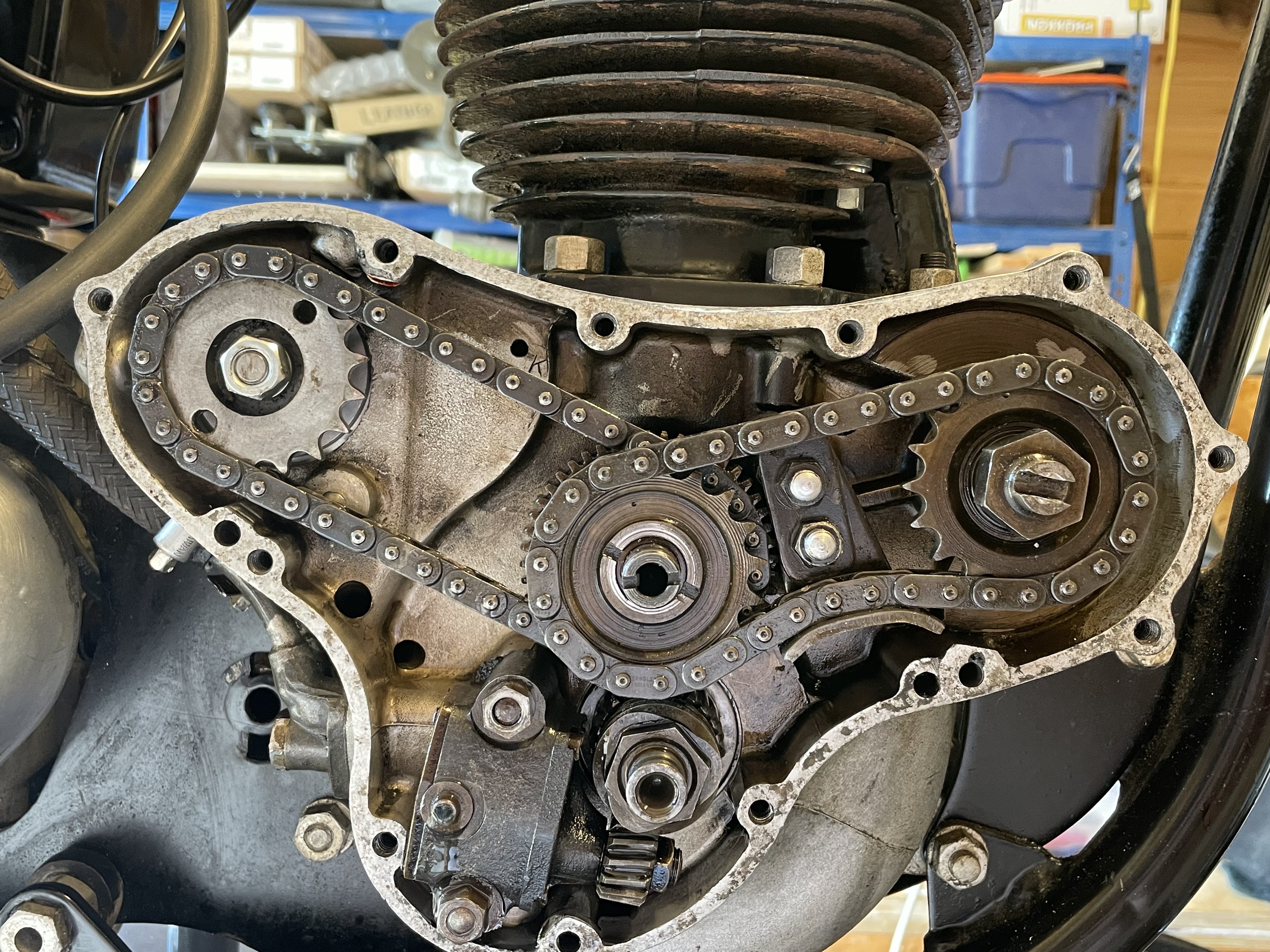

  3. Are the valves actually working in sequence? Is there a set order? How do I check?
  4. Did the previous bodger fit the b****y camshaft backwards? Is this even possible?

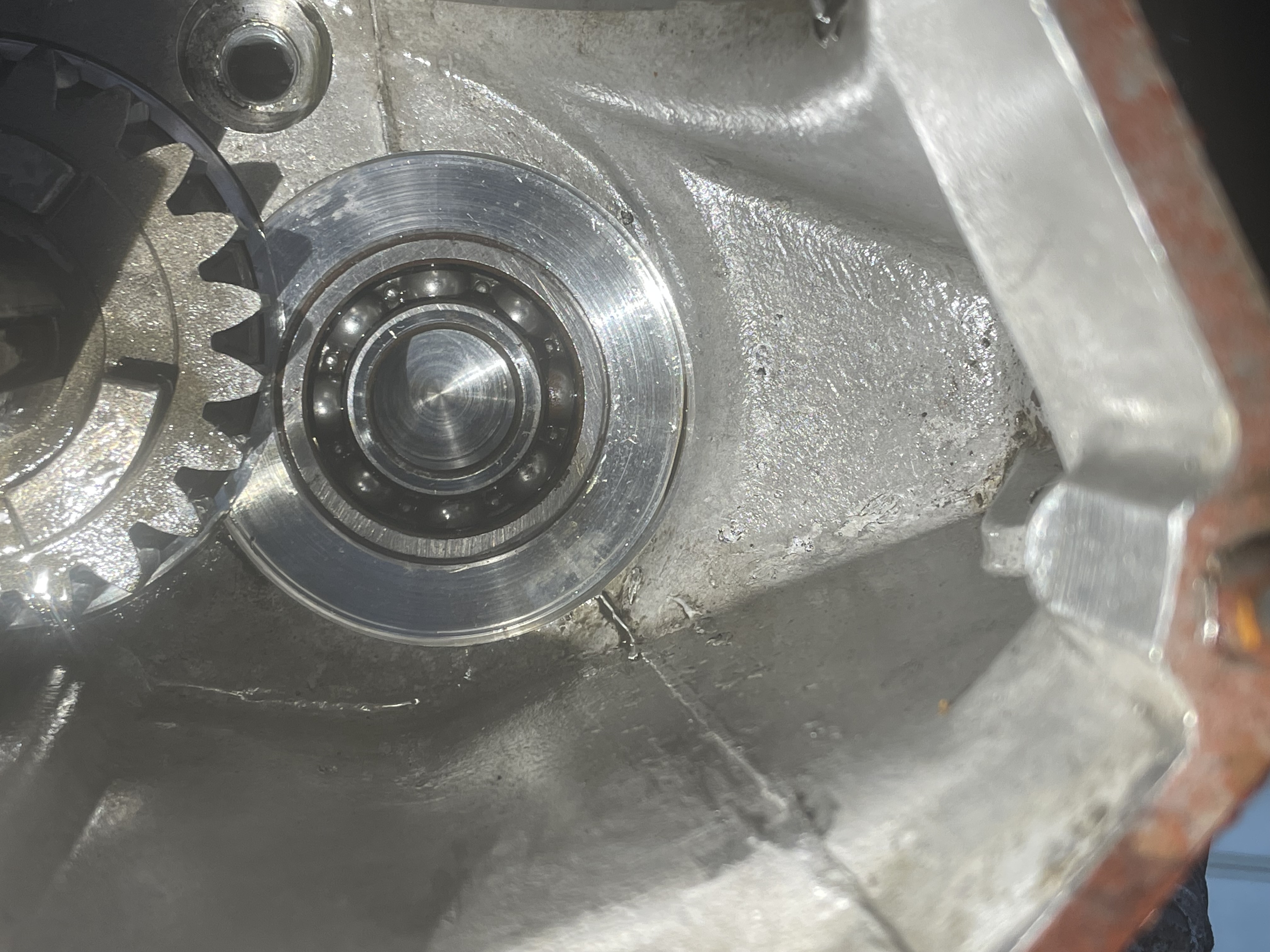

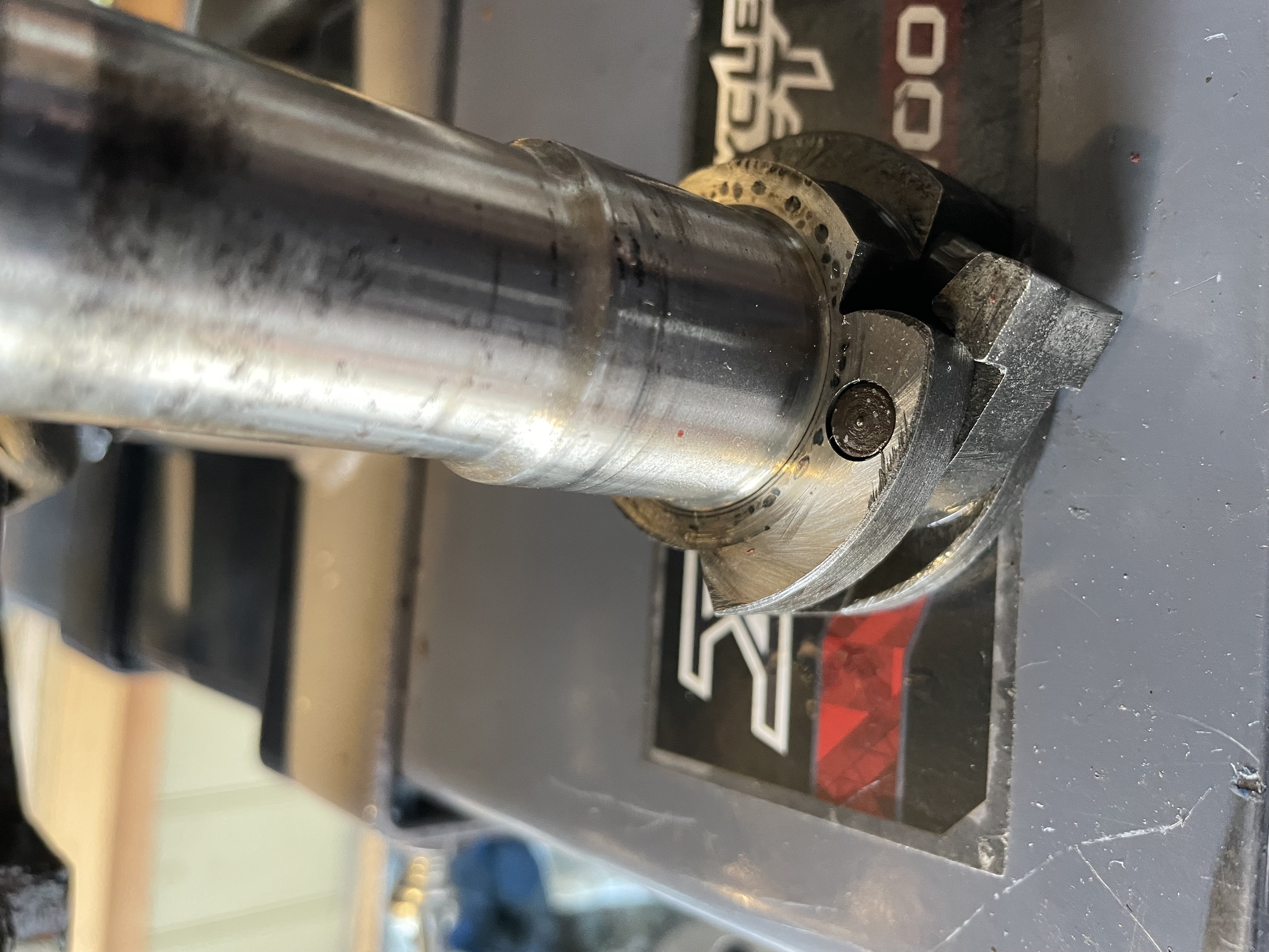

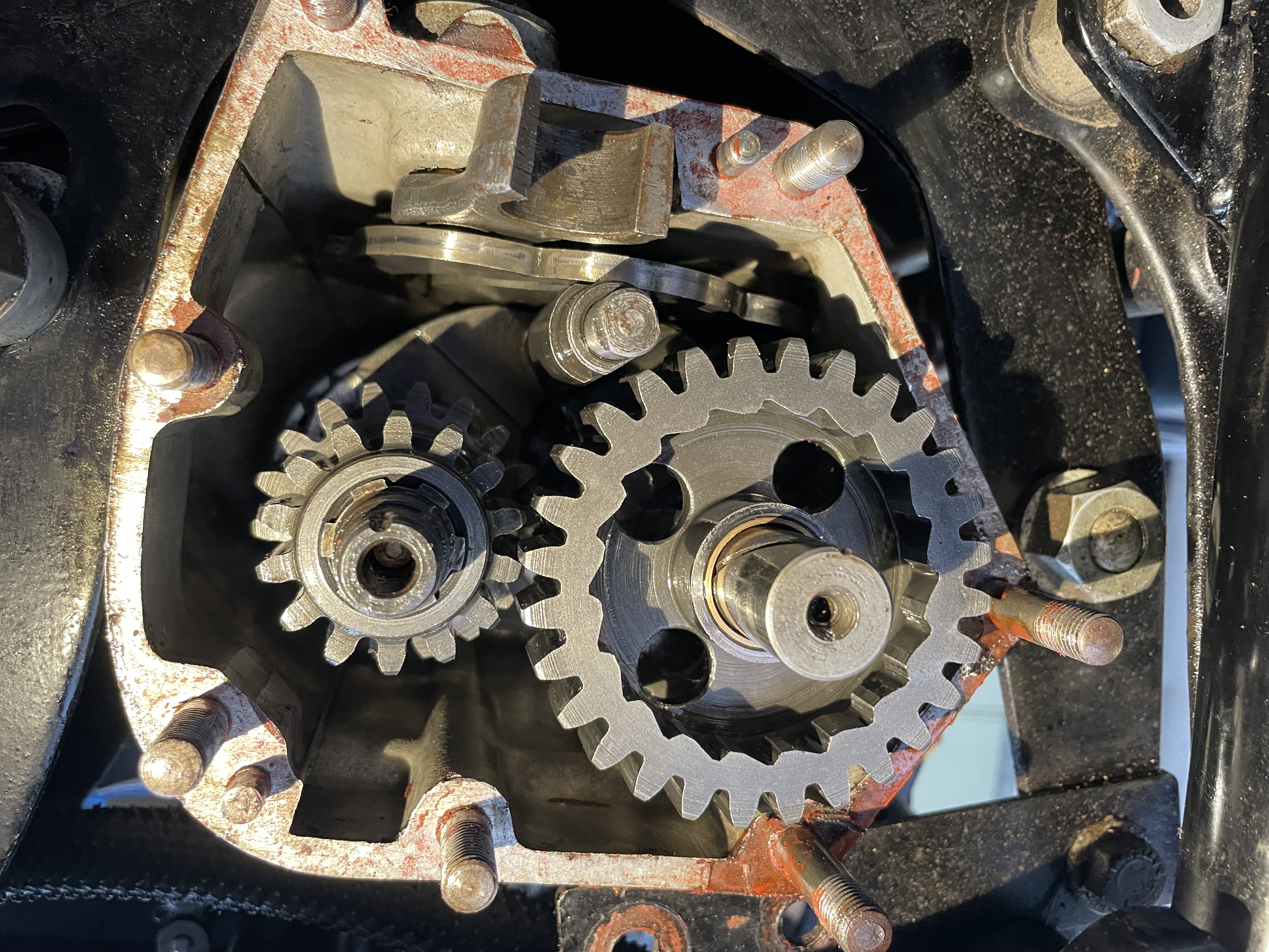

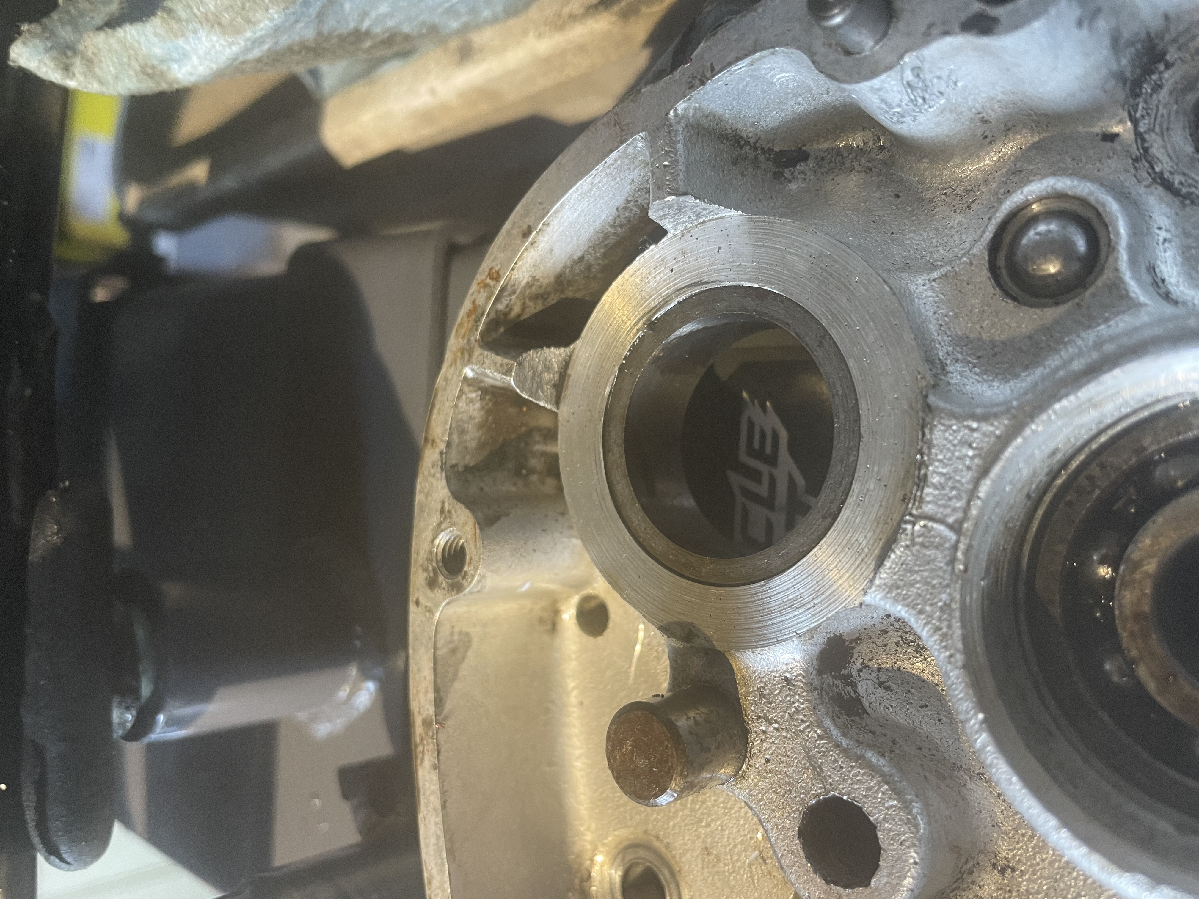

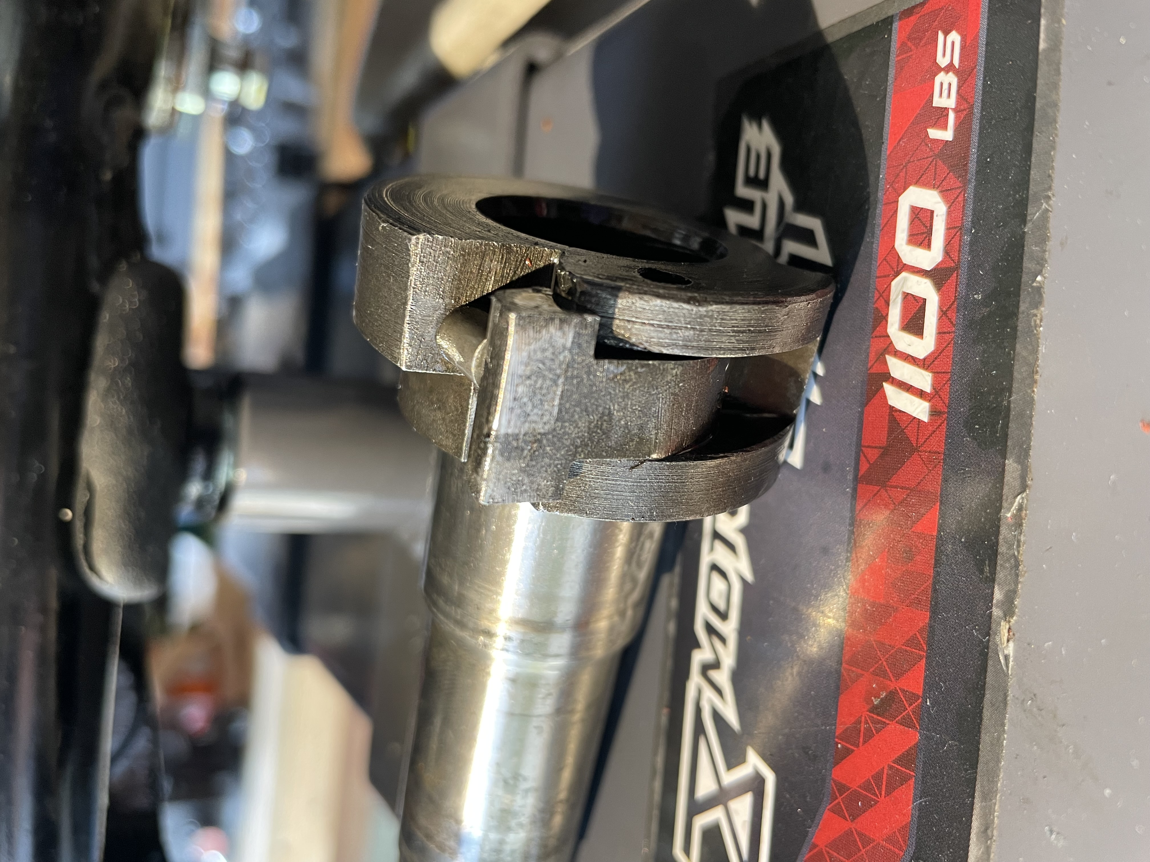

Okidoki I've removed the kickstart mechanism and inner gearbox cover to look at the kickstart in more details. The layshaft 1st gear looks fine and the kickstart pawl like wise.

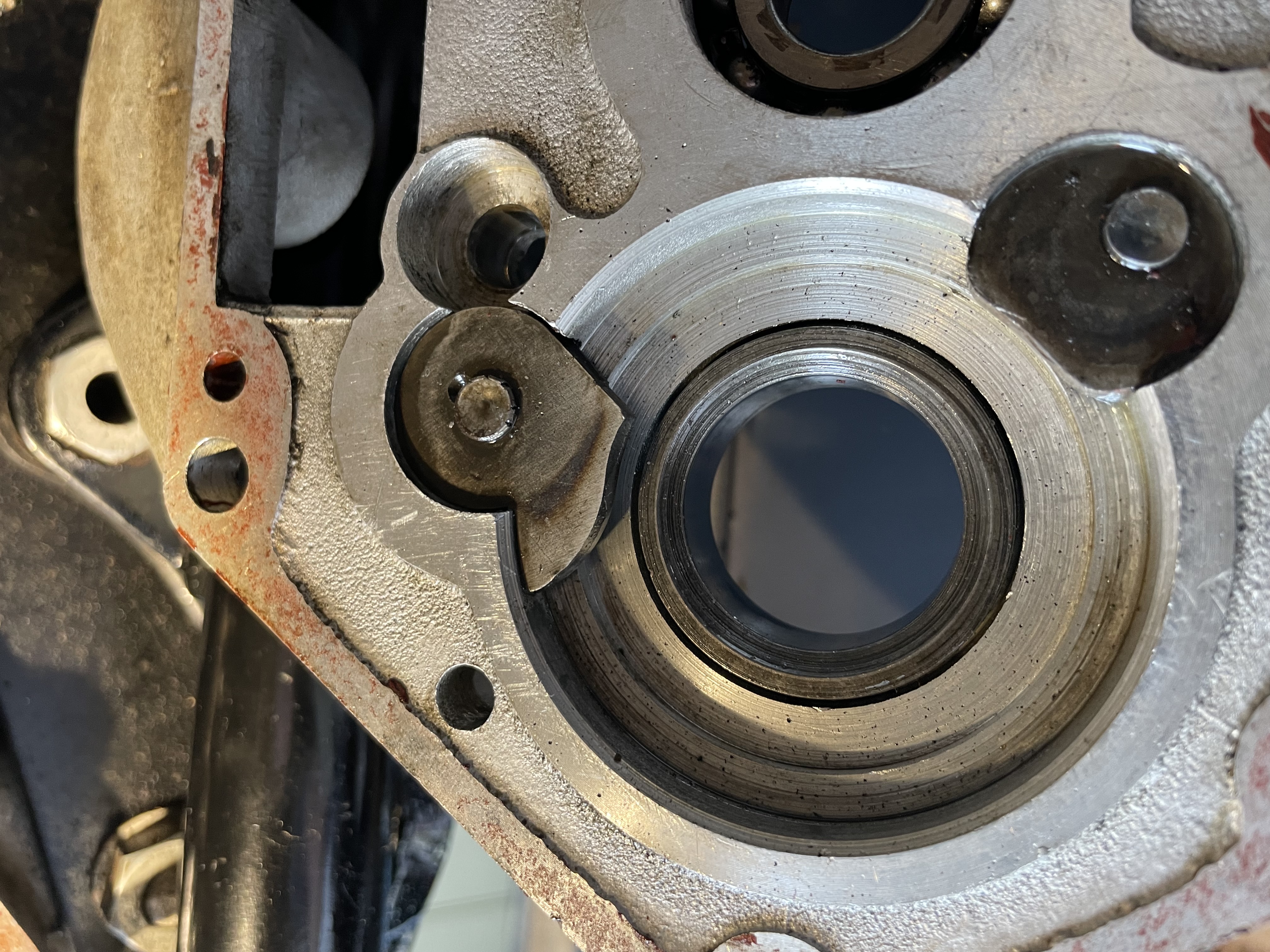

What does feel wrong is the bush for the kickstart in the inner cover. The kickstart shaft is grinding on the inner cover and the bush seems to be below the rim of the housing. See pictures attached. I would be grateful for thoughts, observations and clues as to what to do next!
Edited to say I think it's the wrong bush!
The kick-start bushes are steel.  So steel bearing on steel shaft.  They need to be strong to carry the load, but they don't support a fast rotating shaft.  So they aren't a problem unless they are under size (which doesn't seem likely) Is there any end float on the kick-start when it's all bolted up?  There ought to be some. Does the kick-start fit loose in the cover, without jamming?  One tab is the stopper for the pawl, and the other runs in a slot...is it bent or damaged?
There was about 1/8 inch float in the k/s shaft which is probably too much. A new bush (04.0473) is on its way which should remove this. Off the bike the k/s fits ok in the cover and engages nicely with the layshaft 1st gear.
So it's not the kickstart that's making it difficult to kick over, that's one potential issue eliminated.

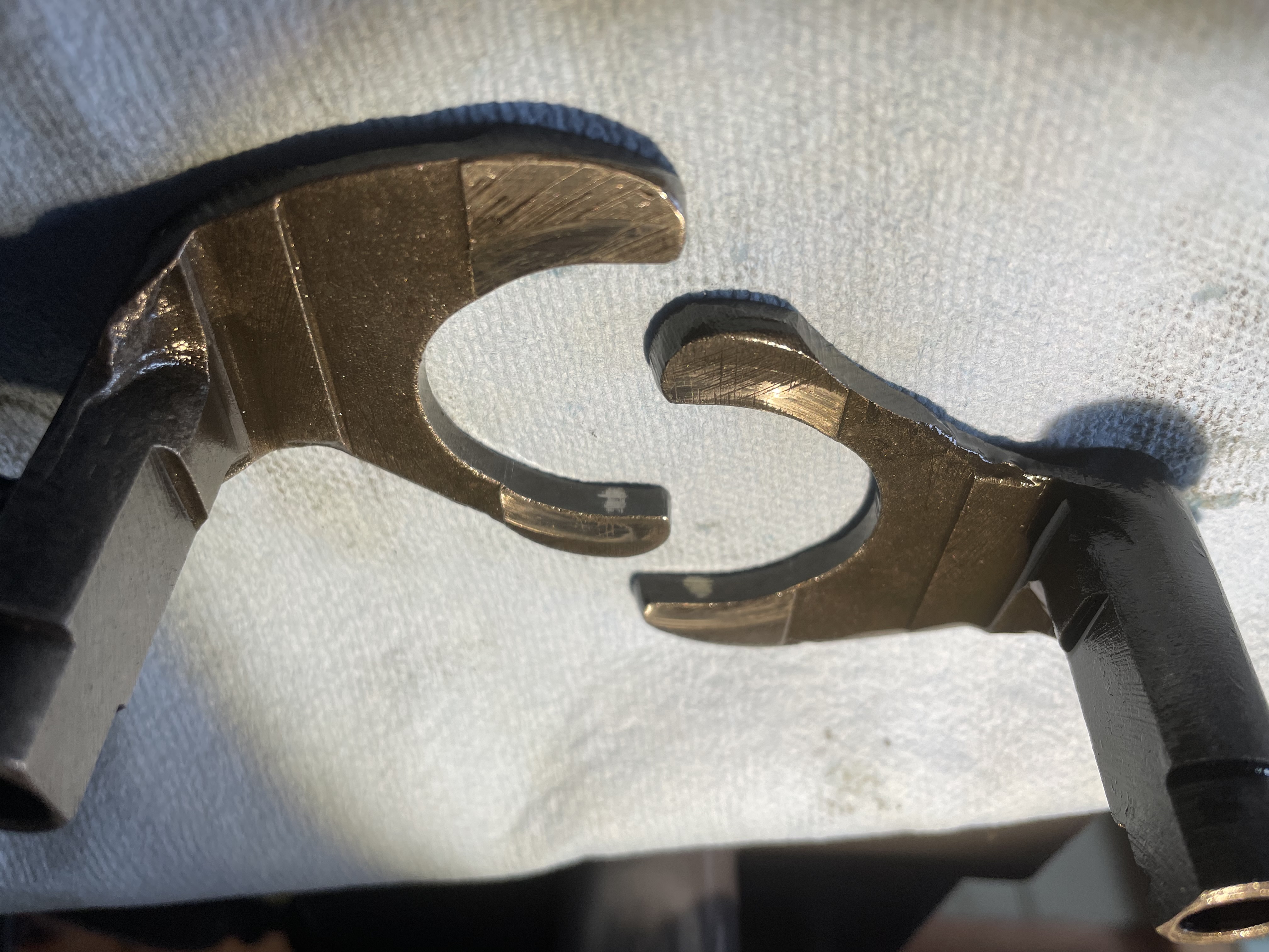

Here are some images of the selector forks. Too much or still serviceable? They seem ok in the quadrant and in their respective gears but it does stand out when stripped down..... Edited to say the forks seem to be good fit on the gears and on the plate as well. Unless anyone can tell me different they are staring for now!
Primary chain is not too tight in fact might be a tad loose. There are no shims in the gearbox. Selector forks are worn but not bent (see photos) and bearings do seem to be fine. I'm waiting for a new bearing for the inner cover and a new bush for the kickstart before I can check the box as per the Haynes instructions
