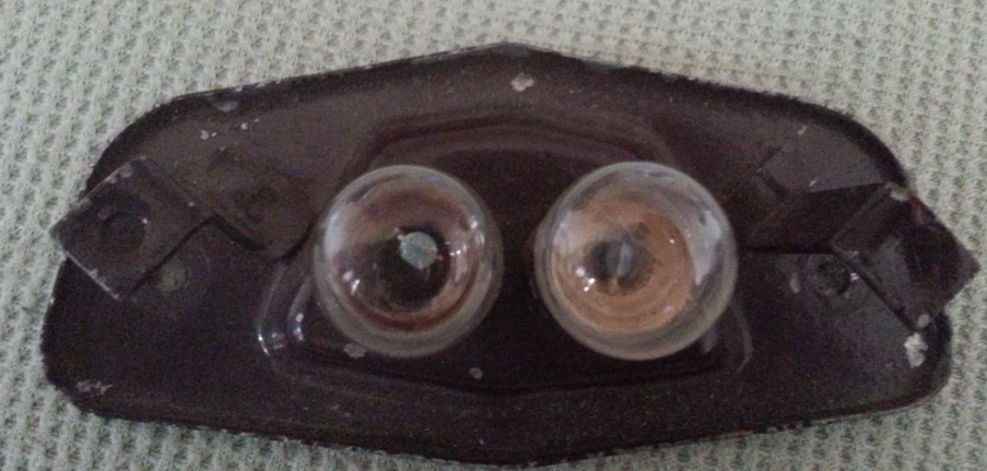

Looking through my bits and came across this a Lucas/Britax/Wipac? A rear light with two bulbs. I wonder if it can be wired to have two, yes dual combined Tail and stop lights?

Hi John, After 63 years I…
Hi John,
After 63 years I had to rebuild my rear light as the bulb had been in for 50 years and rusted solid. By dismantling 2 other units I salvaged enough bits to rebuild it.
If you want to make it into a twin bulb unit you will have to swap the bulb holders for offset pin units so dig down into your pile of old bits and pieces and salvage a pair, they should be interchangeable.
Dick
