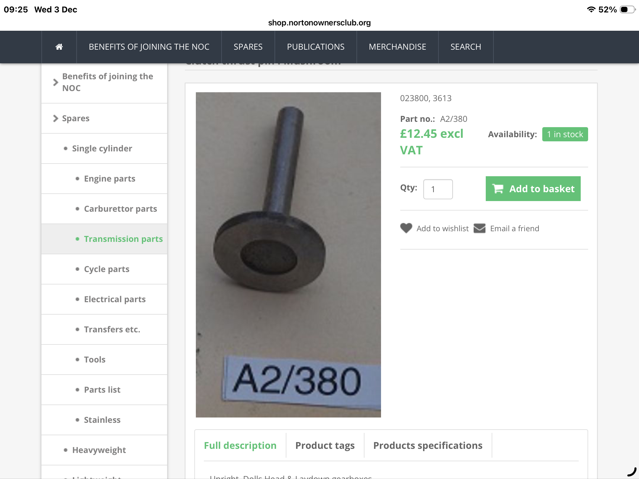

Unfortunately the part on the club spares has been sold. But i did manage to buy the correct end plate rather than my AMC one. The mushroom shouldn't t be too difficult to make but i would have to guess the overall length.
In reply to by eddie_simpson
Sure they are available in other suppliers.  Plenty of load on these, needs to be stiff.
  •  Overall length 1.75"
  •  Stem 0.25"
  •  Head  1"
  •  Face has a recess of 1/32" leaving a 1/8" contact face.
Would search one out rather than machine one up.  Maybe one of our members has a spare?

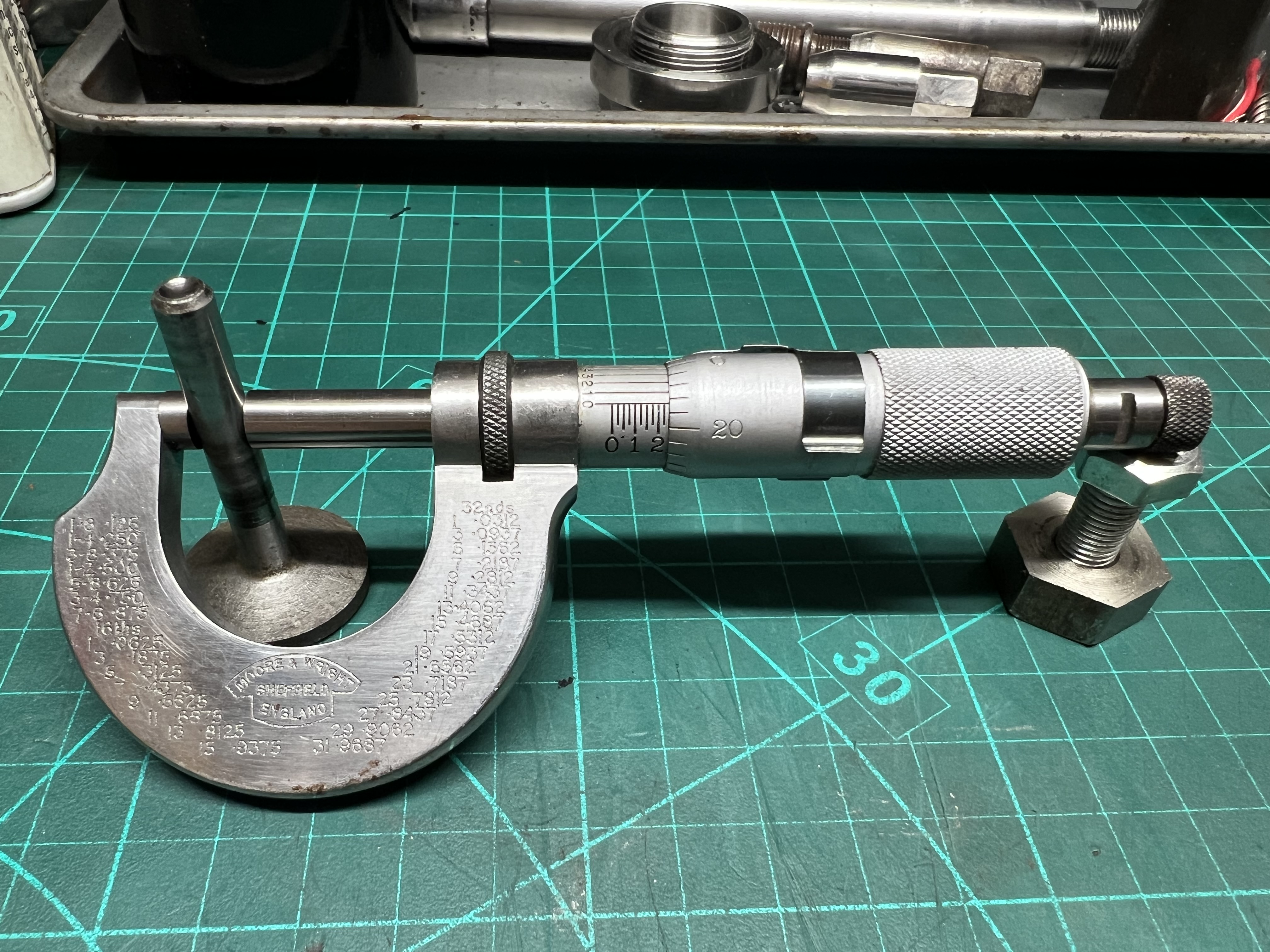

Someone once posted that the hole in the gearbox main shaft is 0.25" = 6.35mm, and the rod is metric size = 6.0mm.  I don't know if that's correct - but it means the mushroom rod would be 6mm diameter.  Might be wrong!  But obviously it has to move easily...
