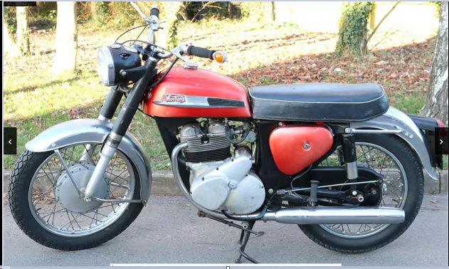

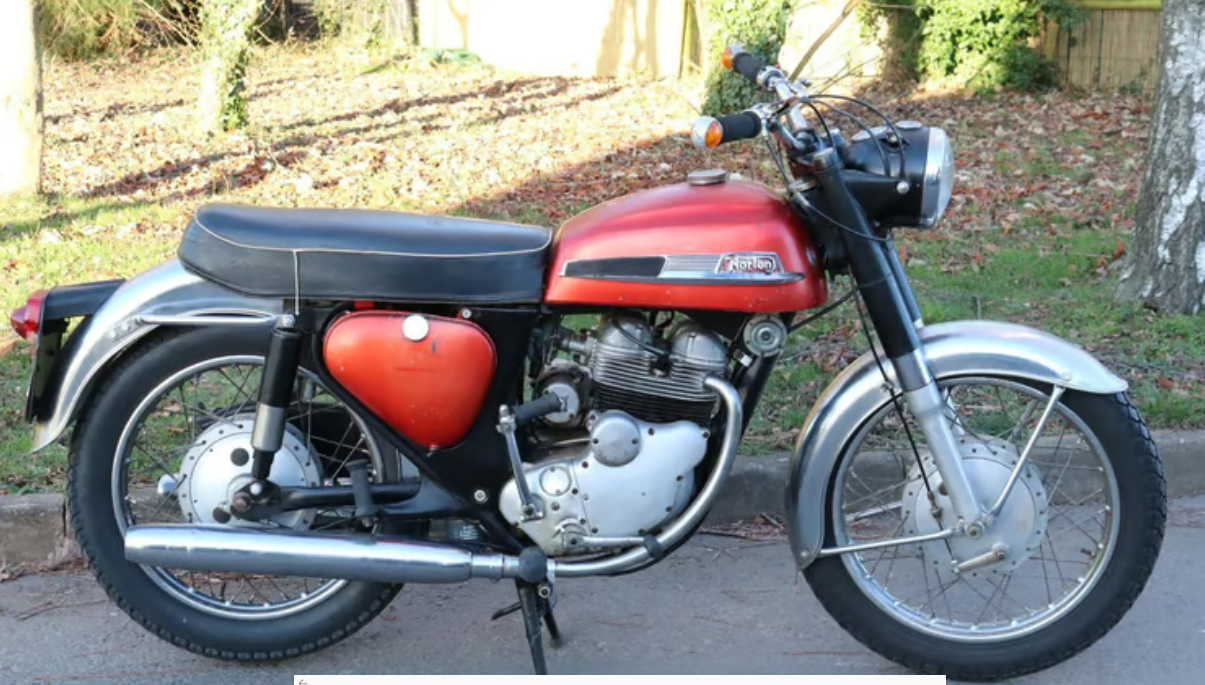

I'm looking at this but it's well overpriced to my mind. But are there any others around?
https://www.carandclassic.com/car/C1683301

I am surprised you think the asking price of £3999 is well overpriced. Supply and demand; there are not many about, and I am sure plenty, me included, are thinking the way you are. It will cost £3k + vat at Norvil prices to convert a current Norton to electric start, for parts alone.

If you don't buy that one you indicate , I doubt you will get anything better. It looks like a very unmolested model from dry storage in USA.

This is the Bike that Ian is looking at....
Its Beautiful!
Looks very unmolested.
He asked if I had anything for sale...but I have nothing like this!
Wish I could afford it!

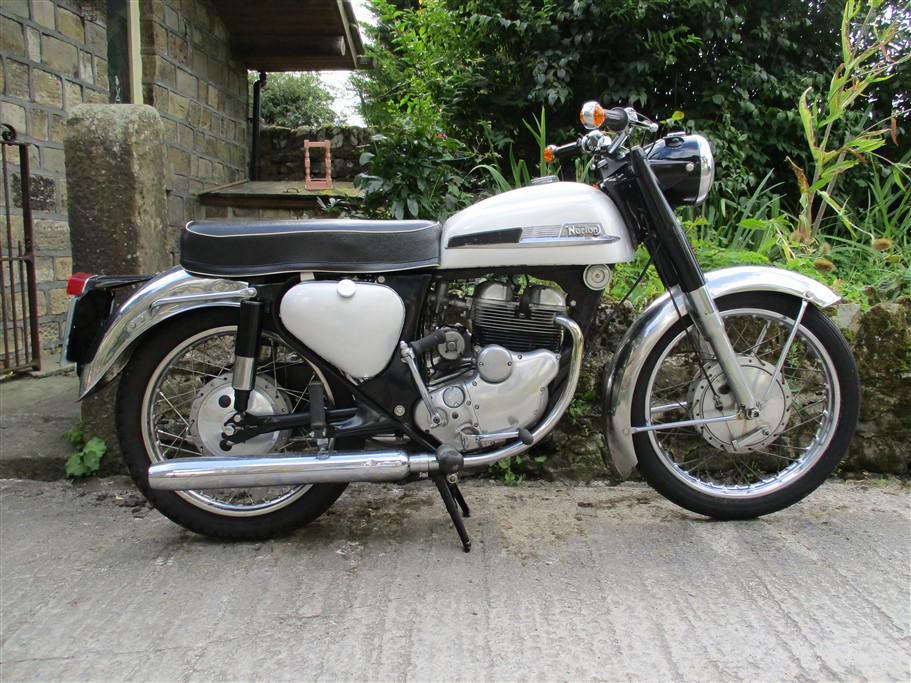

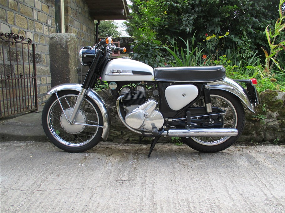

... I've bought this one from Andrew Sharp of this parish who responded to my wanted ad here. It looks in very nice condition apart from a slight mark at the rear of the petrol tank and Andrew was an excellent person to deal with. It just arrived today courtesy of Phil at Acceleration bike movers who I've used in the past and always does a good job.
Wow that looks spot on Ian!…
Wow that looks spot on Ian! You must be dead chuffed.
How about a few more pics, as it looks so original?
Edit: but I still don't like the "cigar" silencers, I prefer the Dommie style ones. But that's just my opinion....

Hi Ian,
Andrew has fitted a centre stand similar to Navigator and Jubilee.
I find in my old age these models are quite hard to get on that stand. Foot on little peg at nearside foot of stand and pull back left handlebar end. Steady things with the right hand on the 'lifting handle'. And grunt. Not so lightweight!! .
Electra centre stand is available from the club and makes for a much easier lift as you put some weight on the lever provided. More in keeping with your desire for an easier Norton.
Thanks both...
... Peter - I haven't actually tried to get it on the stand (Phil did that and I could see it wasn't easy) so I may well follow your advice. It does look as though that stand doesn't lift the back wheel off the deck. I must also fit a prop stand as I hate struggling. The Norton Commandos I had were a doddle to get on the centre stands even when heavily laden.
The only flaws I can see so far are that the front mudguard looks like a Commando one - but I think the "proper" ones are very rare - and there's some damage to the petrol tank finish just in front of the dual seat on the nearside which may be due to a leaky tap. The engine turns over nicely but I haven't tried to start it as the battery is dead. Apparently it has stood for a long time after restoration some years ago, borne out by old MoTs.
I jumped at this one as they come up for sale rarely and this looked like a good deal at £500 less than the original red one that I missed. And I think it's a better bike for me as I'm not really a fan of the original and unrestored look which often strikes me as being better described as rusty old heap.

And another quick query - how do the bar end indicators come off? I can't see any wiring to them either. No battery so just looking around.

2 small screws holding each lens (you can still get the original lenses from Germany),complete replica lamps are also readily available on the internet , remove lens, remove festoon-type bulb. There's an expanding bolt thingy, bit like the old rawlpugs. Slacken the nut, this enables the expander to loosen and the body of the lamp slides out so the wire can be disconnected.
Many thanks Michael,
I thought it must be something like that but hadn't looked closely. I'm tempted to fit Commando type indicators which would be possible without making any irreversible changes as (a) I think they'd be more visible and (b) I like bar-end mirrors which of course are incompatible with these indicators. As the bike has a Commando front mudguard it'll be continuing a theme.....
I still can't see how the wire gets to the indicator unit but no doubt all will become clear.

Suspicion your bike has a Fanny B centre stand, which will fit but is lighter weight tube fabrication than Norton cast item.
Indicators?
I don't like bar end indicators as you can't chuck the bike against the garage wall!! You need 10W lamps. And in this picture above the wiring is Japanes.

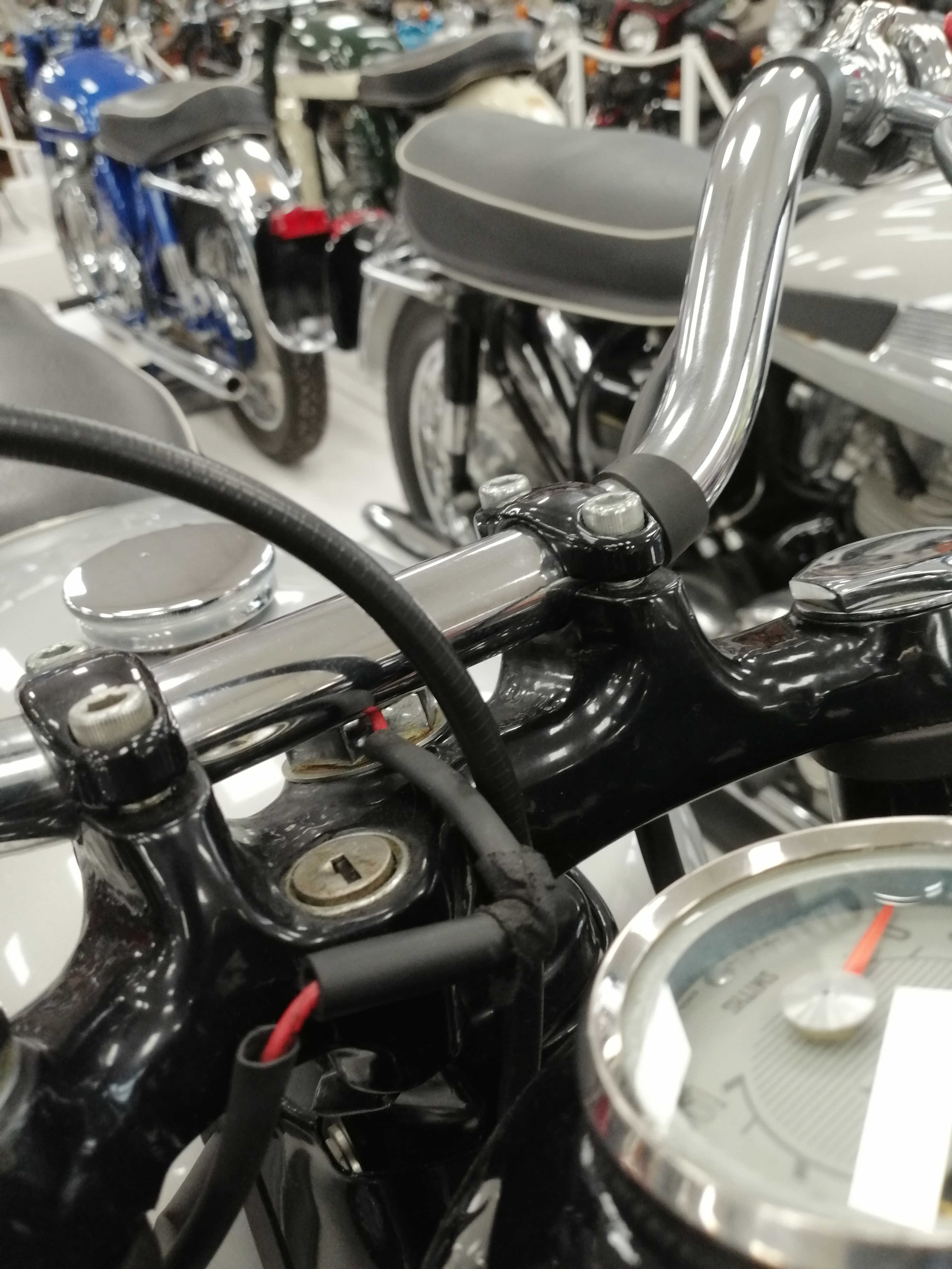

Wiring runs through the bars and exits through a hole just above the top yoke. Pic attached, you should be able to see it just above the steering lock.
Ah, yes....
... the feed to mine is through a hole in the left hand side just before the outer bend. I've successfully removed one of the bar end indicators after realising that the wedge nu has a screwdriver slot rather than a hexagon....
That picture shows a top yoke with a steering lock - mine doesn't have one so presumably the forks are 7" centres.
That photo looks as if it's from the NMM - I may pop over and have a look at what they have on show.
