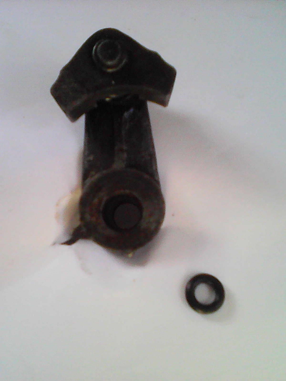

Can anybody tell me the correct size of the two small o-rings in millimeters if possible sealing the ratchet spindle against the gear lever shaft ?
So I can get them locally, hopefully.
Part No. 040079
Today I adressed the leaking gearbox of my 1961 Navigator and tried two square o-rings No. 040079SQ from NOC spares. The gearchange shaft did not turn and the cover had to be hammered on the shaft to fit. These square rings are too large. Unfortunatly the original round o-rings broke while poking them out of the grooves of the spindle.
Thanks for your help
Uli

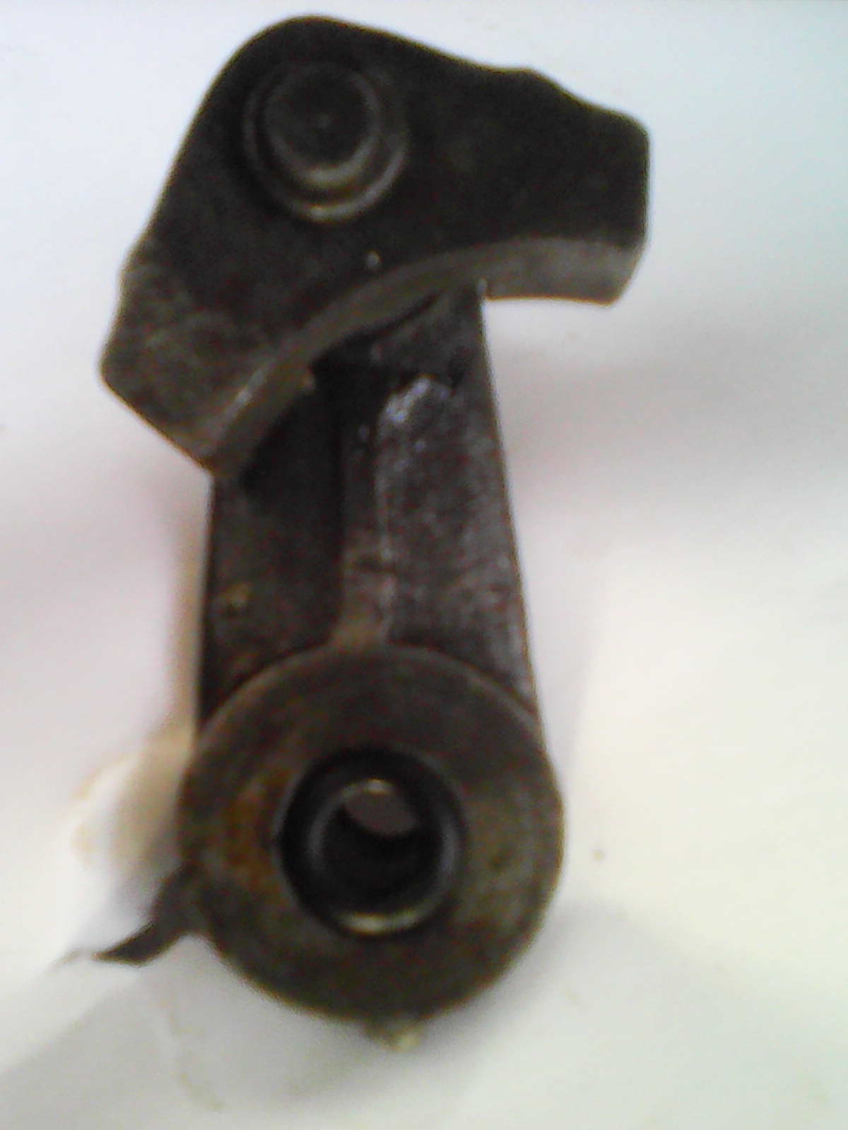

6mm inside dia 2.0mm gauge ?. I separated the gearchage shaft from the gearbox cover to investigate the interferance fit of the O rings. fitting the gearbox cover is always a fiddly job. The image shows where reaming the shoulder might ease assembly.
