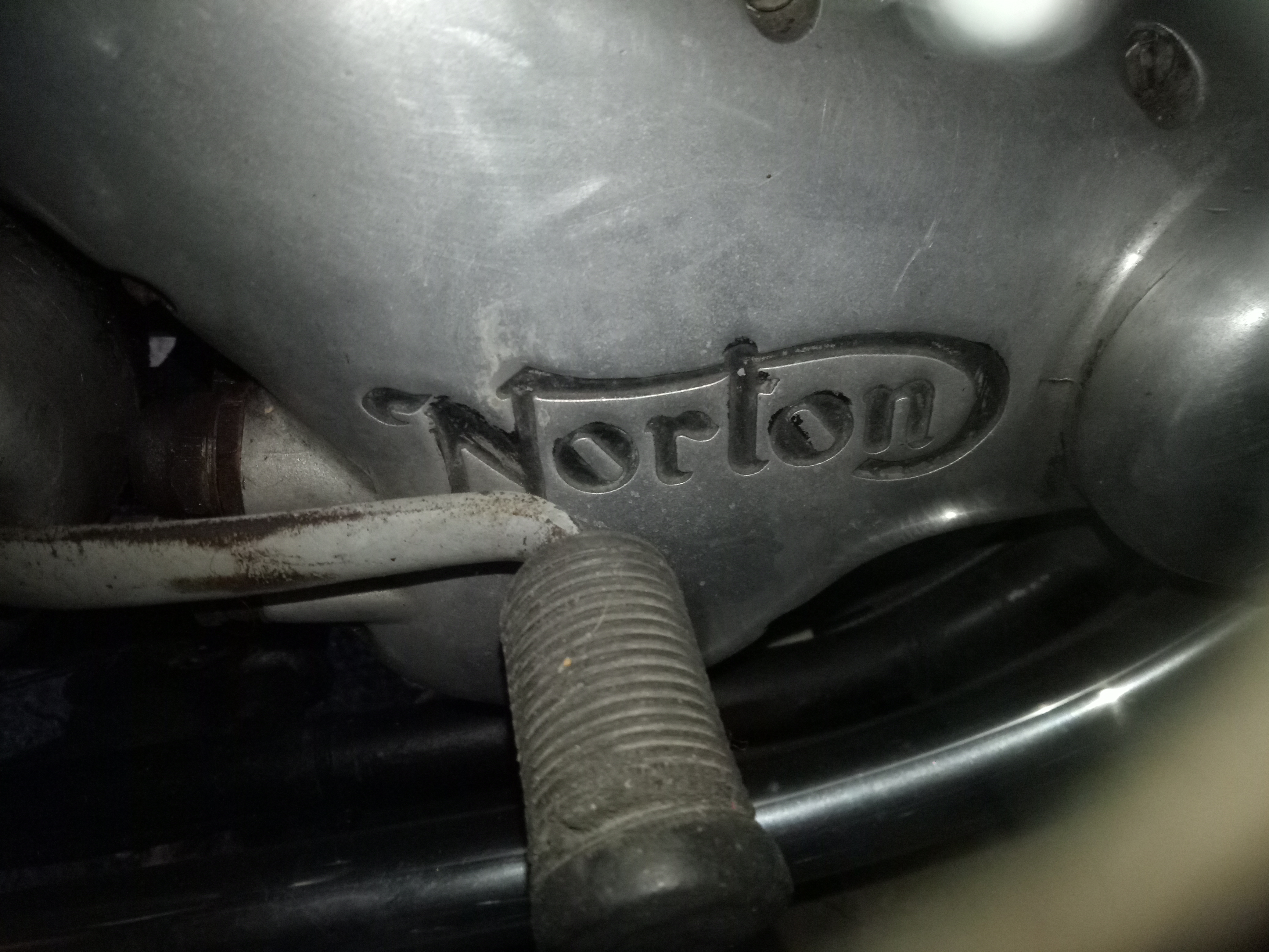

Hi All,
Lockdown has got me restarted on improving my ex-Interpol 72 commando.
Mine has untidy remnants of paint in the logo of the timing cover.
I just wondered if this paint is original. We’re they built with the logo painted?
Back in the day I used to have a 72 Fastback but can’t remember if the logo was painted or not, and back in those days I seem to have forgotten to take photographs.
Interested to here if anyone knows the answer.
cheers
Steve

After some breakfast…
After some breakfast research, I think I’ve got it.
Firstly, I looked at the Norton girl posters on AN’s site. No info there other than the fact that the marketing people at Norton preferred the look of the primary side.
I then found a site that has the old Commando brochures.
http://www.classicbike.biz/Norton/Brochures/Brochures.htm
None of the models had the logo painted in up to 1974.
The 850 mark 3 has a black logo from 1975.
But I’m still not sure whether to polish out the old black paint from mine or give it a new coat....

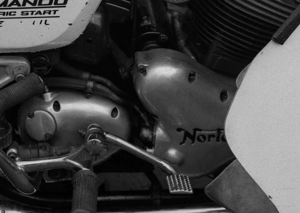

Hi, i bought a Mk3 Interpol…
Hi,
i bought a Mk3 Interpol direct from Norfolk Constabulary (via a small Norfolk bike sales place (EST Stanton Setvice Dtation!) in 1979 and the Norton logo was painted black. The bike was not in any way prepared for sale, being tatty (only years old) and with just the key police kit and stripes removed. As the timing cover was partially obscured by the fairing, I cannot imagine that anyone, police or otherwise, would have ever considered adding the black paint later, so assume it to be original.
Hope this helps?
Andy

Further to my previous reply…
Further to my previous reply (apologies for the typos!), I have attached a photo of my 1975 Mk3 Interpol as it came from the police in 1979. As can be seen, the logo is painted black and a bit tatty (like the rest of the bike was after only four years). The thought that a police garage mechanic would have bothered to paint the logo does not really seem likely - why would they?. Nor does it seem likely that the police bike kitting department would have bothered either; again, why would they? So in my opinion it seems most likely that the logo was already painted when the bike was delivered from the factory.
Andy
