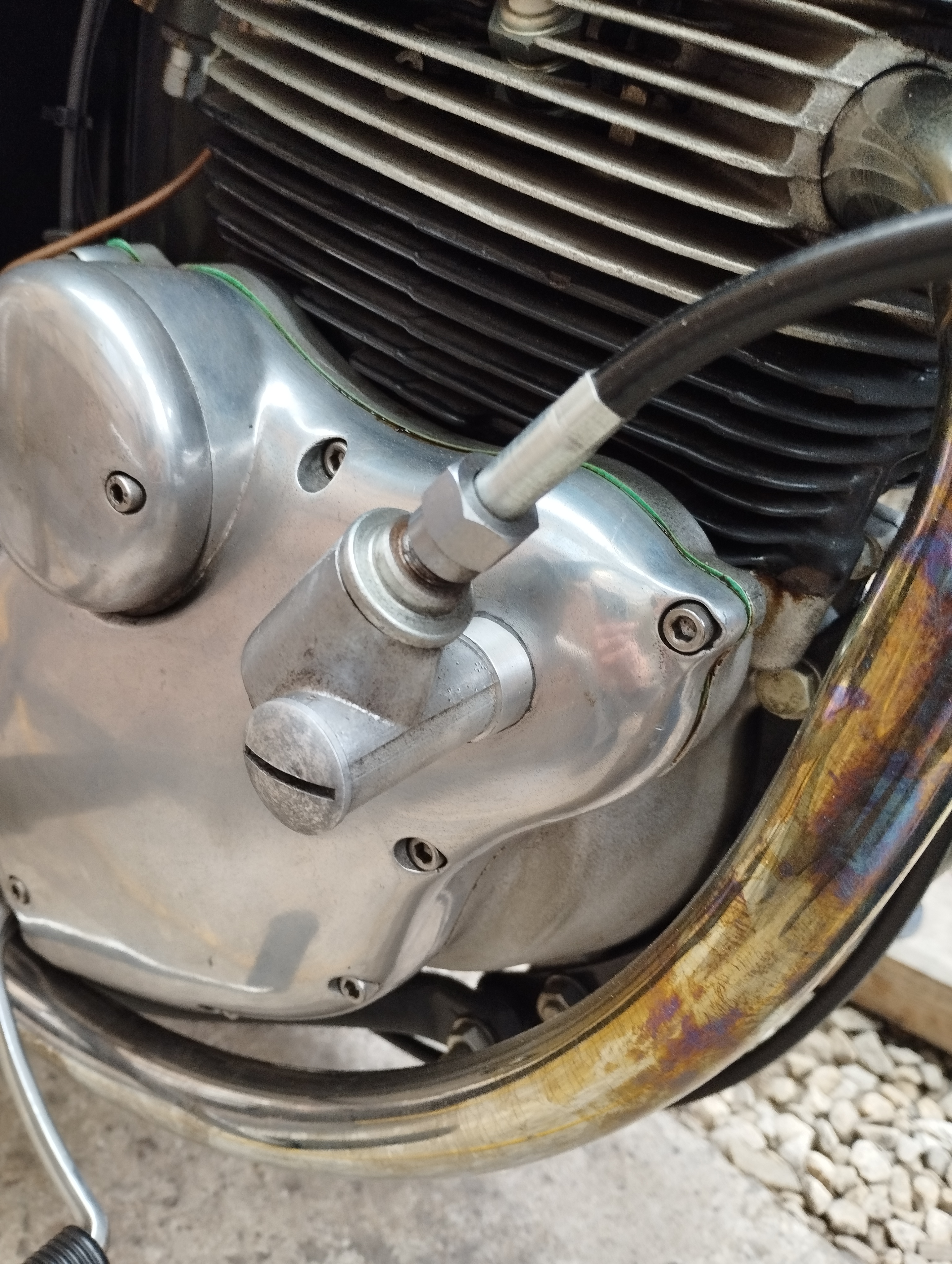

I used a Triumph rev-counter gearbox, the sort the screws in to the crankcase, drive side, driven by the exhaust cam.  I used one of these because I had one!
Fitted it to the timing cover, positioned to be driven by the exhaust cam.
The Smiths style head is Indian and hopelessly inaccurate.  Its about right at 30 - 40 mph in top gear, useless at other speeds, if I've done the sums properly.
I took a Smiths chronometric off another bike to get some realistic numbers, speed vs revs, seemed okay.

Fascinating!  How does the rev counter gearbox actually engage with the camshaft?  Having looked online I see that the gearboxes have a protrusion that looks like a flathead screwdriver blade, which presumably slots into something to spin.  This forum is great!
Nick H, you are right about the "screwdriver blade".  On the Triumph 750's it engages a slot in the "tacho drive plug" which, in turn, screws in to the end of the exhaust cam.  Or, I think, on late models it engages in a slot directly in the cam.
I made a special nut to screw on to the timing end of the cam, see photo.
Another thing I had to make was the nut/bearing that fixes the box in place.  On the Triumph its a left-hand thread, needed to be replaced with a right-hand thread on the Navigator.
I used a cable from a T140.
