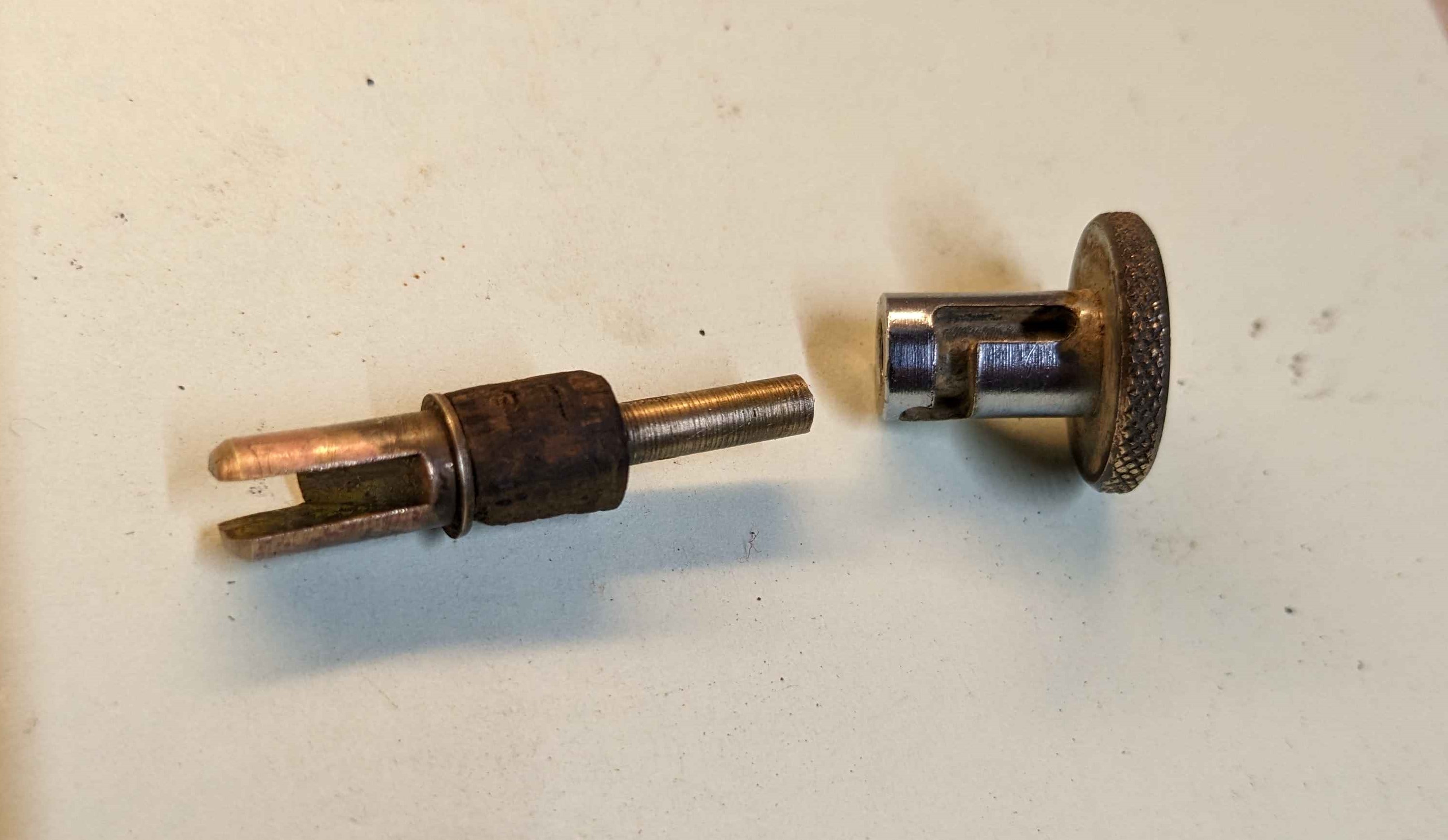

I have managed to break the fuel tap on my 62 Navigator. I have sheared the end that attaches the brass valve to the tap. I will try and repair or make a new brass valve piece. Either way I need to align the brass valve slots with the tap grooves. If anyone has a fuel tap apart could they please post a pic. Thanks

The petrol tap is fine. just…
The petrol tap is fine. just needs to be put back together and the brass spindle peened at the pull knob. I have rebuilt lots of these. there is one problem though . the assembly can be orientated two ways and only one works. I may be able to send you a photo ,but you will have to pm me a mobile .If you fit a new cork it needs to be a tight fit as it will bed in with use. These extended plungers are now very rare ,as are the small screws that secure the plunger . No one has any spares , except me !!
Thanks Robert. The square…
Thanks Robert. The square section on the end that gets peened over is the part that broke off. I will pm for a pic please.

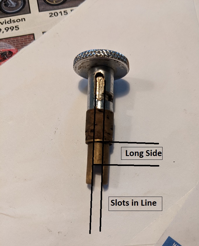

Bit late, I know - but here…
Bit late, I know - but here goes anyway....

As for your tap - if you want to repair it - its alignment is shown in attached photo.
To renew the cork (new ones are available on eBay) slit it (with a razor, scalpel or craft knife) lengthways on one side, cook it in steam above a kettle spout for 20-30 secs - you will find that it becomes pliable.
Open it up and slip it over the spindle, close it up & insert into the tap body.
You can now leave it until you are ready to use it.
In the future, if you drain the tank and let the tap dry out, the cork will need replacing again. Its possible that soaking it in WD40 will preserve it.
