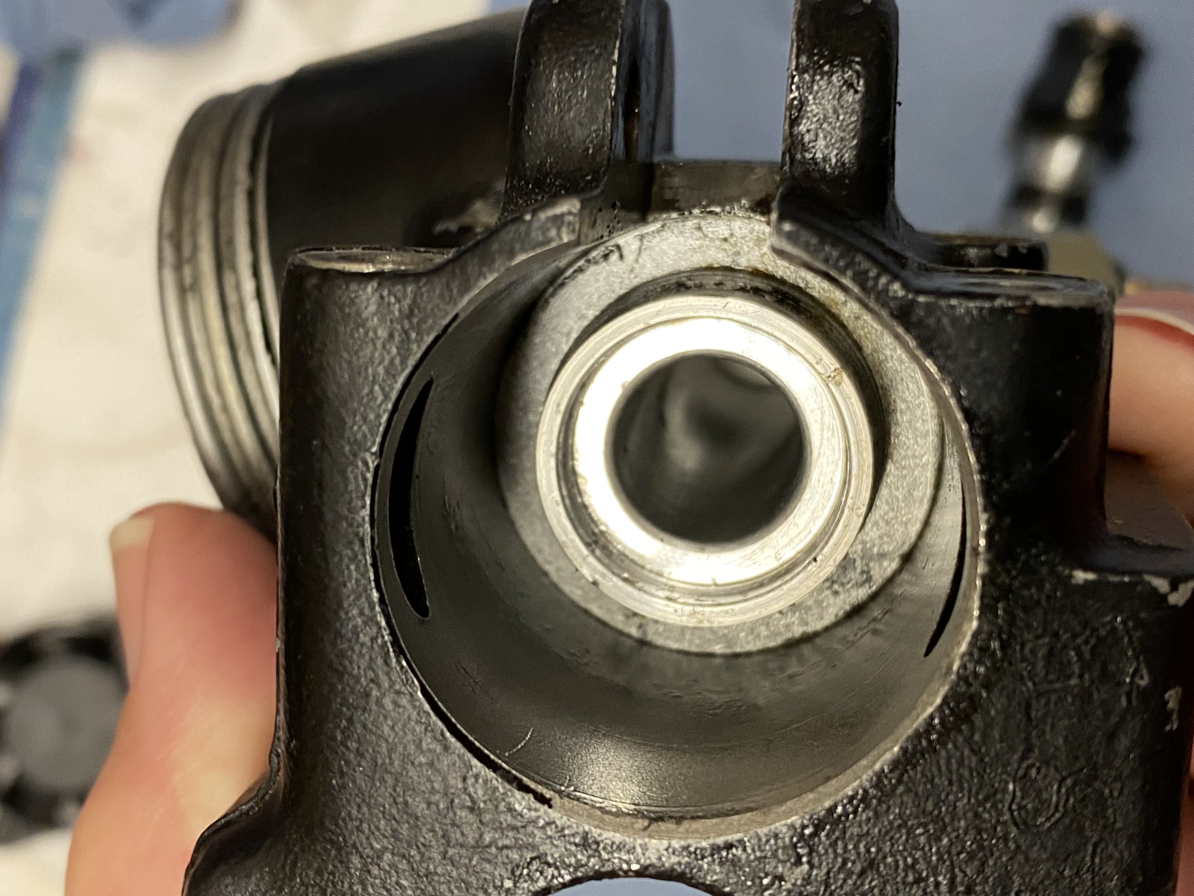

…I could swear I rebuilt the master cylinder on this particular bike last summer but obviously not!  I dismantled the unit this morning to discover the innards are completely non standard.  The PO seems to have  fitted a brake upgrade which consists of a 1/2” sleeve for the cylinder bore, non standard piston assembly etc.  The master cylinder boot was in tatters and almost  non existent.  I plan to order a complete set of 13mm parts from AN tomorrow and see if that cures matters.
Photos of the M/C bits please, it will help identify who's sleeve kit it is. 13mm is bigger than 1/2"
Inners…for the sleeve kit in the bike’s history file.    It was supplied by Don Plender (Triton Motorcycle Parts).  I’ve attached photos of the innards and the sleeve in situ.  According to the instructions it was locktited in place.  It does feel securely fixed so I’m minded to ream it out to 13mm and then fit RGM internals.
Sleeve
