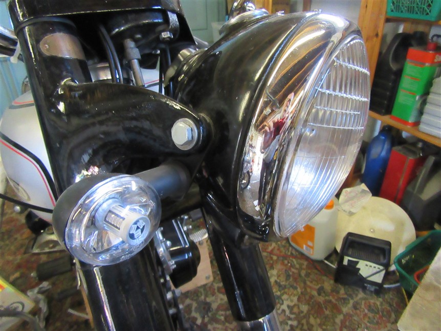

Here's my solution to the problem.  I made some brackets out of aluminium angle so as the indicators can be mounted below the line of the headlamp bolt.  I then bought some stainless steel spacers and two longer stainless cycle thread bolts of the required size.  I  also fitted daytime running led's that are serious bright but hardly draw any current.
Indicator brackets
Very neat! Thanks. Also has the advantage of spacing the lights a bit further out which I think is good. What is the size and threadform of the longer bolts and where did you get them and the spacers? Nigel Orchard.

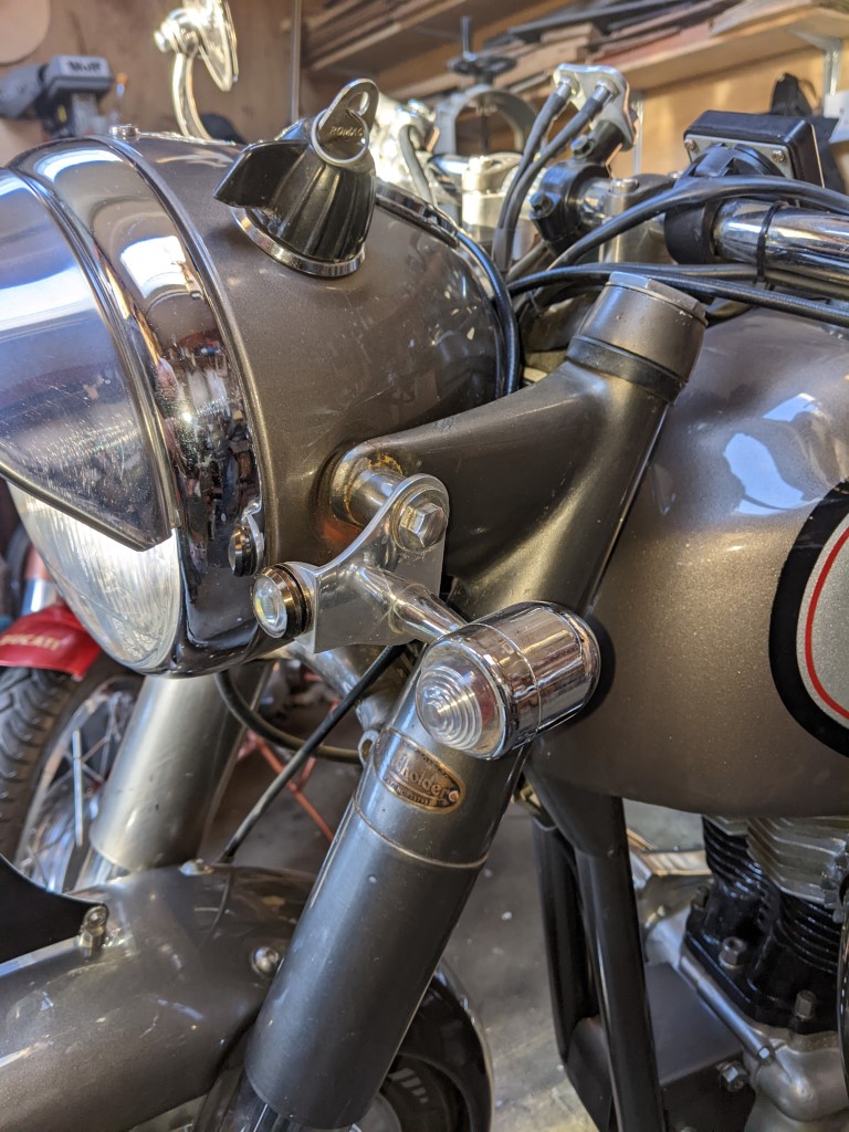

... but from flat 1/16" sheet tucked in behind the fork shrouds on my ES2. I made a bracket for the back that I bolted to the number plate. I agree indicators are all but essential these days.

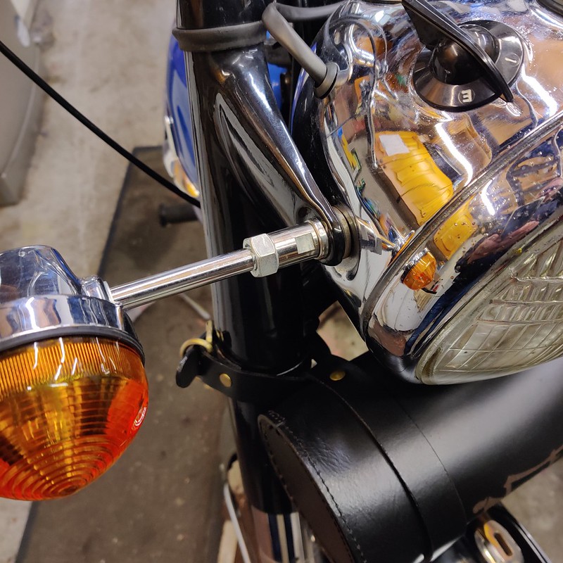

This is the adapter on my Navigator, made from stainless steel with an extended thread to pass through the headlight shell. and a female thread to take the indicator arm.Indicator adapter

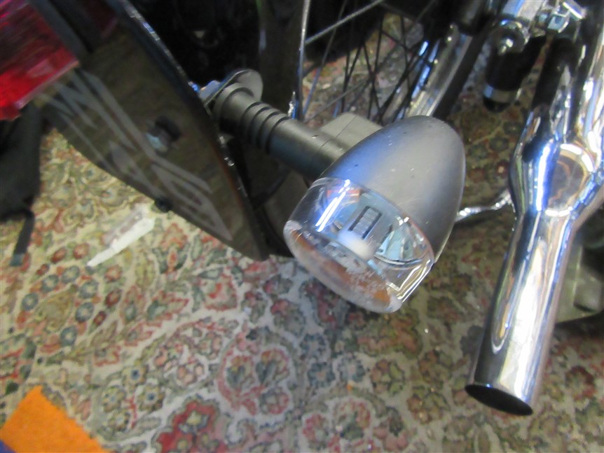

The indicator units ar discontinued Halfords items. Note that LED bulbs are about 5mm longer than conventional ones and I had a bit of a struggle to fit these - I had to revise the internal wiring to give clearance.
