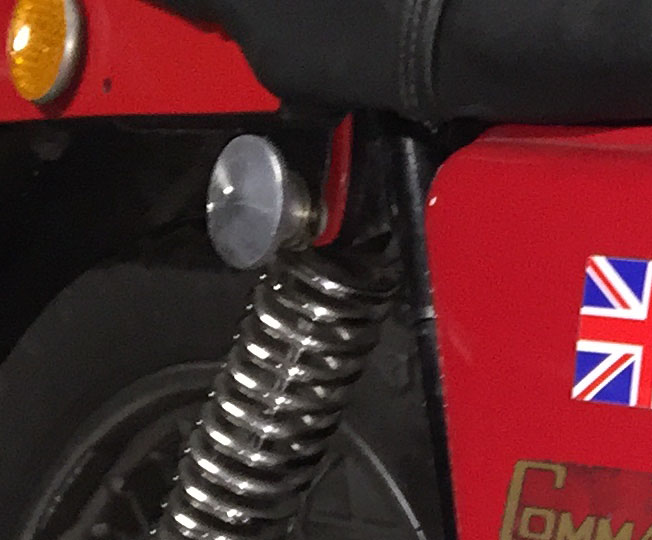

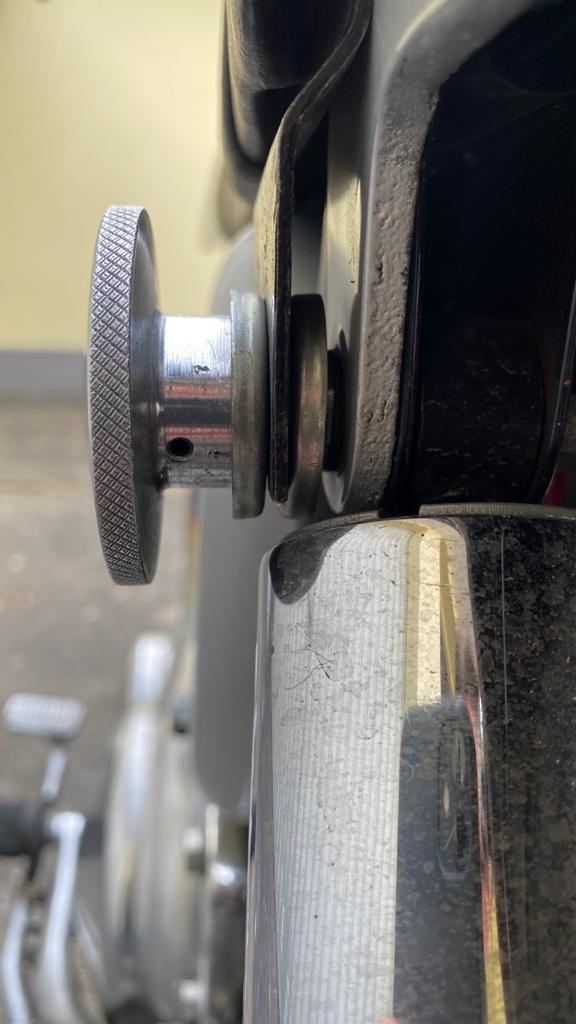

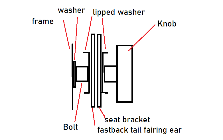

          Would somebody advise me, how should be the correct assembly order of seat and tail faring. We tried to fit it properly on my brothers commando, but seat bolts look short. Detail in picture.
Seat assembly
Hello Jakub!
The tail fairing ear goes directly onto the frame and not between the lipped washers.
Leave off the inner lipped washer and fix the seat between the flat washer and the outer lipped washer.
