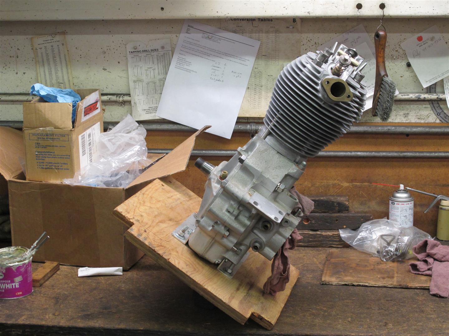

Compression ratio can it be measured without removing cylinder head?
