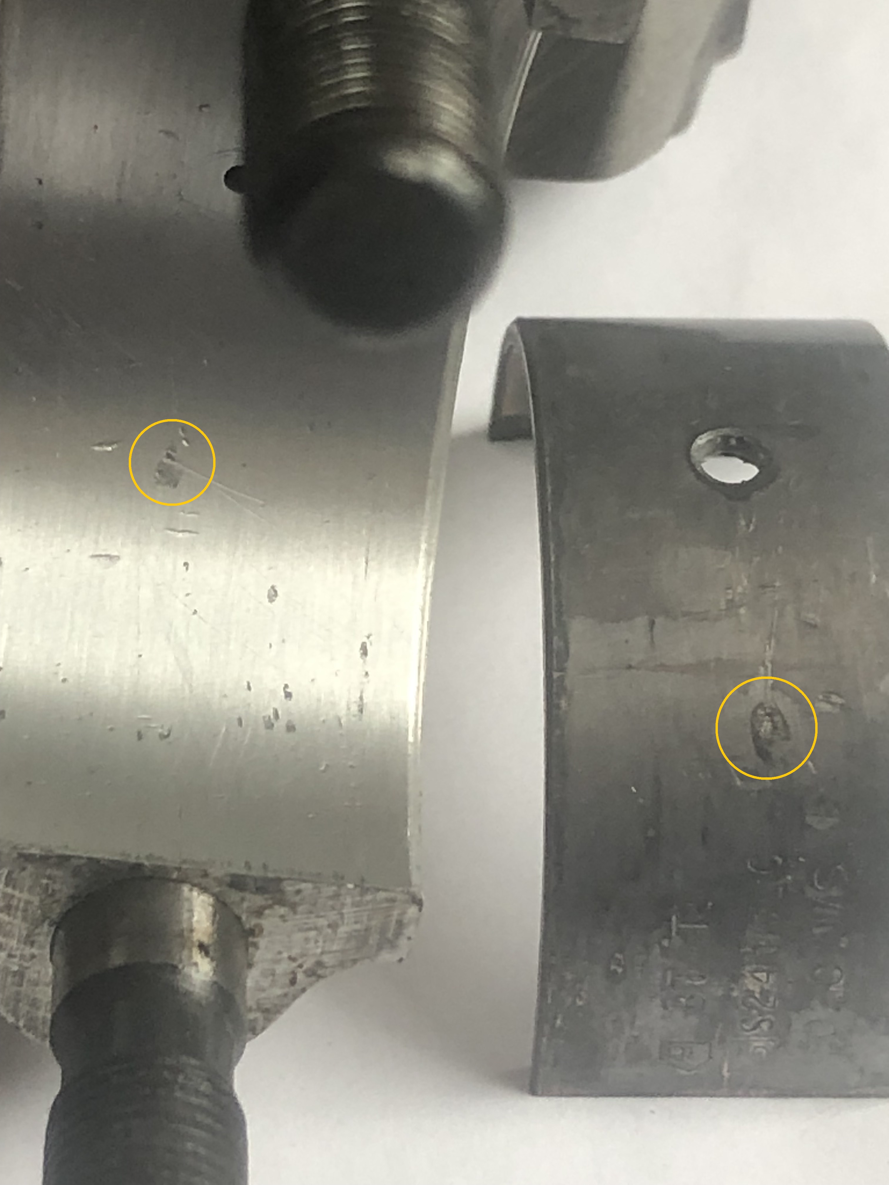

I tried to measure any ovality in the conrod but my internal mic was too big.  But wahat I did find amongst the marks in the Alloy part of the big end eye was an imprint that coincided with one on the back of the shell. Looks like builder didn't clean the parts before assembling the conrods!!

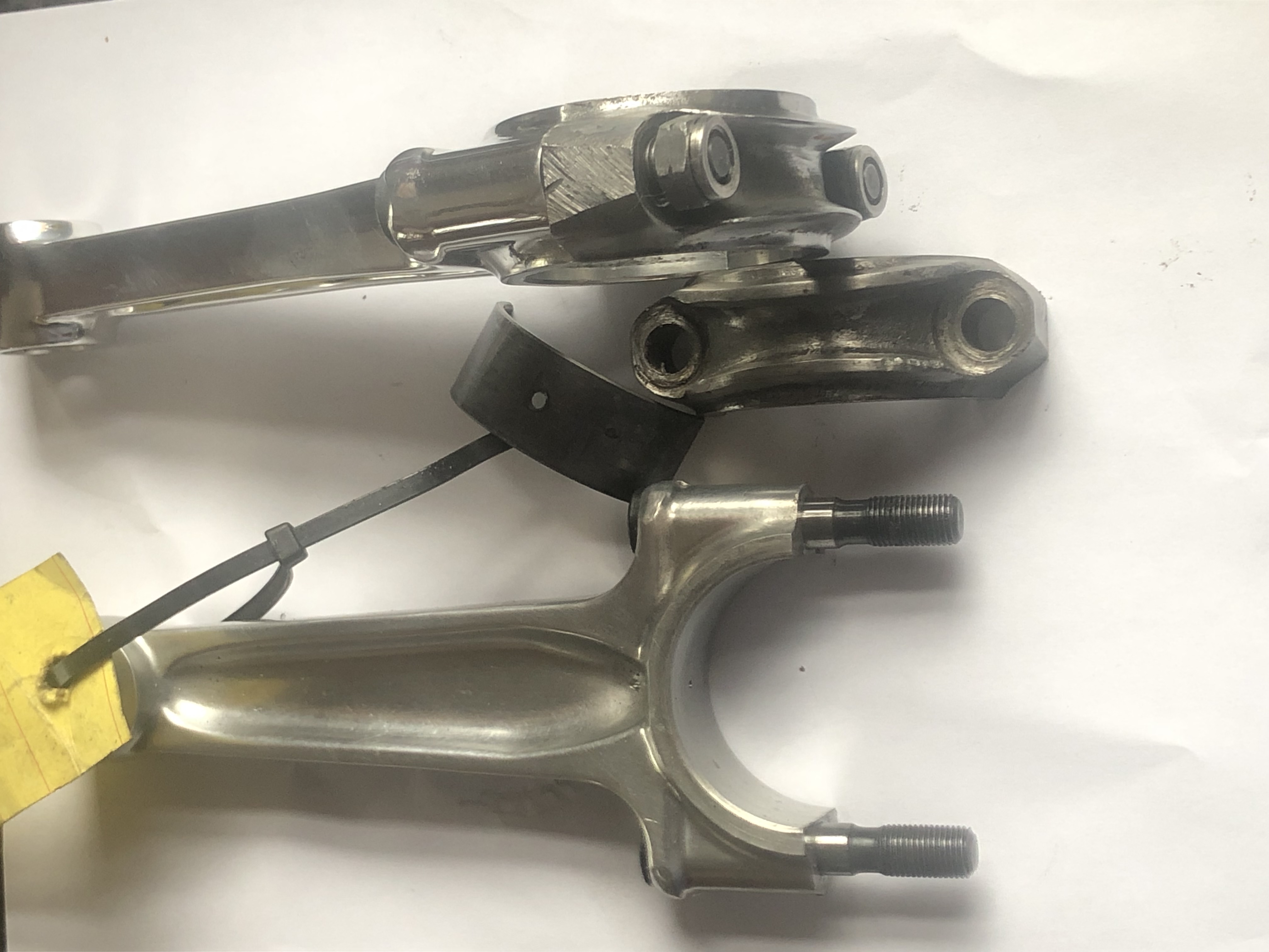

The engine is out of a Grass Track outfit - rigidly mounted, the fly wheel doesn't appear to look as if it's been rebalanced but the conrod's steel caps do look like they've had some meat taken off
If they ground the mating marks off in an attempt to balance rods then its easy to assemble incorrectly. Those srfaces for the nuts to bear against look horrid,ask your engineer to clean up .
