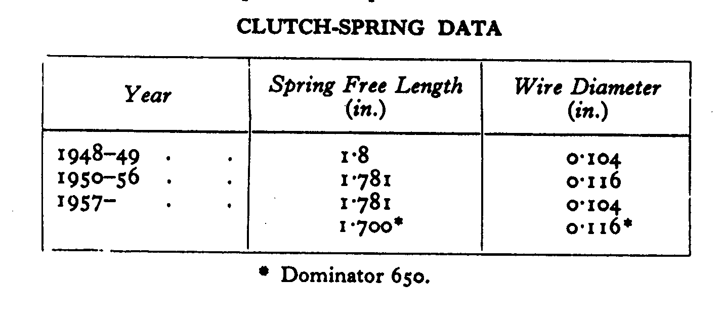

Thirdly....... are your clutch springs the correct type? The early Dominator springs were long and thin sectioned. The SS springs were not as tall but made of chunkier wire. See attachment.

To be honest, it feels like a springs issue to me. I don't think the old ones in there are up to the job any more. They're screwed in all the way to the top of the threaded bolt.
