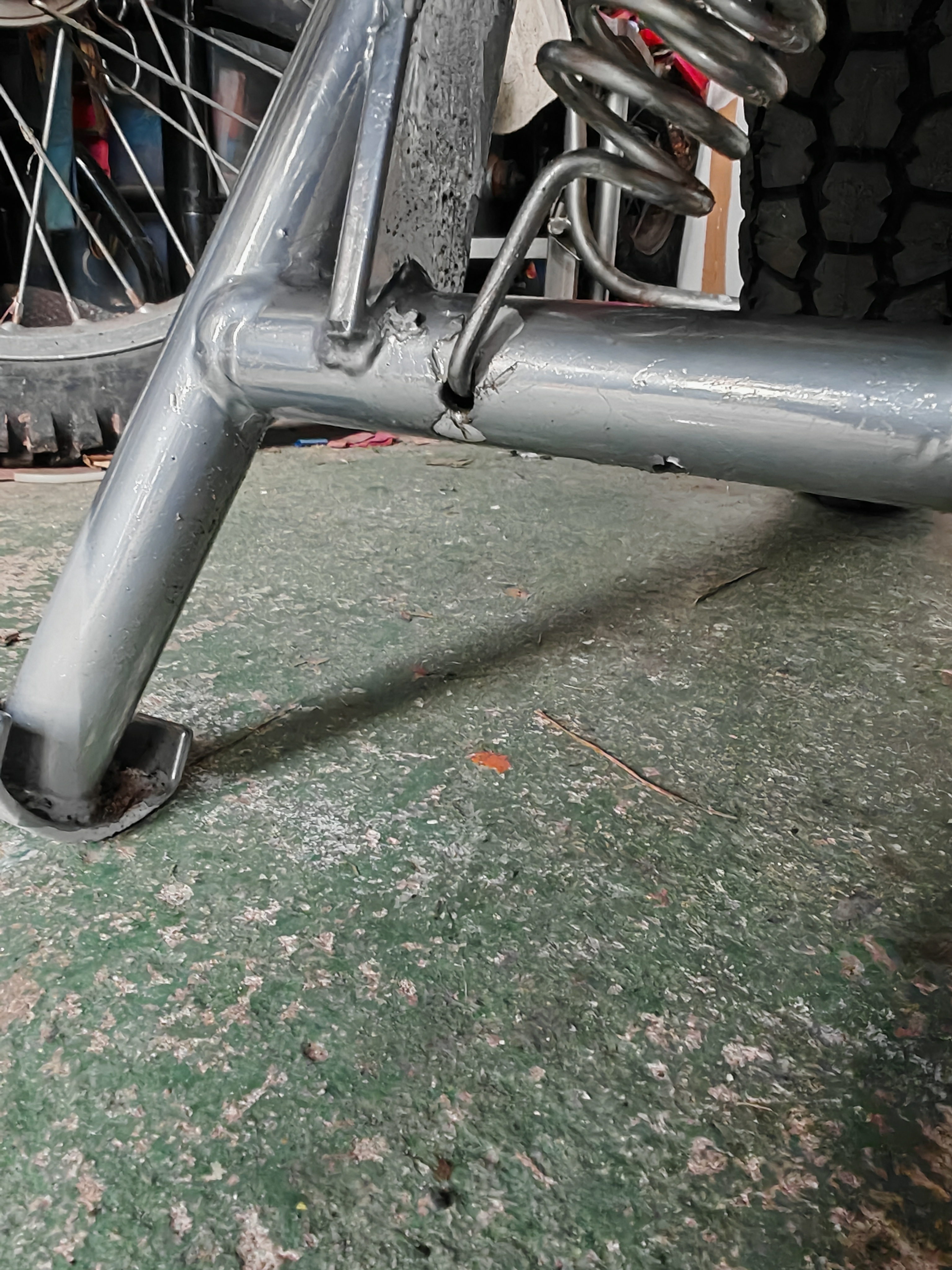

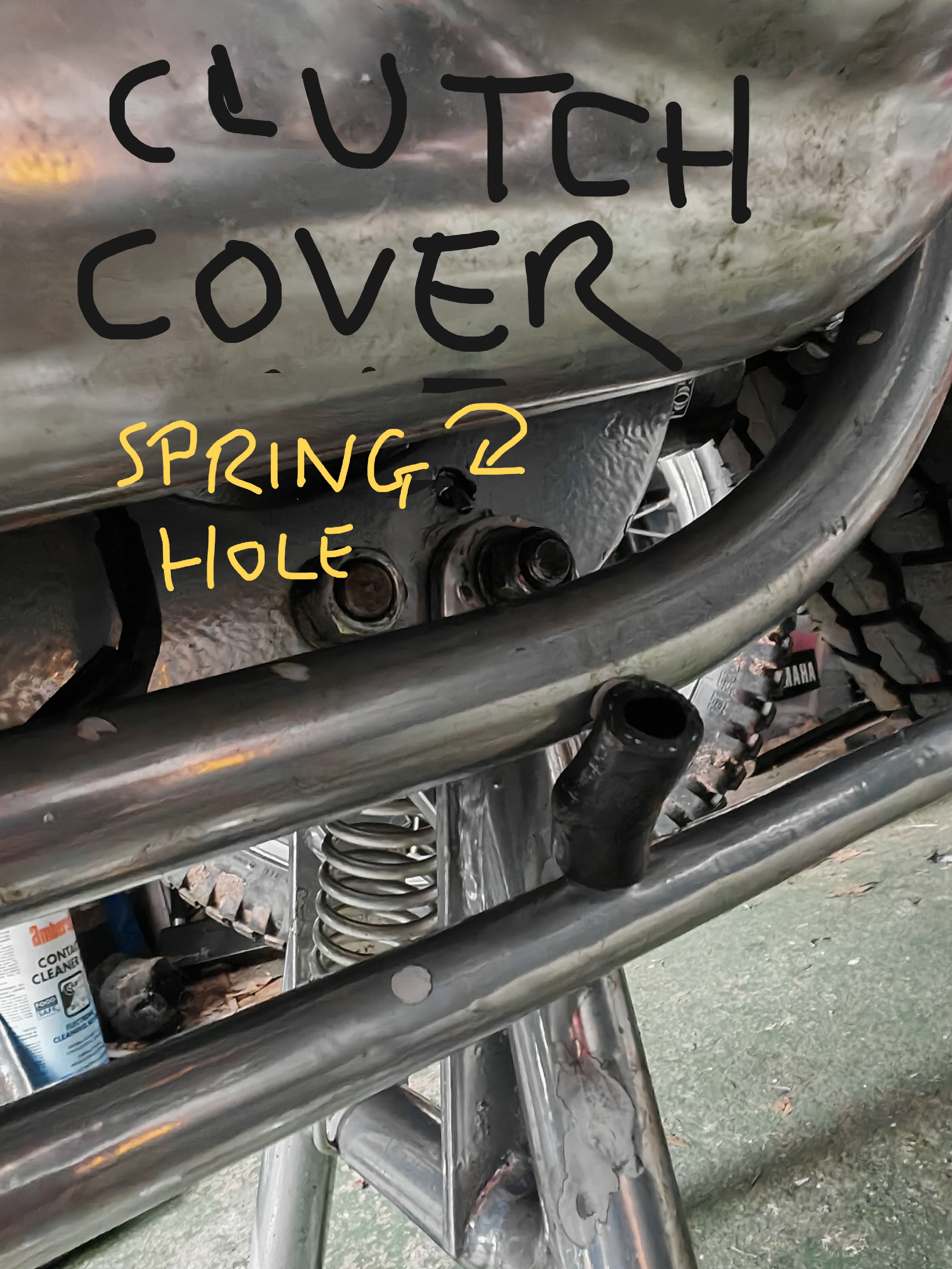

Just finishing mine off too…
Just finishing mine off too and it has both stands. See pics for spring anchor holes
It's not the SS that's…
It's not the SS that's different, it's the year. Early Commandos had the centre stand mounted to the lower frame cross-member which was below the gearbox. Later frames mounted the centre stand on the engine plates and moved the frame cross-member forwards. Change over happened around 1970.

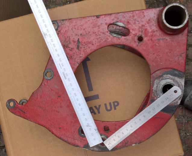

850 MkII rear engine plates
This shows the position of the centre stand pivot holes on an '74 850. The measurements are 235mm and 152mm c-c.
Thanks Stan, at least I can…
Thanks Stan, at least I can see how viable it is to drill my plates.
