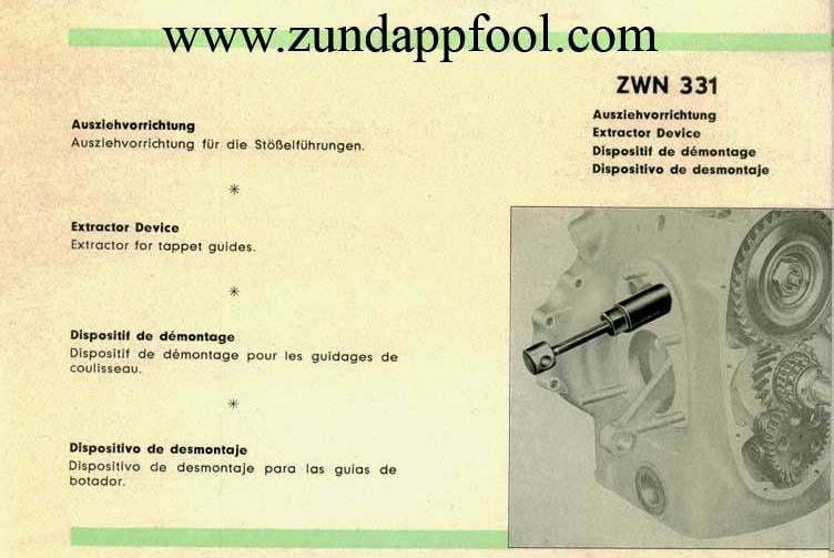

I think that the socket extractor tool will look like the tool in the attachment.
A threaded rod is inserted through the socket and then through the guide. A head is screwed onto the end of the threaded rod that is sticking up past the end of the guide.
As the threaded rod is turned in, the head is pulled against the guide and pulls it into the socket.
The photo is from an old Zundapp instruction book but it is the only photo I could find on the web. I think that you will get the idea.

Not sure how this site works as i can't seem to get a reply posted on site ! The type of puller described will not work on a 52 type motor as you need to get the guide out to enable removal of the tappit/valve lifter, so you cannot put a rod through the guide to remove itas described ! Help !!!
Bob
Bob, a sprocket extractor is a small two leg puller. Use a small two or three leg puller in the rebate on the guide pushing against the lifter, or use a slide hammer .Heat the case [within reason], and the guide will come out easily.Never extract or install anything in an alloy case without heating the case.I just use a pinch bar in the groove., and dont forget to install the lifter first. Regards , John.
