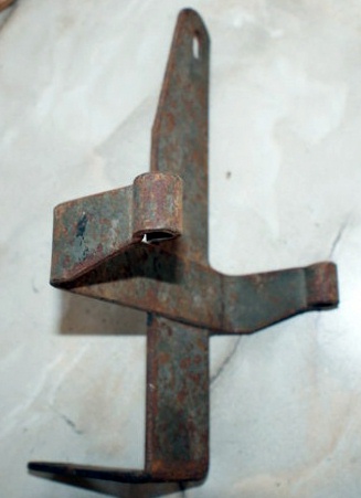

On my 38 ES2 I have a postwar battery carrier off a I don't know what and a replica Lucas box to hide my modern battery. I think it looks ok, however I would be more happy with the original type setup. Looking at pictures in books and the 1938 brochure it seems they were fitted with those T looking batteries of which you can get dummy replicas. What does the actual carrier look like though and how is battery attached ? There doesn't seem to be an outside band holding the battery. I have an excellent copy of a 1938 parts list and I have looked and looked but there doesn't seem to be a carrier listed or pictured.

Hello Glenn,
Ihave attached an image of the correct carrier for your 38 ES2, the carrier is secured to the chassis via the earth post stud and bolt and the twobottom studs that also secure the oil tank to the chassis. In addition the original bakelite battery had through bolts/studs cast into the body of the battery, the batterysimply sat on the arms of the carrier, with the two through bolts/studssecured by two nuts, hope this helps.
Best Regards,Karl.
