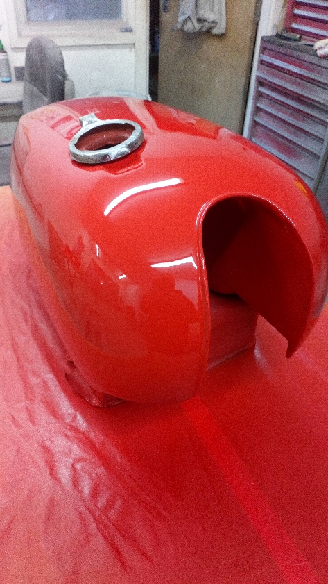

I am at the point of adding decals to my new tank and refurbished side panels. I looked around to try figure out if measurements exist for the correct location for a ‘72 Commando Roadster 750.  I have several photos of other roadsters and many look different and also it’s difficult to know what is most original.  Can anyone help me?
Note: when I got the bike the side panels had no decals due to damage and the bike had a fibre glass tank and I now have a steel one.
