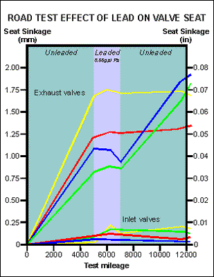

The introduction of unleaded petrol onto the market has d the fact that some engines do not take kindly to it, and suffer severe valve problems when deprived of the 'lubricating effect' of TEL. The graph of Figure 1 shows the result of a road trial on one 4-cylinder engine, firstly on unleaded, then temporarily on leaded, and returning to unleaded. Over 5000 miles the exhaust valve seat wear was horrific. The 30-70 thou. wear measured would exceed normal valve clearances, and once a valve is propped open it rapidly overheats and burns, leading to catastrophic failure. Note that leaded petrol stopped the wear, and continued to do so for 2 of the cylinders after the return to unleaded, but the other 2 quickly started wearing. This demonstrates the difficulties of getting definitive results, the variability of the phenomenon with very minor variations in the installation, and the ongoing protection which can occur for a time after using leaded fuel. |
The wear is caused by iron-oxide particles, formed by the friction and heat at the exhaust valve, grinding between the valve and seat. Wear rates then become a function of valve loading, relative motion on opening and closing, hardness, and speed. In general the phenomenon has not afflicted low speed engines (e.g. 2500-3000 r.p.m.) even at high load and throttle settings, but at 3500-4000 r.p.m., engine speed seat wear rates start to increase dramaticallv, almost irrespective of throttle and load. Considerable study of the problem, and a variety of possible solutions. has been made over the years, although not always widely publicised, and were intensified around 1970 by the industry in order to cope with the unleaded fuels being demanded by the environmental lobby.
Octane rating is a minor issue in the debate. In recent years the highest octane ratings have disappeared completely as the expense, and high TEL loading required, have become insupportable, High performance engines thus have to face this problem whichever pump they may be filled from. The 'regular' grade of unleaded it is true, is slightly lower than that of the leaded fuels but the petrol companies have overcome this problem with a higher rated ‘super-unleaded’ grade. The lobby to reduce lead emissions may be to blame, but whether you run on leaded or unleaded you will have to detune those sports machines made in the heady days of 5-star 100 octane. If your vehicle dates back to the 50s, or earlier, then all modern grades exceed the octane it was made for and you have no octane problem at all.

The use of separate material for the valve seats has a long history, and is particularly associated with light alloy heads which do not provide a suitable base material and therefore leave little alternative. However the benefits of alternative seat materials for reducing serious wear problems has been long known. As hinted earlier in this article valve seat problems were not unknown in the vintage era, especially in the USA where the roads were opening up and there was less practical or legal inhibition to running engines fairly fast and long.
Papers by Getzoff (Prevention of valve seat erosion, Transactions of the S.A.E., Vol.25) and by Colwell (Recent developments in poppet valves, Transactions of the S.A.E., Vol.26) in 1930 both outlined the classic symptoms, and similar conclusions to those arrived at by the 1970 researchers. Colwell far-sightedly stated that the use of TEL would prove to be a solution by providing lubrication, whilst Getzoff recommended the use of alternative seat materials such as aluminium bronze or Mackalloy (a hard tungsten steel). A number of American manufacturers of heavy-duty engines adopted the practice of using seat inserts for long life and hard wearing properties, as did Rolls-Royce in the UK. One problem at the time was the method of retention of the seats, and pre-war motorcycle manufacturers seeking to make light alloy heads tried cast-in individual seats, cast-in 'spectacles' (single bronze inserts encompassing two valve seats and spark-plug hole), screw-threaded retention, and simple parallel shrink-fitting. The simple shrink-fit proved to be the best (as recorded by the late Phil Irving in Motorcycle Engineering). |
Laboratory and road test experiments have confirmed that hard valve-seats can provide a high degree of protection against valve seat recession when running on unleaded fuel. The properties required are hardness and corrosion resistance, and the recommended modern materials are sintered chromium-iron alloys. BRICO materials XW23 and XW35 include an additional copper content, believed to both provide some intrinsic 'lubrication' effect, and improving the heat conductivity which helps offset the additional heat barrier which an insert shrink-fit joint presents to the escape of exhaust heat.
Manufacturers of course are not enthusiastic about the increased cost of machining and stocking required by separate exhaust valve seat inserts. Researchers have therefore also studied other alternative ways of enhancing seat performance. A very similar result is in fact possible, by localised treatment of an iron head casting by induction hardening - a sort of case hardening treatment where the heat is provided electrically from an induction coil. It is thus not safe to look at a modern engine, see no apparent seat insert provisions, and conclude that because they manage then your old iron head will have no problem. A modern one-piece casting, can in fact have properties as complex as a fabrication of selected materials! The majority of research has been directed to car and truck engines fitted with iron heads. Belcher and Forrester, however, included aluminium heads in their tests (Some factors affecting exhaust valve seat sinkage in gasoline engines, Associated Octel report OP73/2 1973). Noting that such heads automatically demand inserts of some 'hard' material, they found seat sinkage to be low even with unleaded fuels. |
Recommendations resulting from the above research should be directly applicable to iron-headed motorcycles, but application to air-cooled alloy head machines should be a little more cautious. The poorer temperature control makes the exhaust valve operating conditions more arduous and variable than in the water cooled engine, and the wear rates will depend critically on the original choice of seat material adopted by the manufacturer. This choice will have been taken with the usual regard for cost cutting, but also with regard to the need to match the expansion rate of aluminium in order to adequately retain the seat at temperature. Normal cast iron head insert materials do not always stay tight in air-cooled light alloy heads, and manufacturers had a more limited choice of materials such as high expansion cast iron or wrought aluminium-bronze. The same care is required when choosing from the new hard seat materials - a dropped valve seat ring is likely to make a serious mess.
