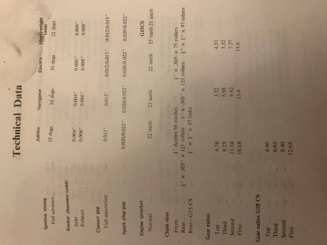

As I revel in the eclectic joys of Electra ownership I have just noticed a discrepency between the technical information for rocker / tappet clearance between my usually trustworthy 'Norton Twin Cylinder Rebuild Manual'  (photo attached) and my recently received original Norton Electra Owners manual and provisional parts list (second photo attached).   The rebuild manual quotes Electra clearance as 6 thou inlet and 8 thou exhaust where as the original Electra Owner's manual which would have come with the bike quotes 4 thou inlet and 6 thou exhaust - the same as the Jubilee and Navigator.   Before I adjust them can experienced owners confirm that 4 thou and 6 thou are the correct settings?

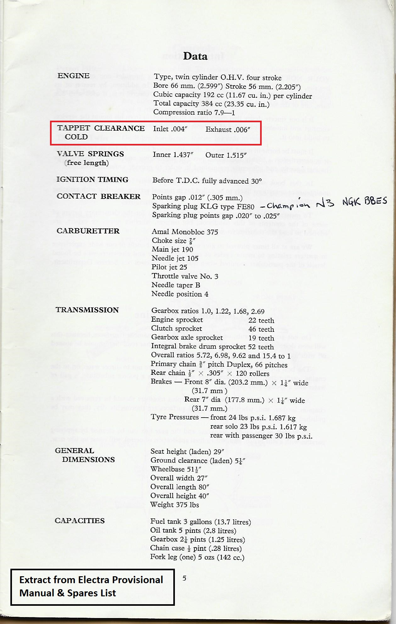

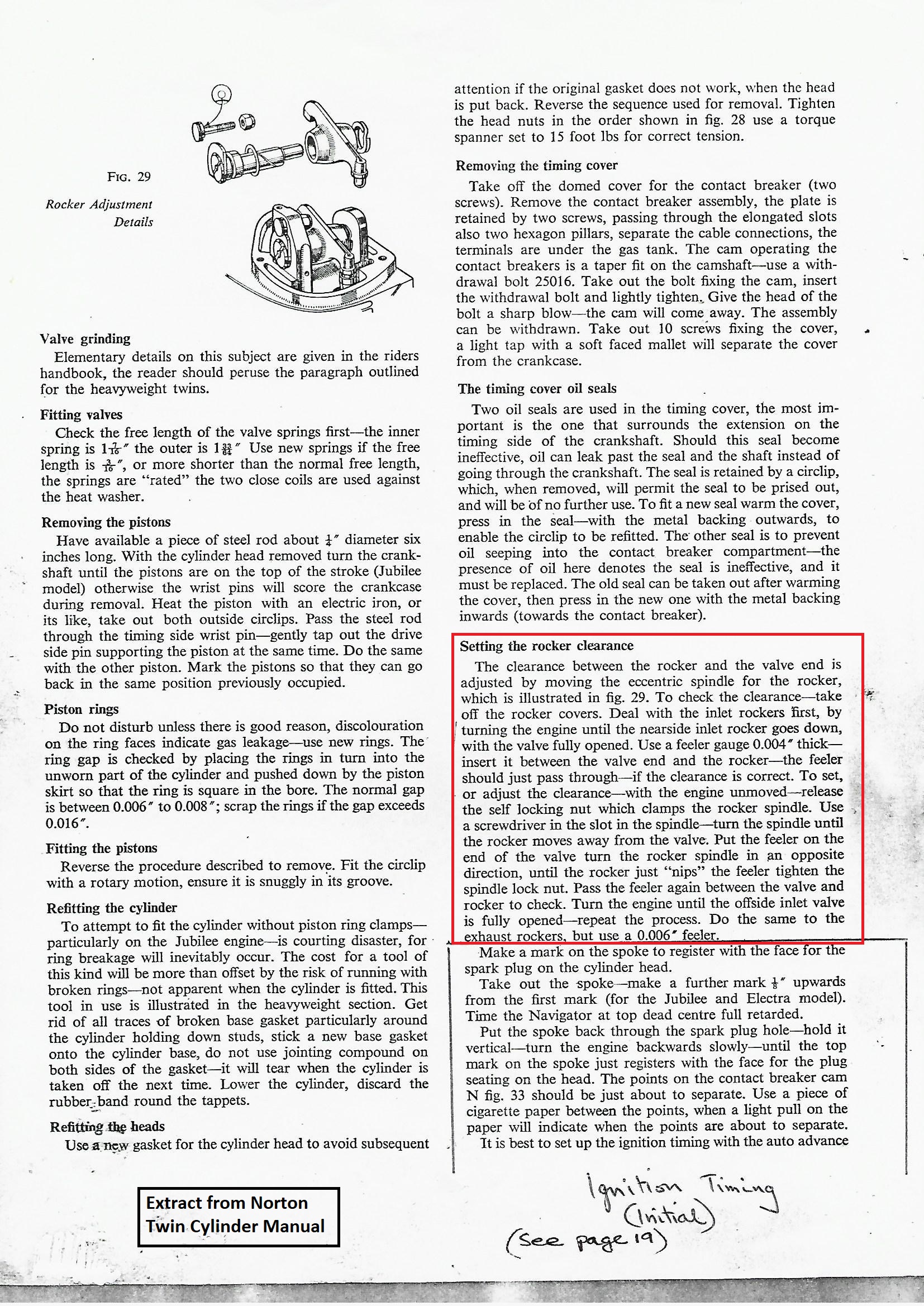

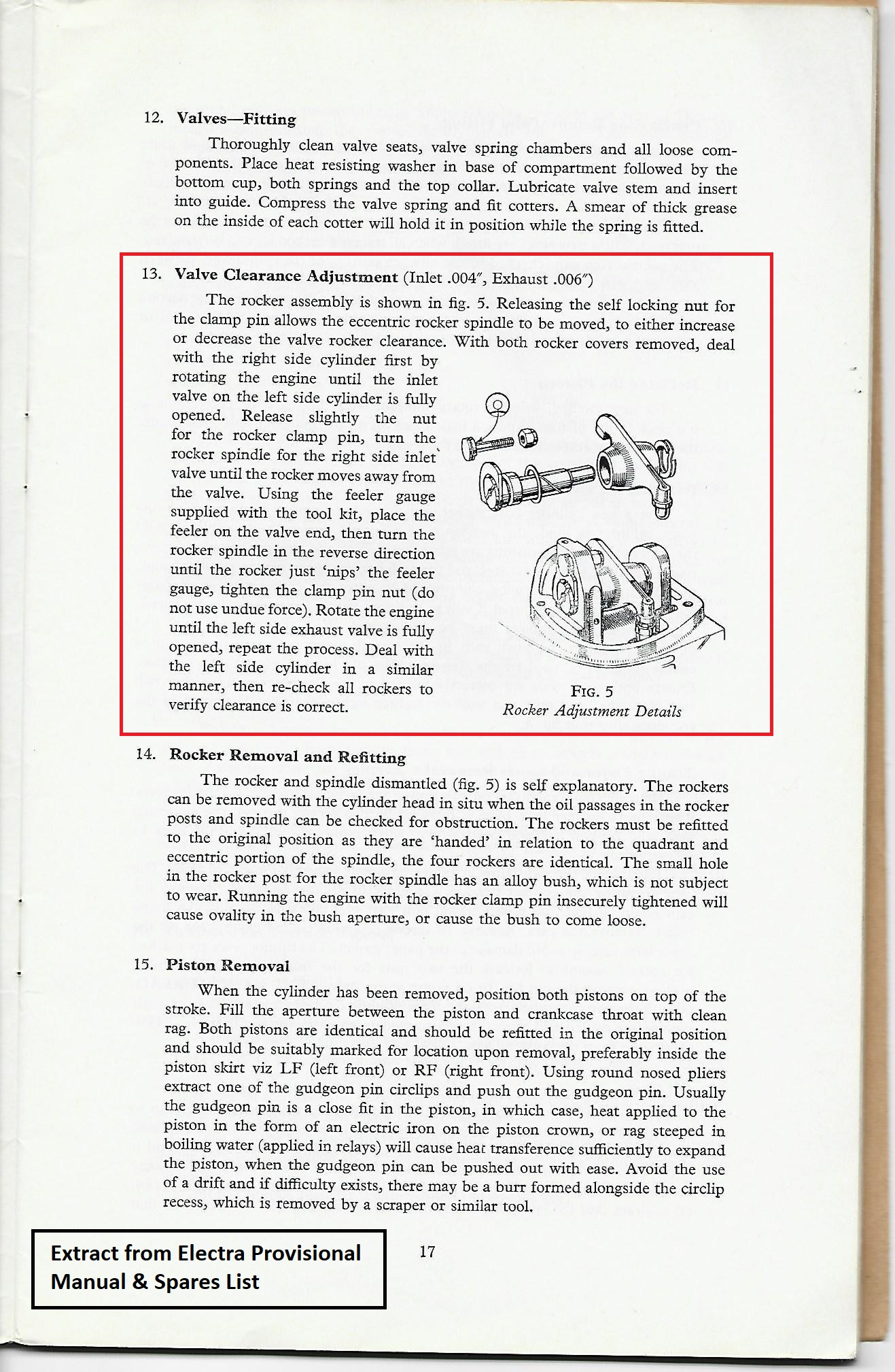

Tappet clearances for ALL Lightweights are: Inlet = 4thou; Exhaust = 6thou
I have heard of running them tighter for racing, 2 & 4 thou, BUT I have NOT seen any other figure quoted - both the Twin Cylinder Manual & the Provisional Manual & Spares List state the above figures.
See attached (1) Extract from the Twins Manual, and (2) pages from the Electra Provisional Manual & Spares list.

Thanks for confirming this - I was led astray by my normally reliable 'Veloce Press' reprint of the Norton 'Twin Cylinder Manual' which eroneously shows the Electra's Inlet clearance as 0.006" and the exhaust as 0.008" - the same as the Heavyweight twins.  I was in a rush when I was setting them and noticed they were different from the Jubilee and Navigator and should have looked a little further - had I done so I would have noticed that they have also miss quoted the Navigator exhaust clearance as 0.066".  Now that would be noisy!!!    Lesson learnt to always double check when you notice something out of the norm.
