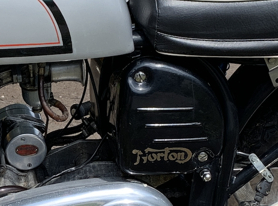

Hi, i need a battery for my late father's bike, but i don't know what battery fits. It is for a 12volt system on a 1966 dominator 650ss
It needs to fit in attached battery box.
Thanks in advance.
