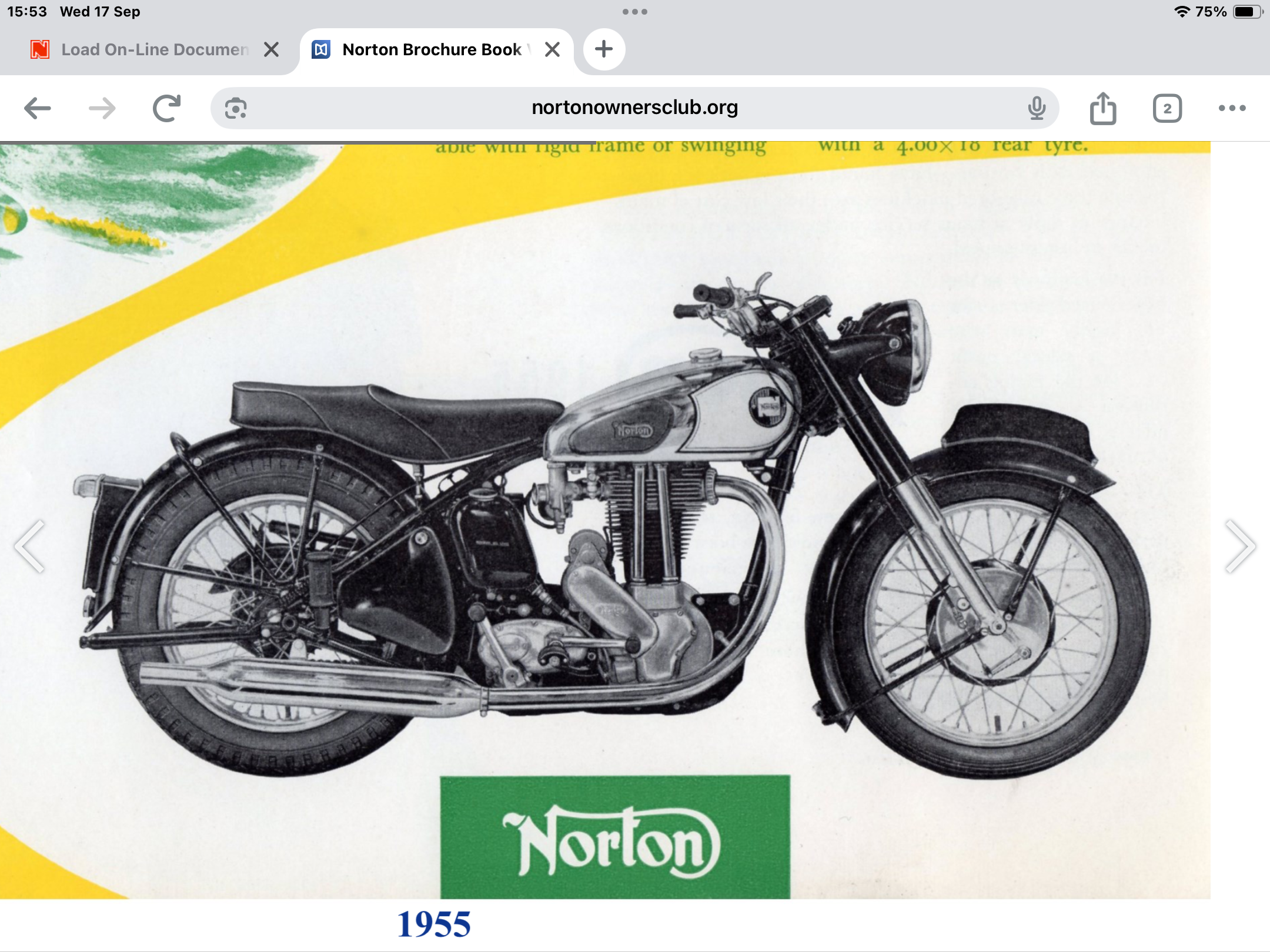

...I attach screenshot of the 1955 sales brochure which can be found in the tab Library/Brochures book. Download then click on the three bars to select your year.
You will also find spares lists related to your machine (only a few of the items are illustrated) which will give you the right part number to give the manufacturer the type you are looking for.

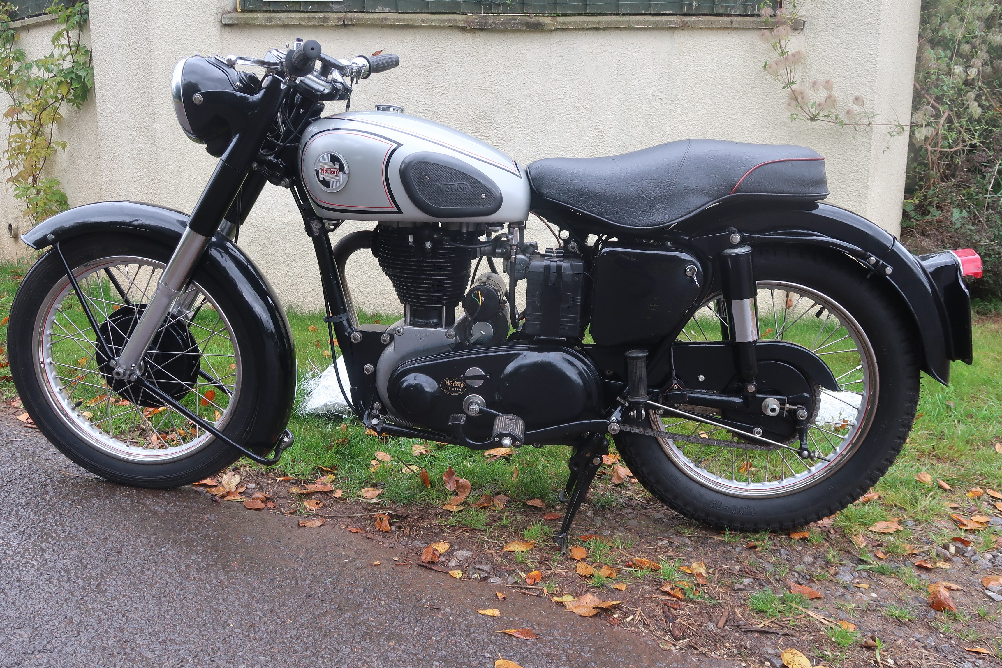

I'm in Redditch if that's any help. I don't have a single at the moment but sold my 1952 ES2 last year - obviously this was a plunger model and your 19S will be swinging arm. I had a friend in the 1970s who had a bike like yours and it performed well.

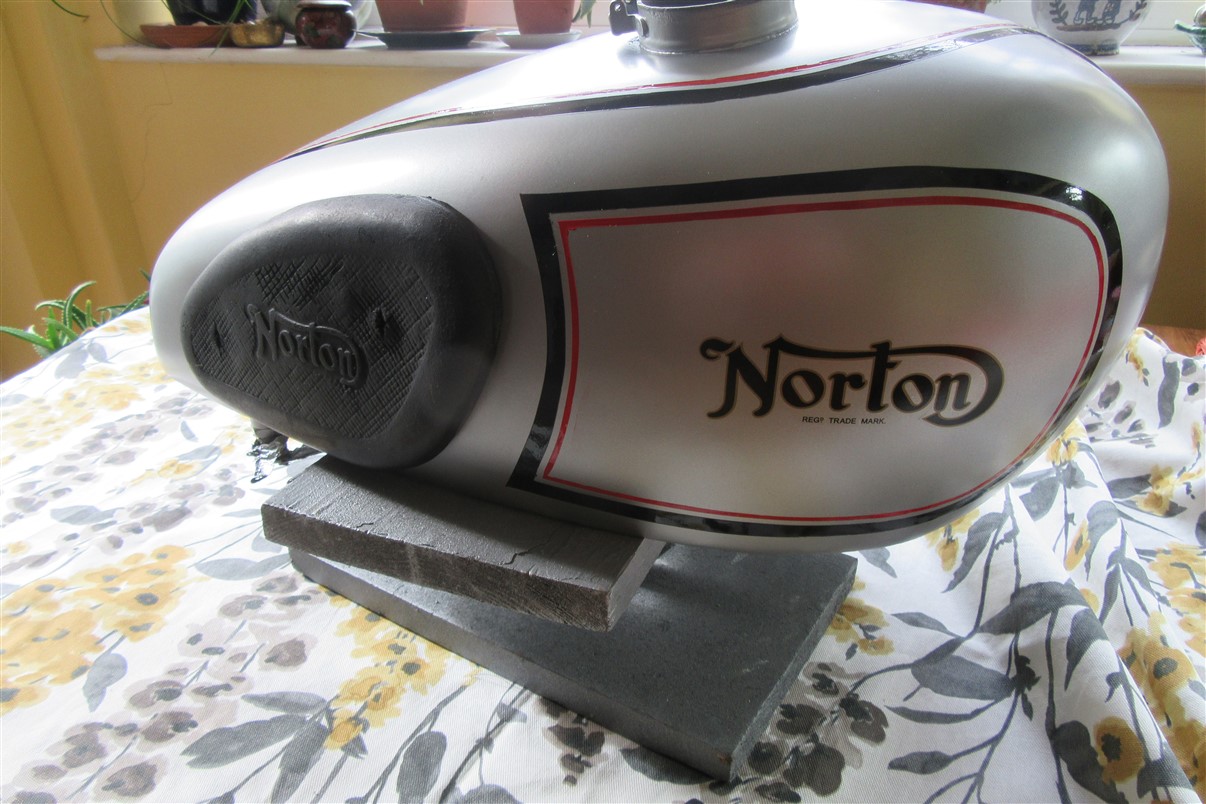

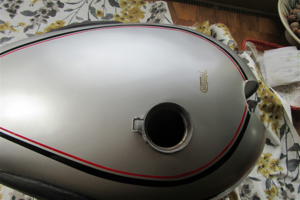

As for tank details, I did my own and they're in my signature pic - below is a better picture of the tank. I think they did vary and a lot of people will nitpick. I didn't have mine chromed as (a) it's prohibitively expensive and (b) the shortage of nickel in the early 1950s meant that some tanks weren't chromed.
I did quite a lot of research before I painted mine. It's worth popping over to the National Motorcycle Museum but beware - some of their bikes aren't completely original if that's what you're after.
tank top
tank left

I still have my 1955 ES2 and have stabled it since 1970.  I can take photos of my refurbished tank to show the detail on the top of the tank, below the headstock.  This is different to Ian's picture above and only matters if you want it as original as possible.
